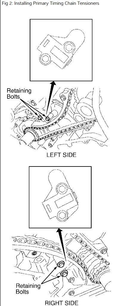

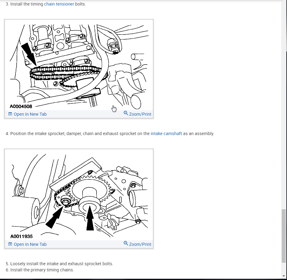

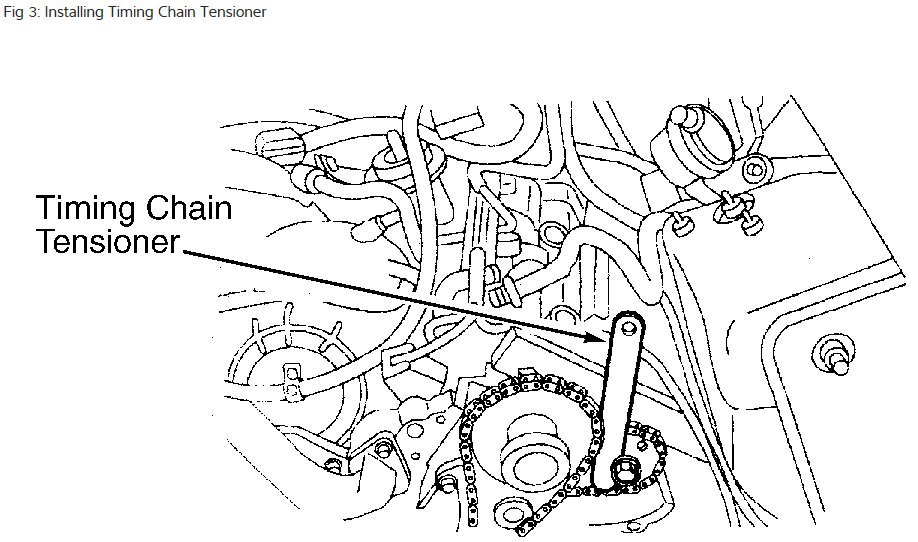

So secondary timing chain and tensioner broke on passenger side motor. how do I fix this? can I just turn exhaust cam clock wise until it matches other cam then put chain an tensioner on? Let me know.
Nov 27, 2019 at 7:36 PM

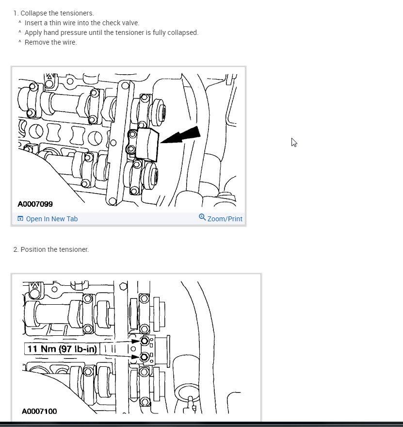

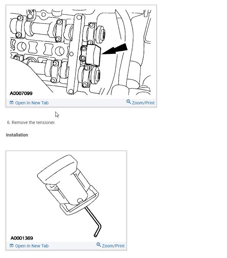

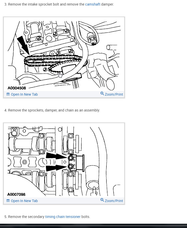

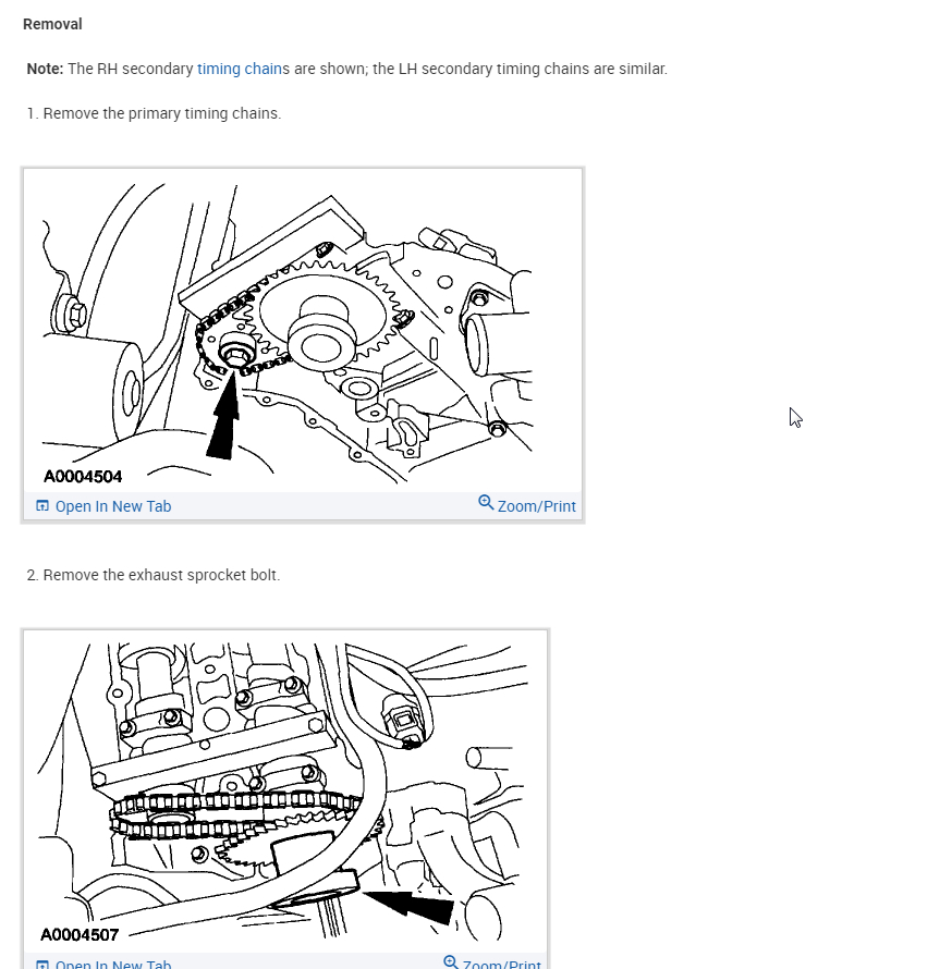

Here is the process for installing the secondary timing chain. Check out the diagrams (Below). Please let us know if you need anything else to get the problem fixed. Let me know if you have questions.
Nov 28, 2019 at 6:13 AM

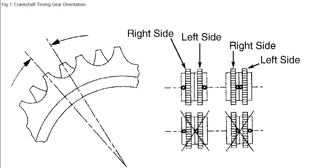

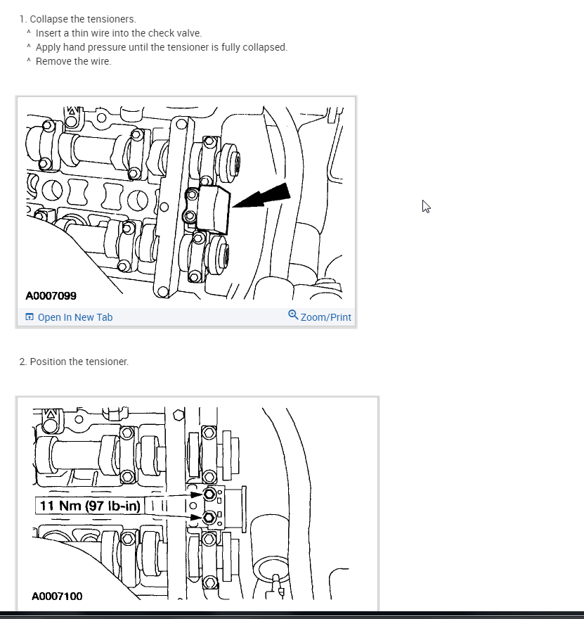

Prior to installing a new timing chain on your 3.9L motor you will need to reset the timing chain tensioners. By inserting a paper clip or thin wire into the tensioners check valve you can squeeze the tensioner until fully collapsed then remove wire.
Here are the diagrams for the timing marks. Following an online repair manual like Mitchell1 is recommend for replacing the timing chains, you can find one here https://www.2carpros.com/manuals.php

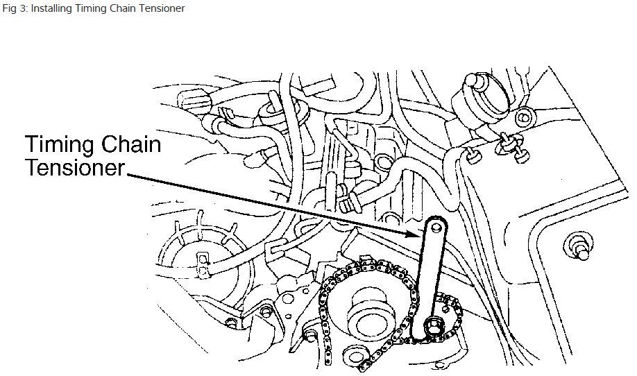

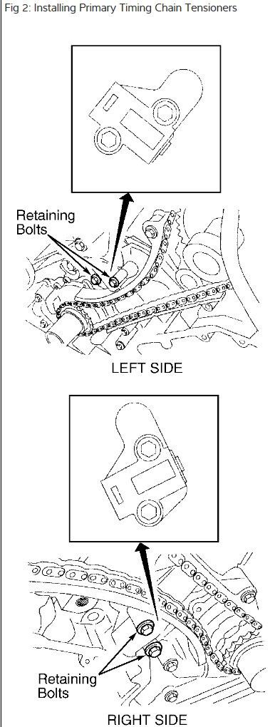

My secondary timing chain broke on the passenger side. And I need to replace it. The diagram you have is for the v6 model. My vehicle has 4 chains which is a v8. Two on each side of the car. Can you post a diagram for the timing setting on the 2000 Lincoln LS 3.9 v8.
