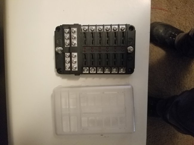

Here is a picture of the fuse box I'll be mounting in the engine bay somewhere:

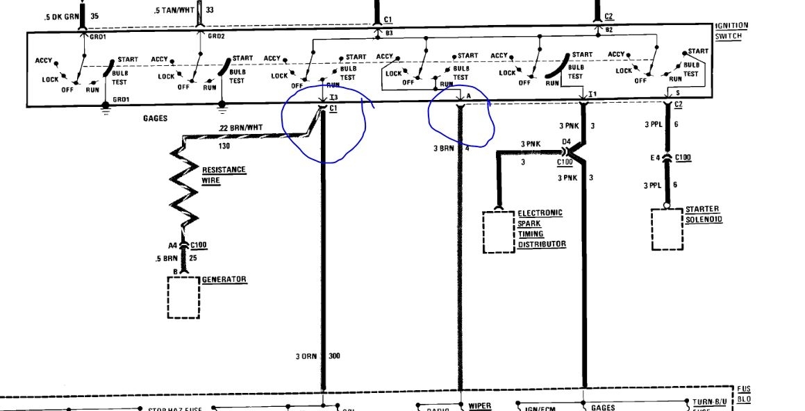

You will need to take a feed off the ignition switch to the fuse block. I would use a 10 gauge wire as a feed and install a 40 amp fuse for that line alone.
Okay, I attached a diagram for you of the ignition switch. Either the brown or orange wire should only have power with the key on.
