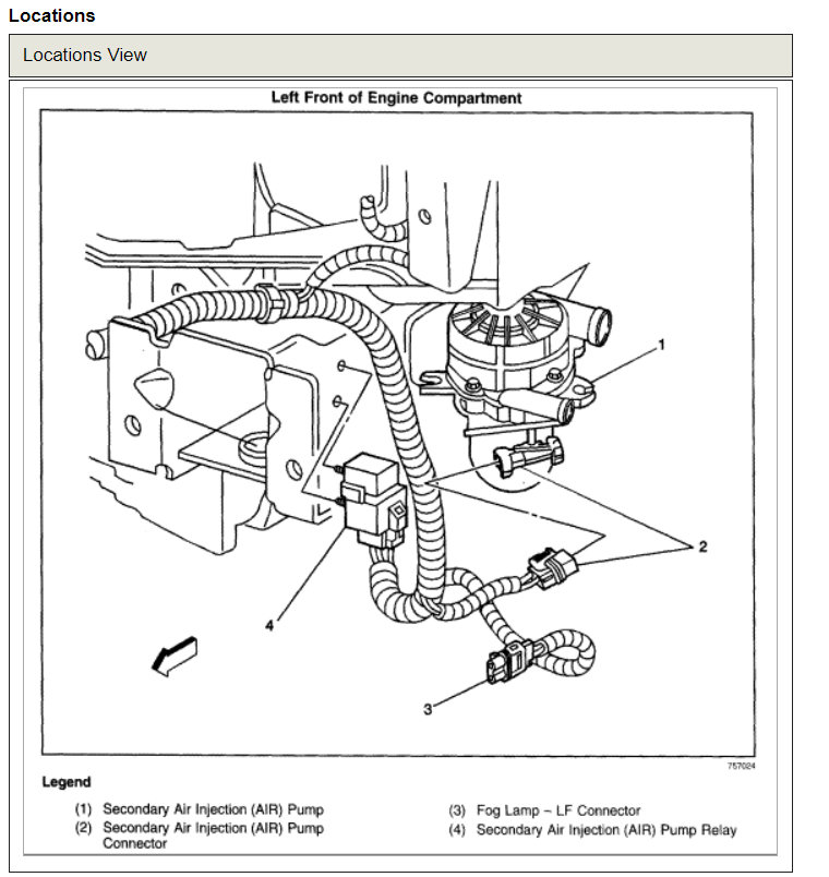

I need to know where the air injection relay is please.
May 10, 2016 at 1:38 PM
HMAC300
  • 48,601 POSTS
Secondary Air Injection (AIR) Pump Relay Left front of engine compartment, near air cleaner duct. There is no solenoid it may be part of assembly of pump. there is a check valve both are in pictures. Check out the diagrams (Below). Please let us know what happens.

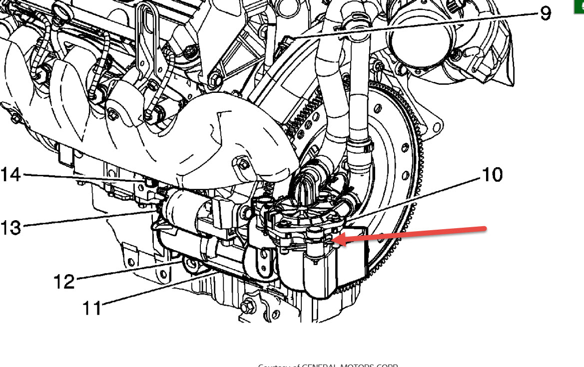

Hello, The air pump is located On left front frame rail, forward of fenderwell. https://www.2carpros.com/images/external/117396613.gif Check out the diagrams (Below). Please let us know if you need anything else to get the problem fixed. Cheers
Jun 25, 2019 at 4:29 PM (Merged)

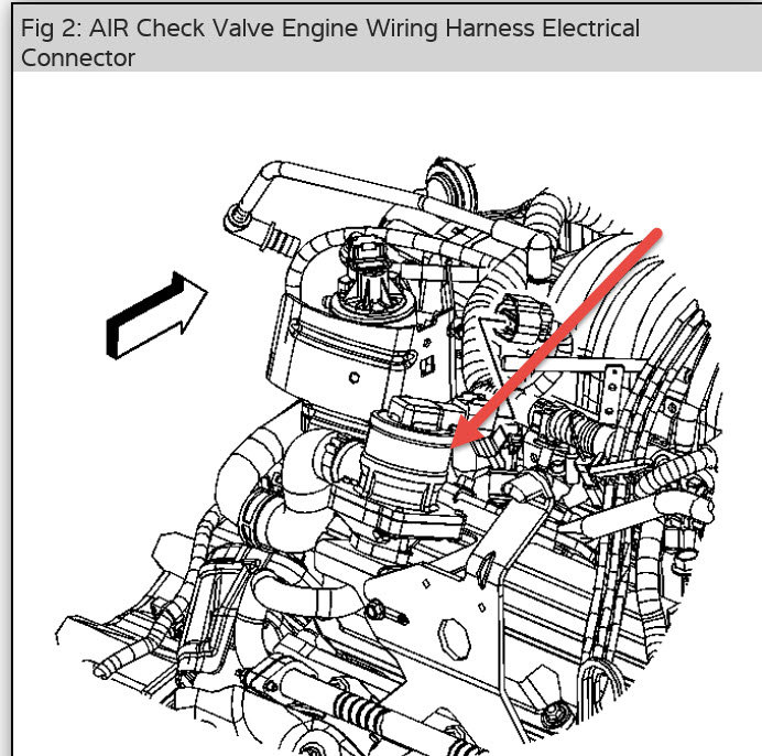

It doesn't have a traditional air pump. It has a Secondary Air Injection Reaction Pump & Solenoid.
I have attached a picture.

GM still uses air pumps. They are just electric now.

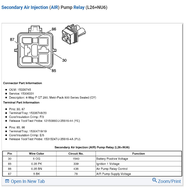

My 01 grand prix gt has the ses light on and is throwing a code P0410 secondary air injection system, which means water in the air pump. problem is i cannot find the air pump on my car! i was told it was on the drivers side under the airbox, but the part has a pulley on it, and the only belts i see are on the passenger side. so where is my air pump?

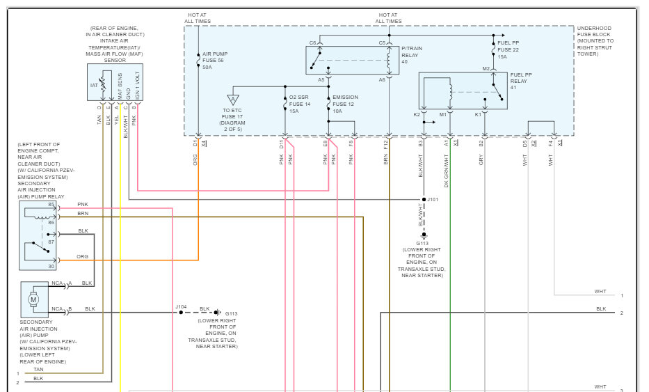

This air pump is electric. That may be why they said it's on the lower left driver's side of the car. Check to see if you have a relay or fuse that is blown as this may be your problem as well.
Here is a guide to help you test for power and how to test the relay
and
Please run this test and get back to us.

DIAGNOSTIC AIDS
An intermittent may be caused by any of the following conditions:
Low system airflow
Excessive exhaust system back-pressure
Pinched, restricted, split, or damaged pipes/hoses
Restrictions in the AIR pump inlet hose
Pitted contacts in the AIR pump relay, AIR valve relay-Tap on the AIR pump relay or AIR valve relay to attempt to duplicate an intermittent condition.
Yellow tinted water in the AIR pump may indicate a control/shut-off valve failure.
Water or debris ingested into the AIR pump
Observe the Freeze Frame/Failure Records to aid in conditions of setting DTC P0411.
Thoroughly inspect any circuits that are suspected of causing the intermittent condition. Refer to Testing for Intermittent Conditions and Poor Connections. See: Powertrain Management\Computers and Control Systems\Testing and Inspection\Initial Inspection and Diagnostic Overview\Diagnostic Strategies
