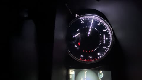

I will have to check for a vacuum leak tomorrow but here is a video of it.

Got it. That is 100% normal. That is the PCM slowing the RPM down so that it doesn't free fall to a lower RPM and potentially stall the engine.
Think of it like someone who is skydiving and they release their parachute. They are dropping rapidly and the parachute comes out and it dramatically slows them down. Well the PCM doesn't want to have the engine decelerating to a low RPM at such a fast rate so it interrupts the deceleration so it can then slowly drops the last 600 or so RPM to proper idle.
In other words, it is the PCM's way of gaining control of the RPM again. When you let the RPM drop like that, the PCM is actually cutting the pulse width to the injectors so there is no fuel and the RPM fall. If it doesn't slow the deceleration then the engine will stall because it has no fuel. So the PCM is bringing the injectors back in and it slows the deceleration and then levels out.
Hope that makes sense. Thanks for the video!
