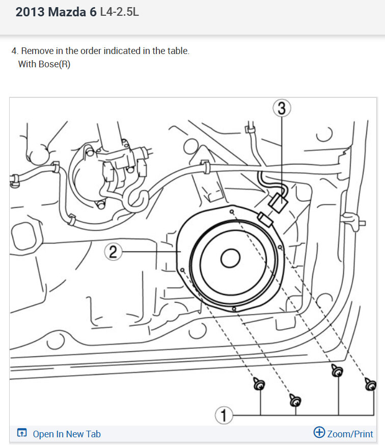

Left Speaker Issue: The left speaker makes a weird, muffled rattling sound when the bass hits in songs, regardless of the volume. A friend suggested it could be a loose wire causing the rattling when driving or from the bass vibrations.
