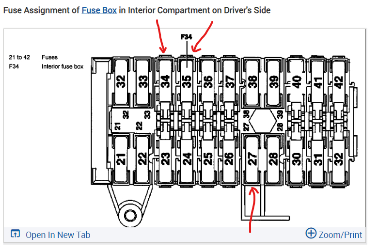

Please start a new thread for the wipers, it sounds like you may have a driver's seat position adjustment control module that is not working but it is run by two fuses, #27 or #29 and fuse # 34 in he fuse panel on the left side of the dash. This guide can help and I have included the fuse locations as well.
If the fuses are okay there is a ground for the module, T19 at the right doorsill please check that as well. Check out the images (below). Let us know how it goes
