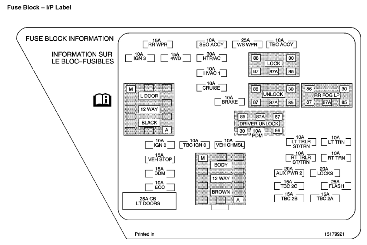

Both driver and passenger power seats stopped working. heated seats don't work either and I can't find the relay for the seats. I need some help.
Mar 23, 2021 at 12:22 PM

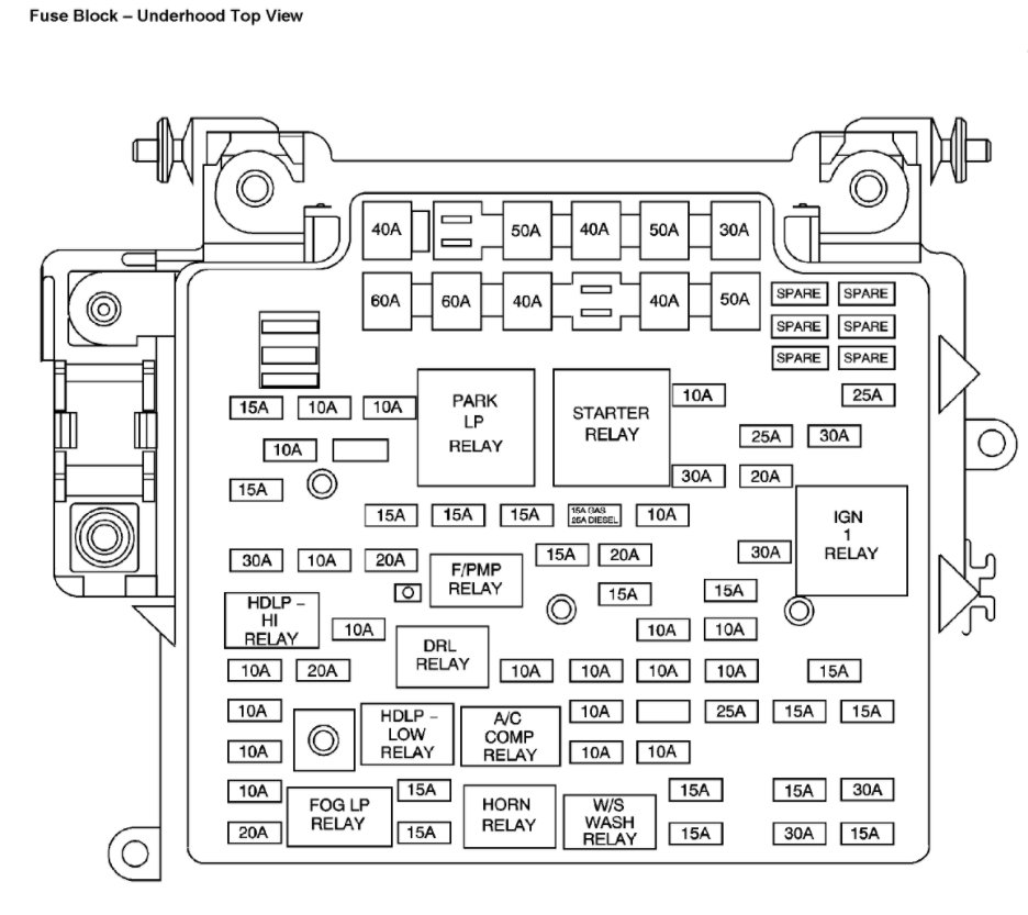

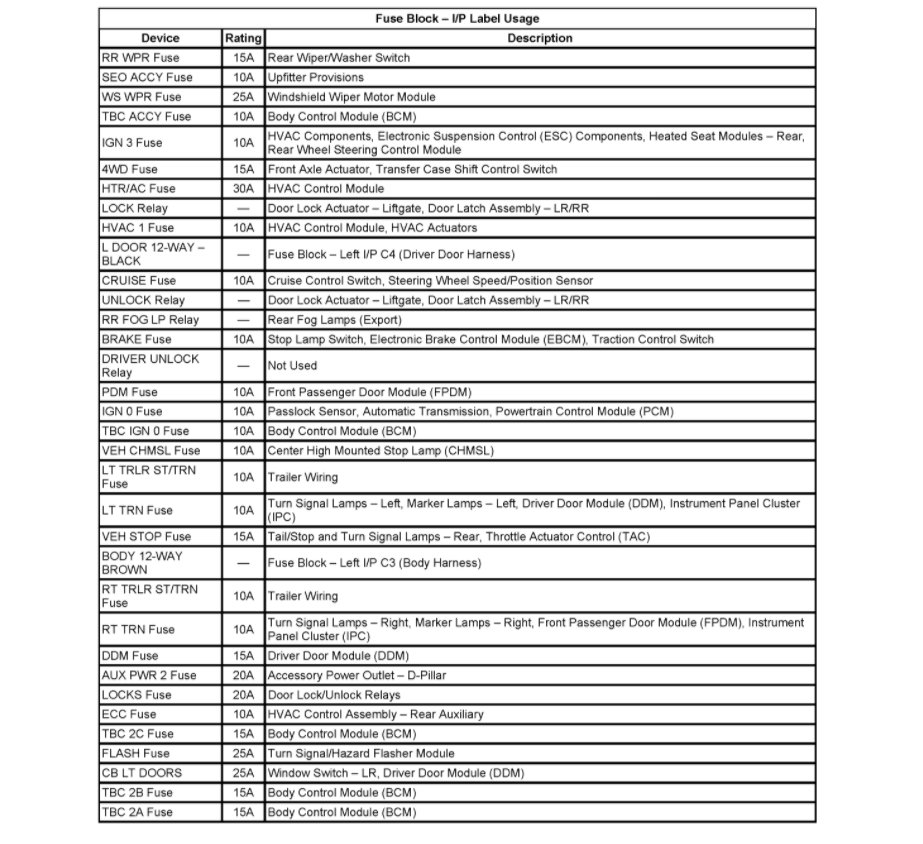

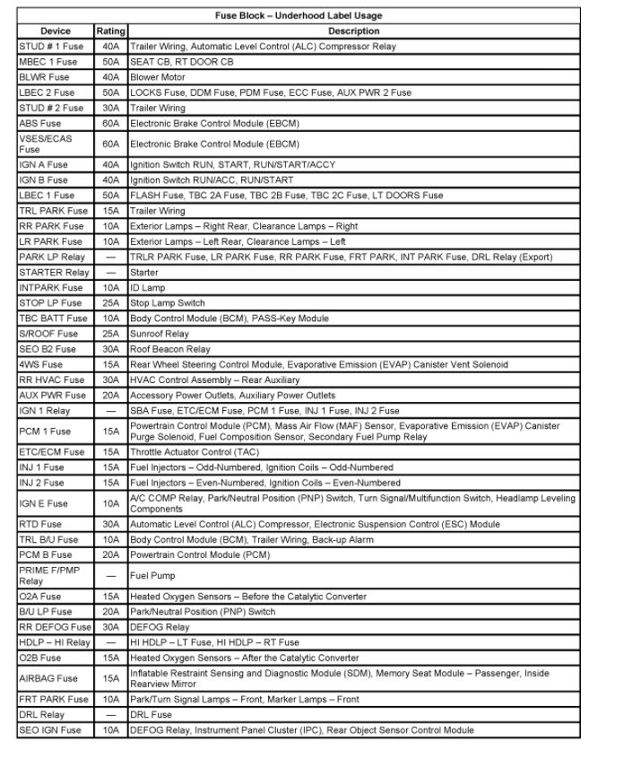

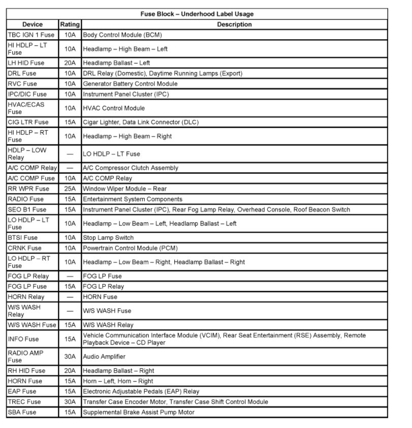

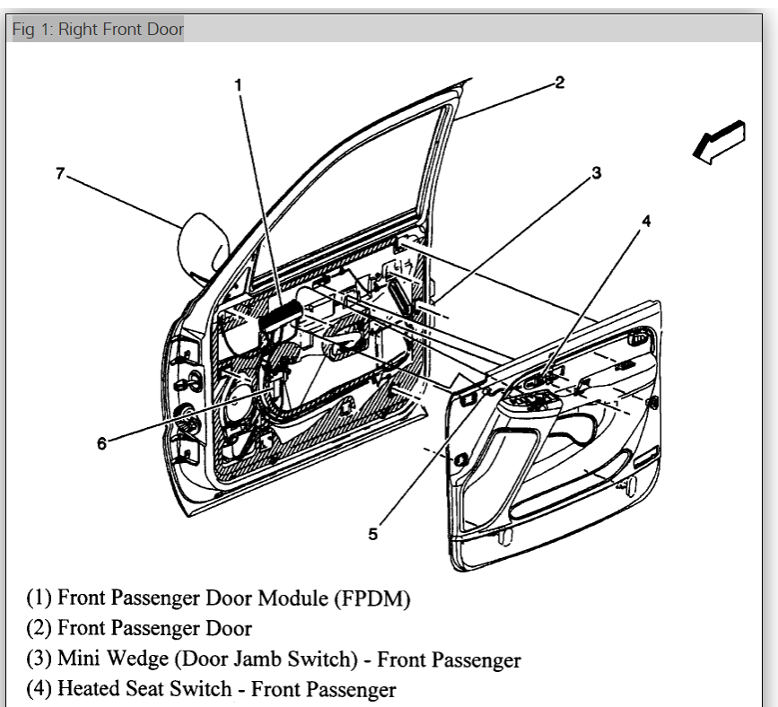

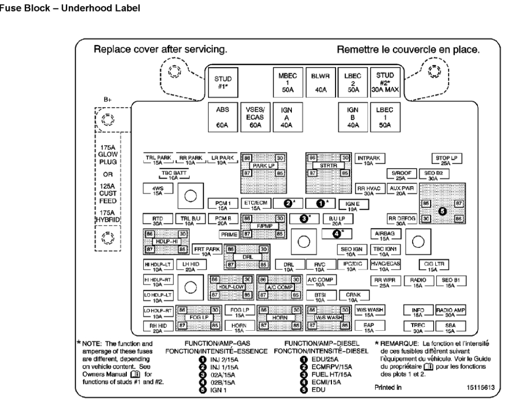

Lets start by checking all fuses. this guide will help with the fuse locations in the diagrams below. if all fuses are good chances are the passenger door module has gone out. I have included the instructions to replace it was well. Test the fuses with the key on.

Check out the diagrams (Below). Please let us know what happens.
