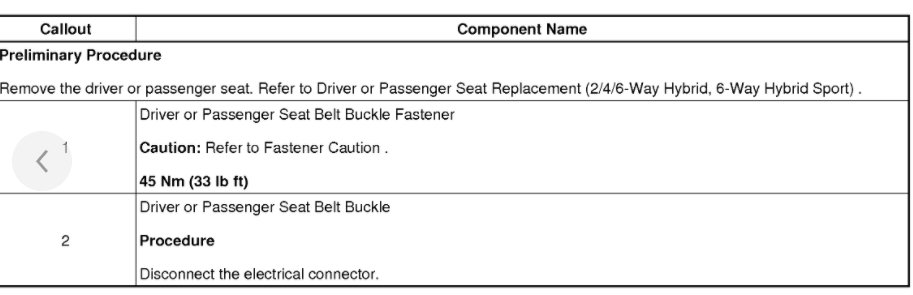

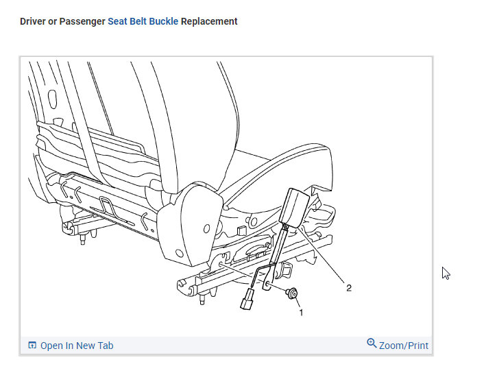

More then likely this is the sensor in the buckle that has failed. What happens when you click the belt into the buckle is there is a switch that gets flipped to tell the module that the belt is connected. When this sensor fails, the module doesn't know and assumes it is not buckled.
I attached the process below on how to change the buckle on a Buick Regal which is similar to your vehicle. Unfortunately we don't have a manual on your vehicle as it is not offered here in the USA.
https://www.2carpros.com/articles/how-a-safety-belt-works
Please review the material and let us know if you have questions. Thanks
