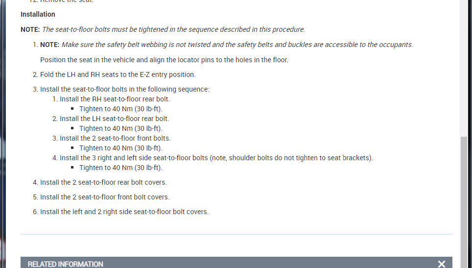

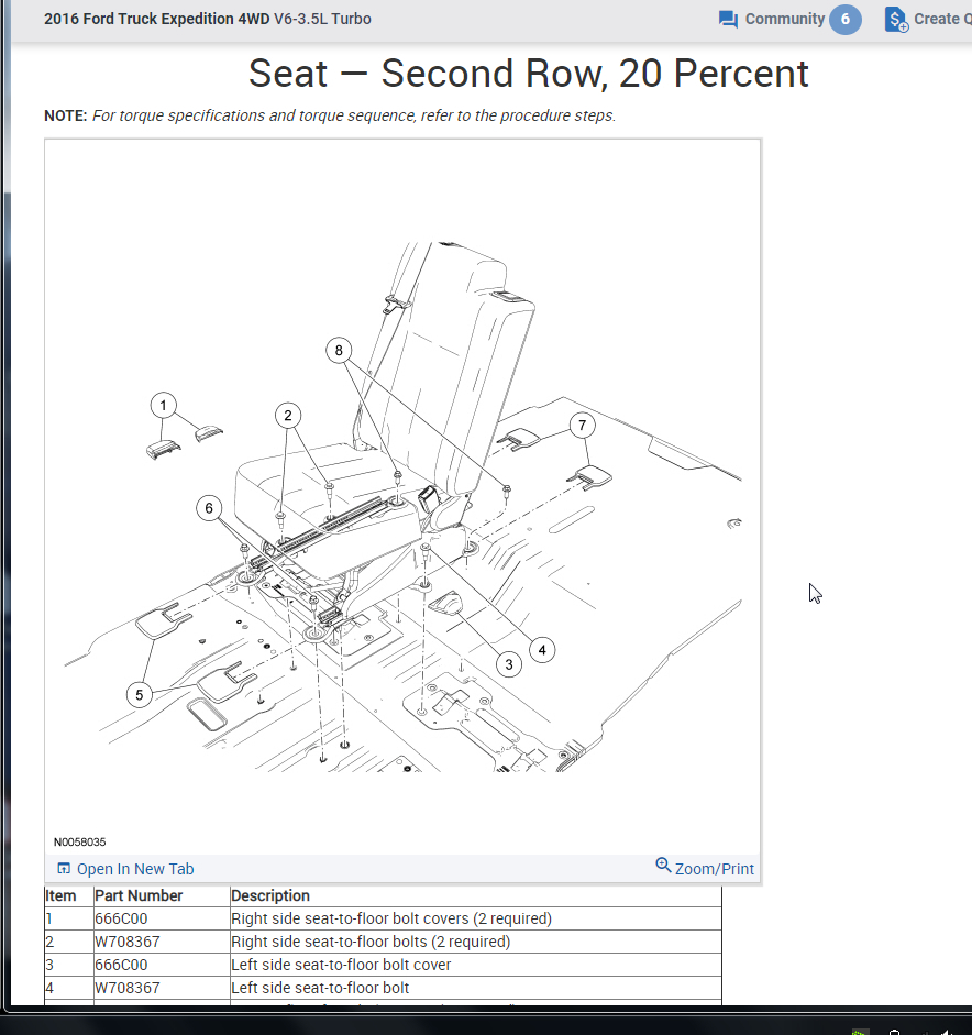

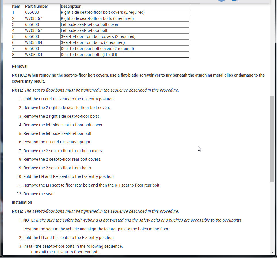

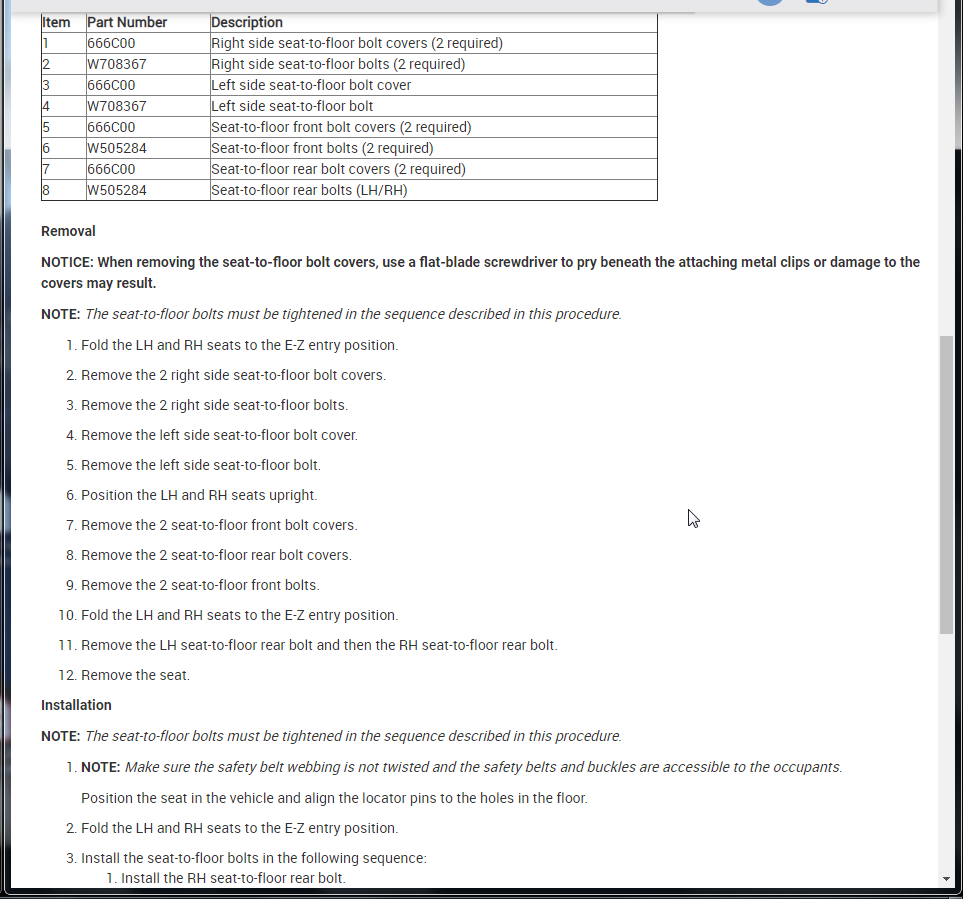

Worst case, you may have to remove the seat to be able to release these.
the process to remove it is below. Please take a look at this and let us know what you find. If this is not what the issue is can you get a video of what you are dealing with and then we will have a better idea what to do? Thanks
