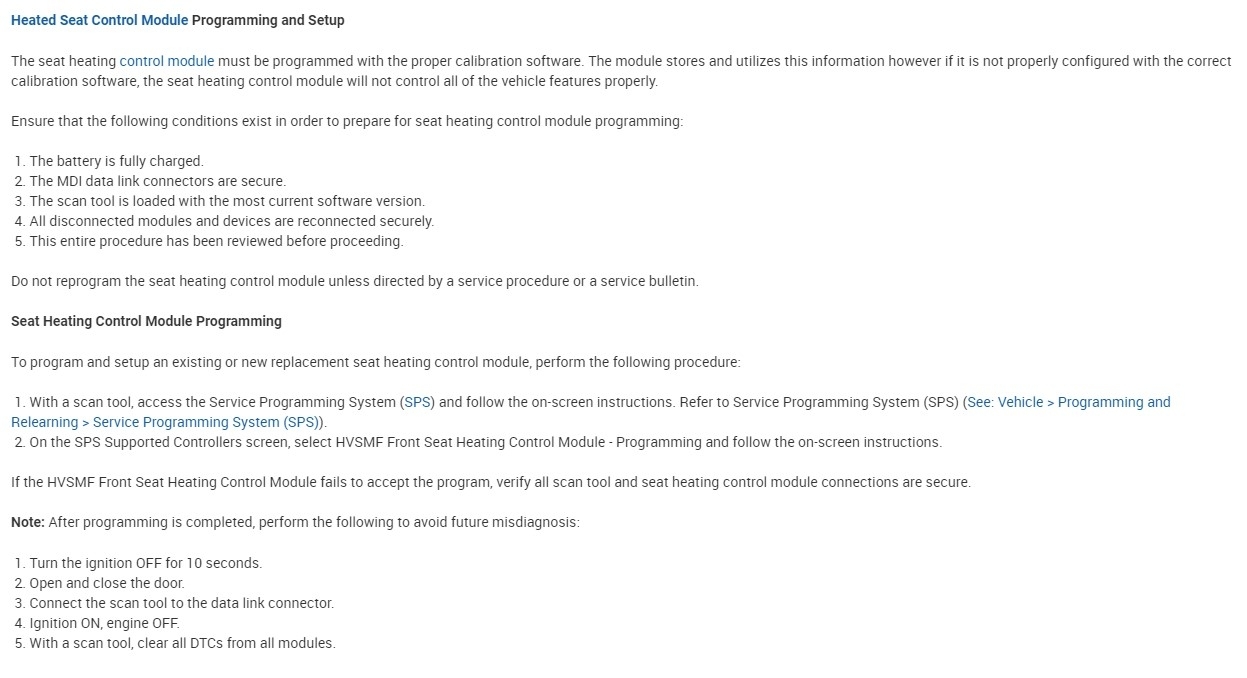

The driver's side seat heater was shutting off after 63 seconds. Read online it could be the module under the driver's seat. I replaced with a new OEM part and now both seats do not come on. I believe I need to have the BCM programmed to add the new part. Does that sound correct and what should it cost? Does it need to be done by a dealer or would most shops have the ability to do this?
