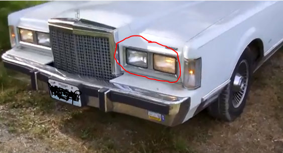

How do you take the headlight out to put another one in/
Oct 14, 2019 at 9:16 PM
DANNY L
  • 5,648 POSTS
Hello, I'm Danny.
You will only need a philips screwdriver. Use the screwdriver to remove the plastic trim piece surrounding the dual headlight assembly (circled in red) After removal you will have access to the headlight retainer ring. Use the screwdriver to remove the 4 screws. Using your fingers unplug harness from sealed beam headlamp. Picture attached below.Hope this helps and thanks for using 2CarPros.
