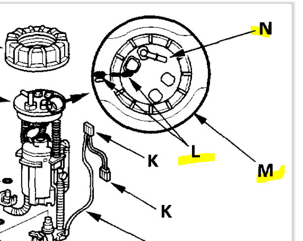

That little bit of difference shouldn't be the cause. Do you have the pump assembly positioned properly? When installing the fuel pump unit, align the marks (L) on the fuel tank (M) and the fuel tank unit (N). (See pic below)
Let me know if that helps.
See pic below.
