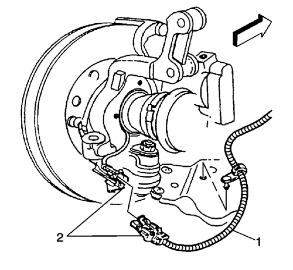

3. Disconnect the wheel speed sensor electrical connector (2), if equipped.
pic 2

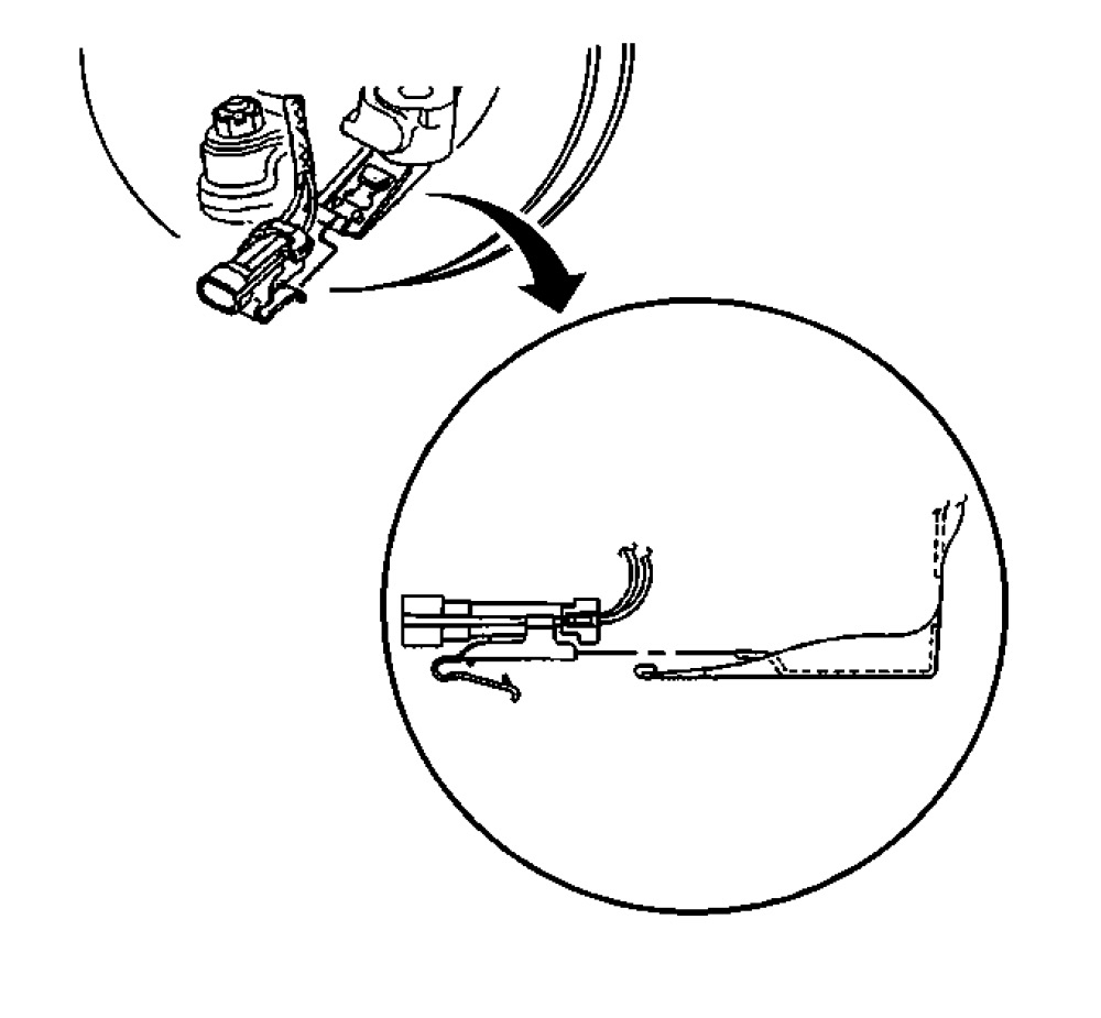

4. Remove the wheel speed sensor electrical connector from the bracket, if equipped.

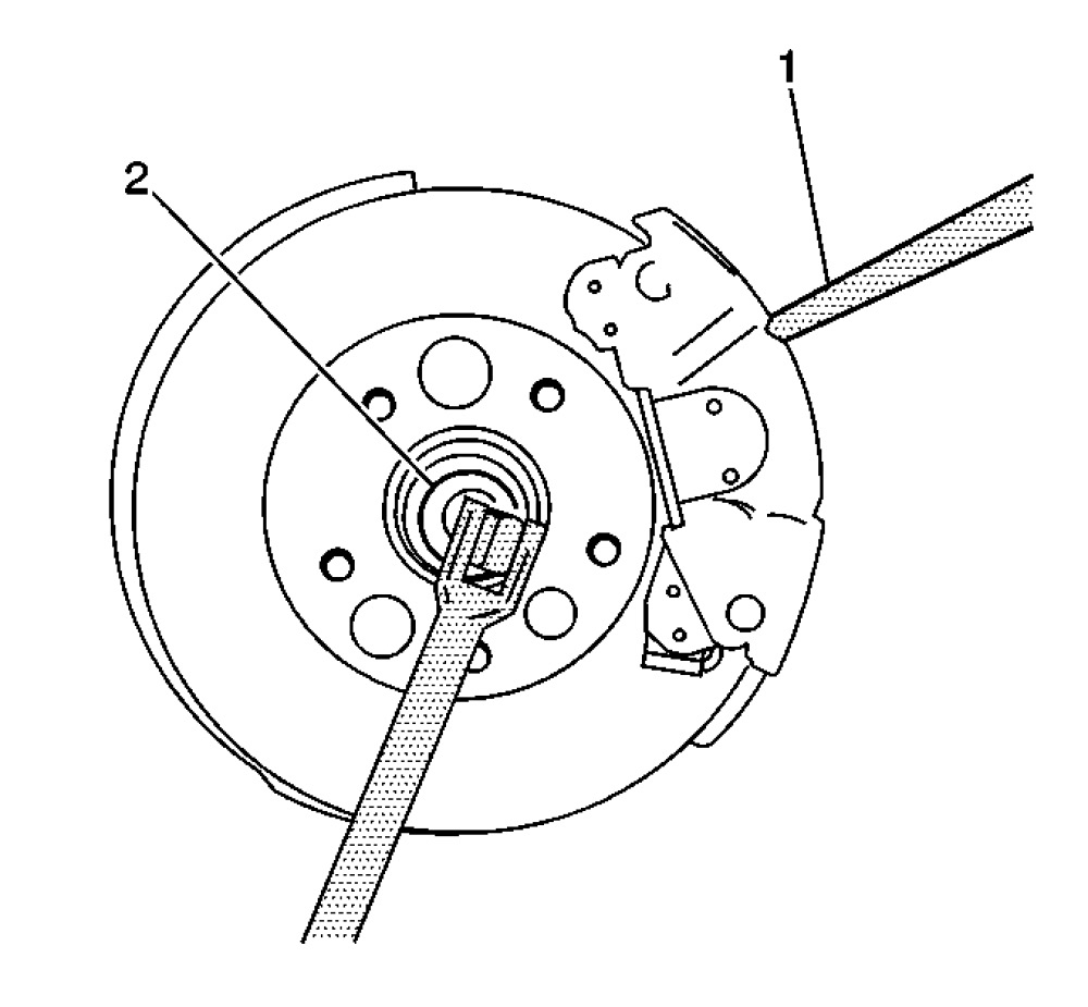

5. Remove the front wheel drive shaft nut (2). Insert a drift or flat-bladed tool (1) into the caliper and rotor to prevent from turning.

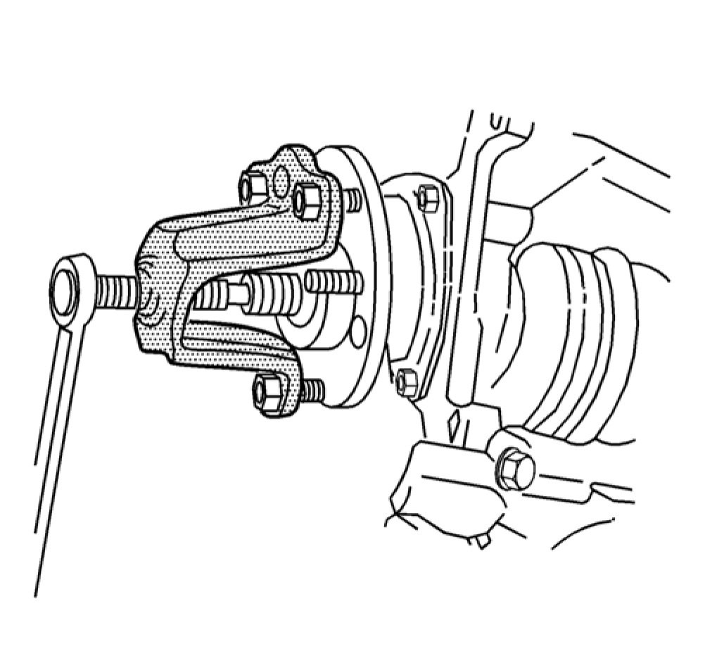

pic 4
7. Use 3 wheel nuts in order to attach the J 42129 to the wheel bearing/hub.
8. Use the J 42129 in order to push the wheel drive shaft out of the wheel bearing/hub.
pic 5
9. Remove and DISCARD the wheel bearing/hub bolts. Remove the J 42129 from the hub.

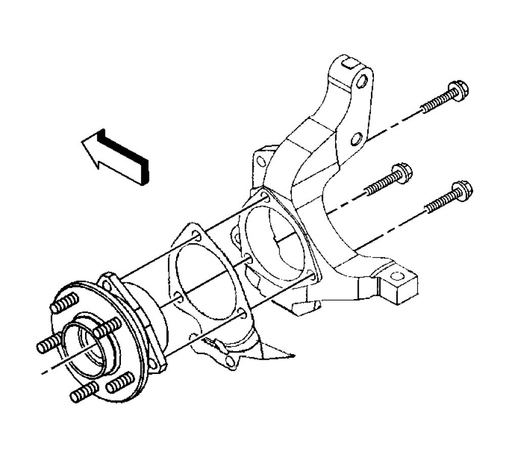

10. Remove the wheel bearing/hub and splash shield-noting the position of the shield for re-installation.
