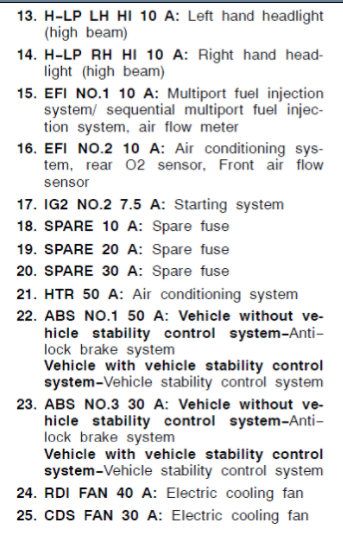

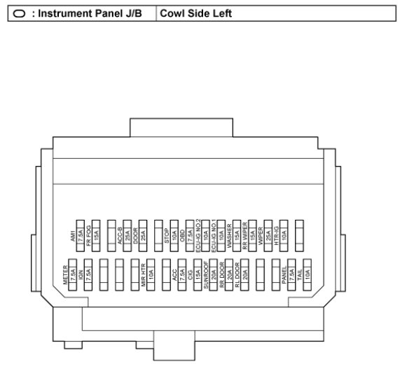

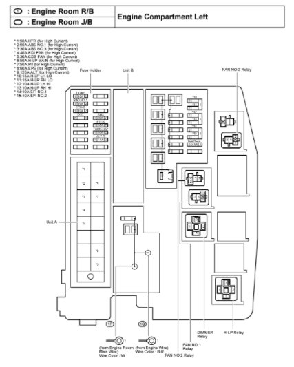

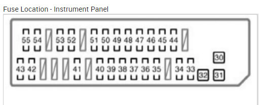

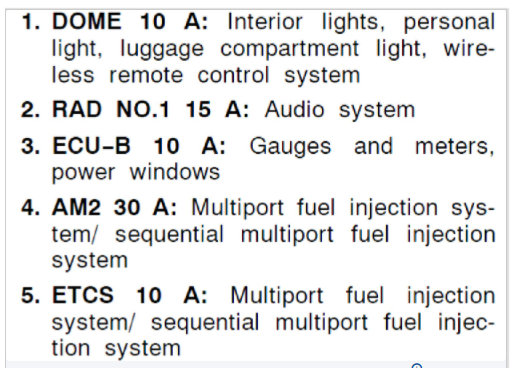

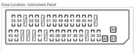

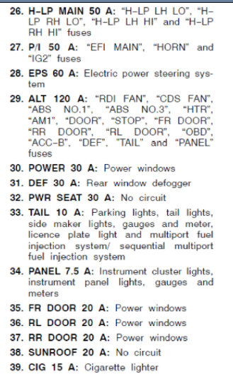

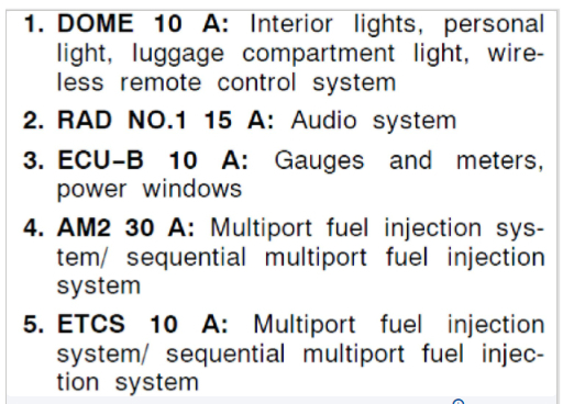

The blinkers stopped working I need to check the fuses. Thank you....Len
Jun 13, 2010 at 9:32 PM
DANNY L
  • 5,648 POSTS

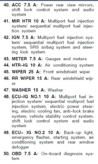

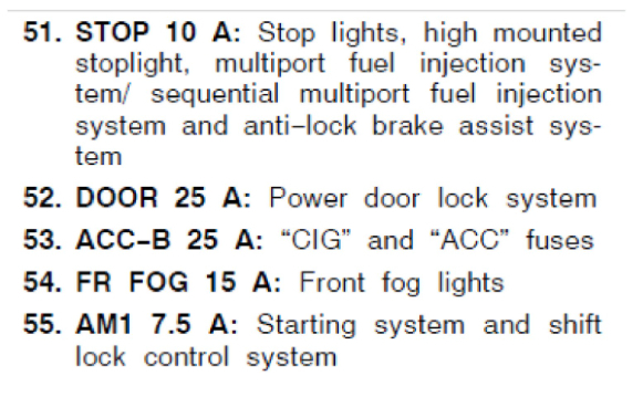

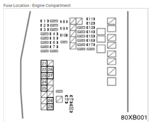

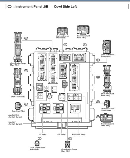

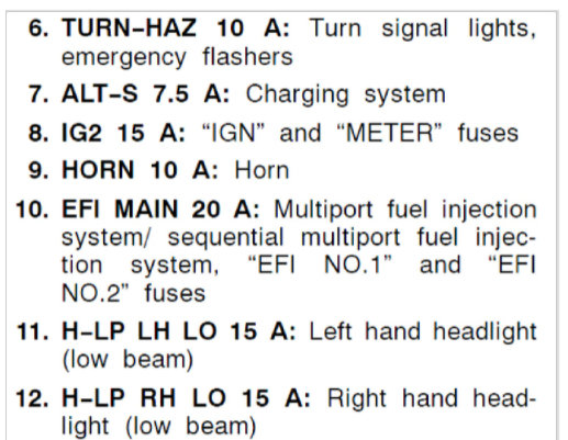

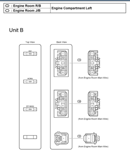

Hello, I'm Danny.
Here is the information you requested. Here are a few tutorials for you to view on how to check and replace fuses:
https://www.2carpros.com/articles/how-a-car-fuse-works
I've attached pictures below showing the fuse and relay locations on your vehicle. Hope this helps and thanks for using 2CarPros.
