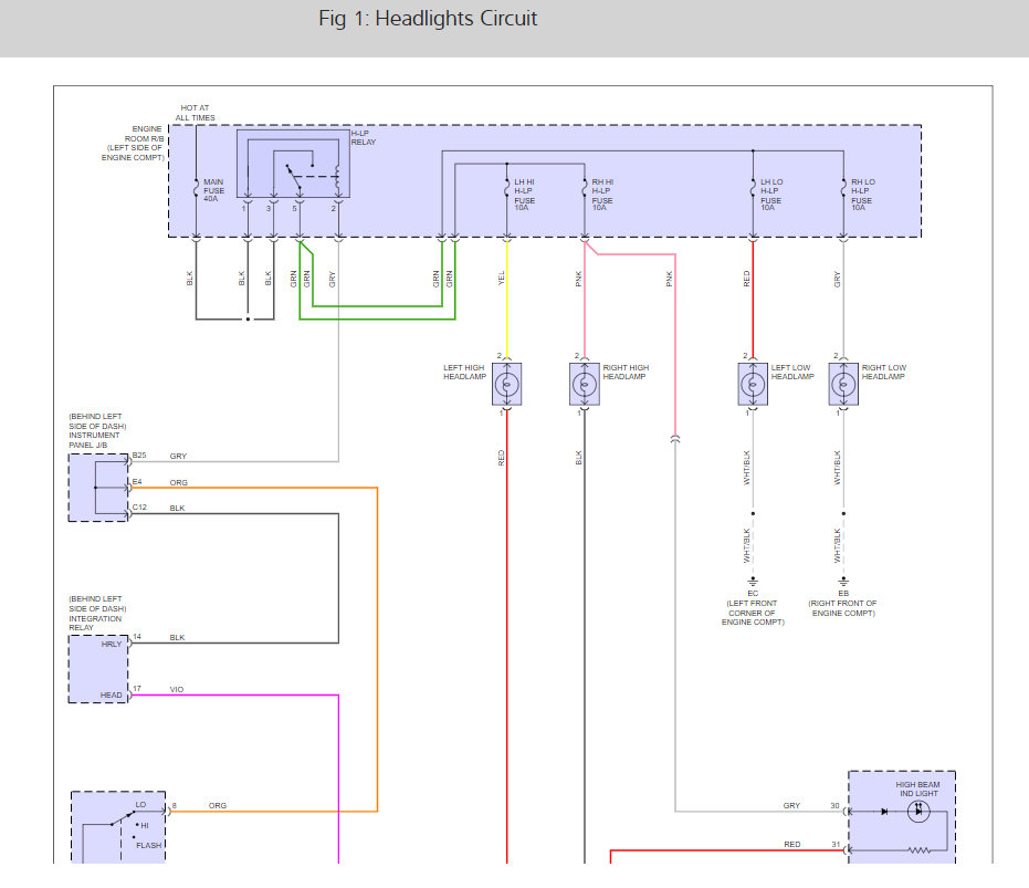

both my low beam headlights are not working, but I checked the two fuses for the RH and LH low beam and they are OK. Suggestions?
Aug 29, 2010 at 10:16 AM
FORDRACING24
MEMBER
65 POSTS

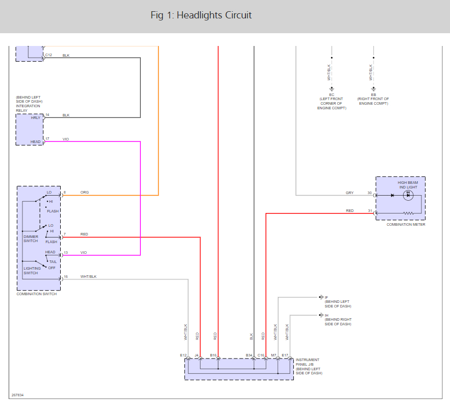

It sounds like you have a switch that is not working here is a guide to help you see where you lose power and the headlight wiring diagrams so you can see how the system works.
Check out the diagrams (Below). Please let us know what you find. We are interested to see what it is.
Cheers
Aug 30, 2010 at 7:14 PM
JOHNNY178
MEMBER
2 POSTS
thanks for this post I had to replace the headlight switch cost me $78.00 all fixed!
