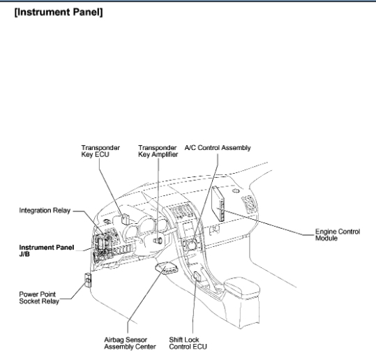

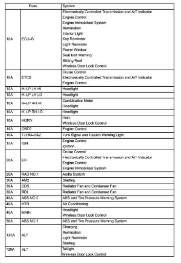

I'm replacing the radiator core support on my tc and i need to remove the front bumper support. I heard a spark so I want to check the fuses but cant find them nor do I know how to check them?

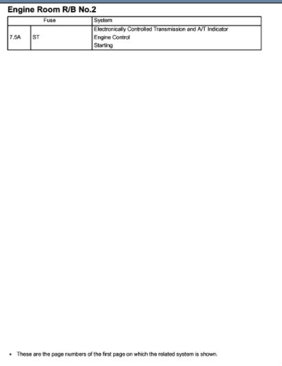

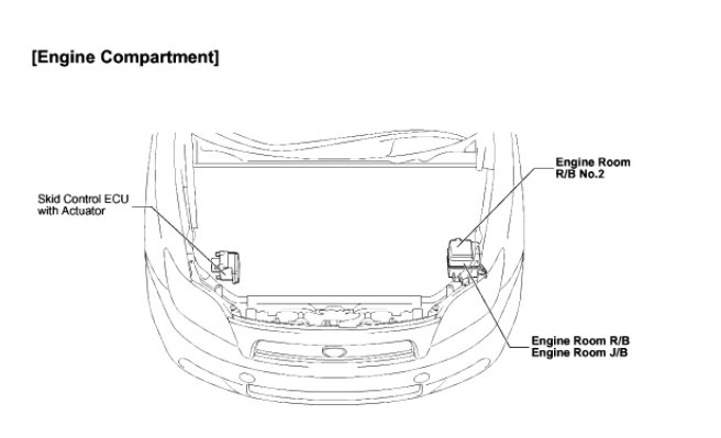

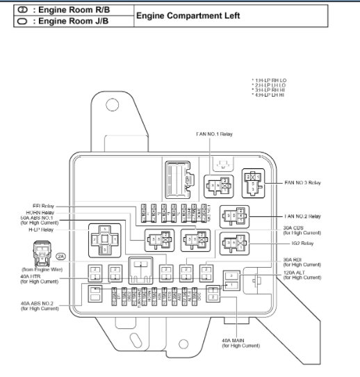

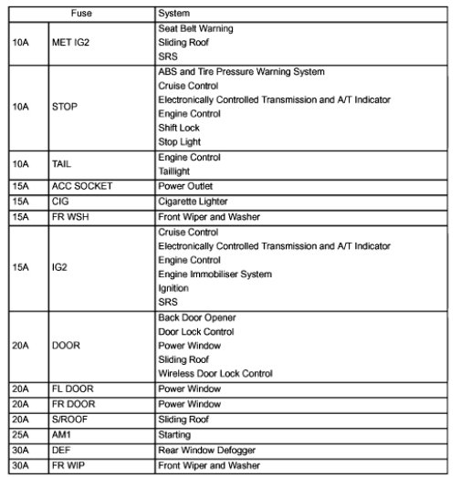

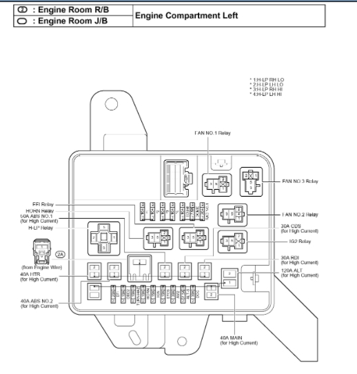

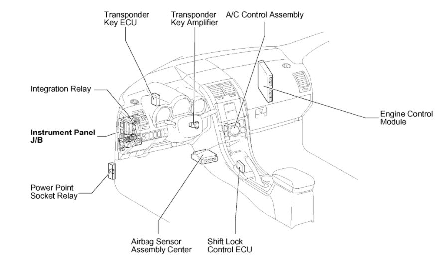

Here is the information you requested. Here are a few tutorials for you to view on how to check and replace fuses:
https://www.2carpros.com/articles/how-a-car-fuse-works

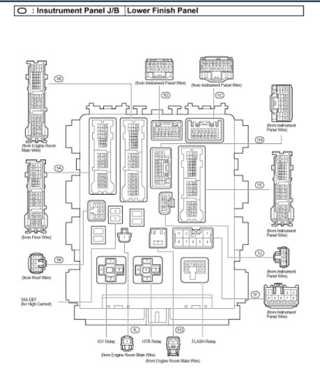

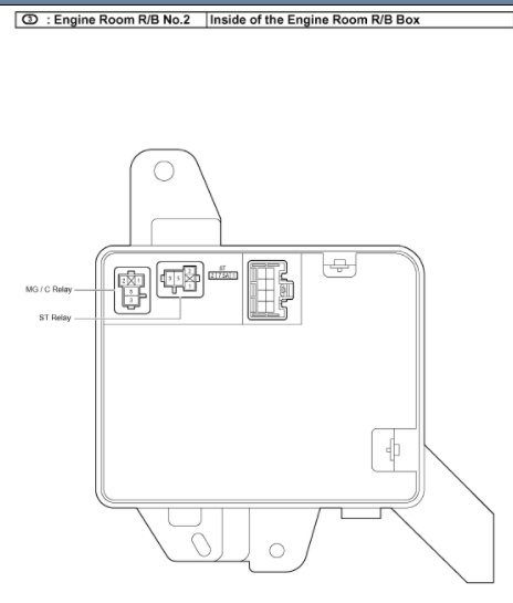

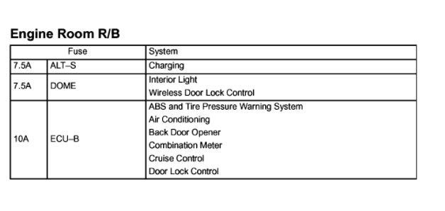

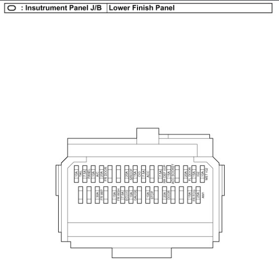

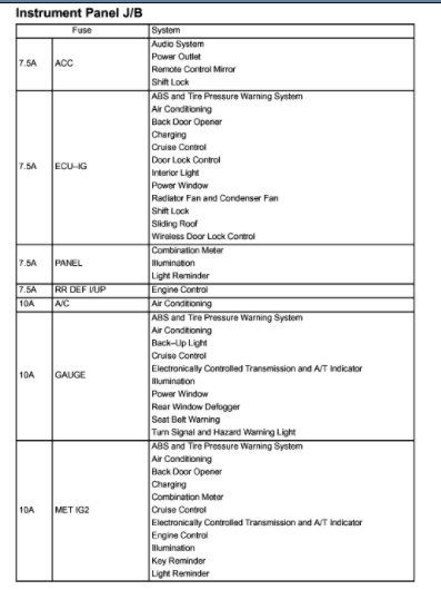

I've attached pictures below showing the fuse and relay locations on your Scion TC. Hope this helps and thanks for using 2CarPros.
