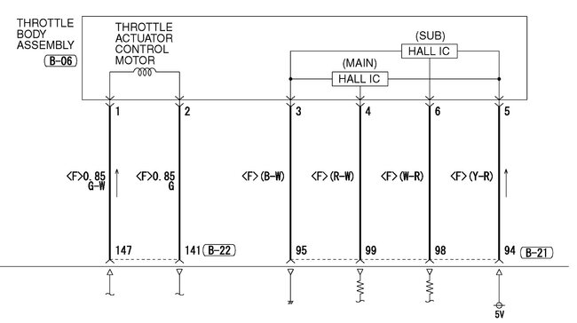

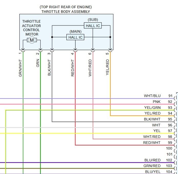

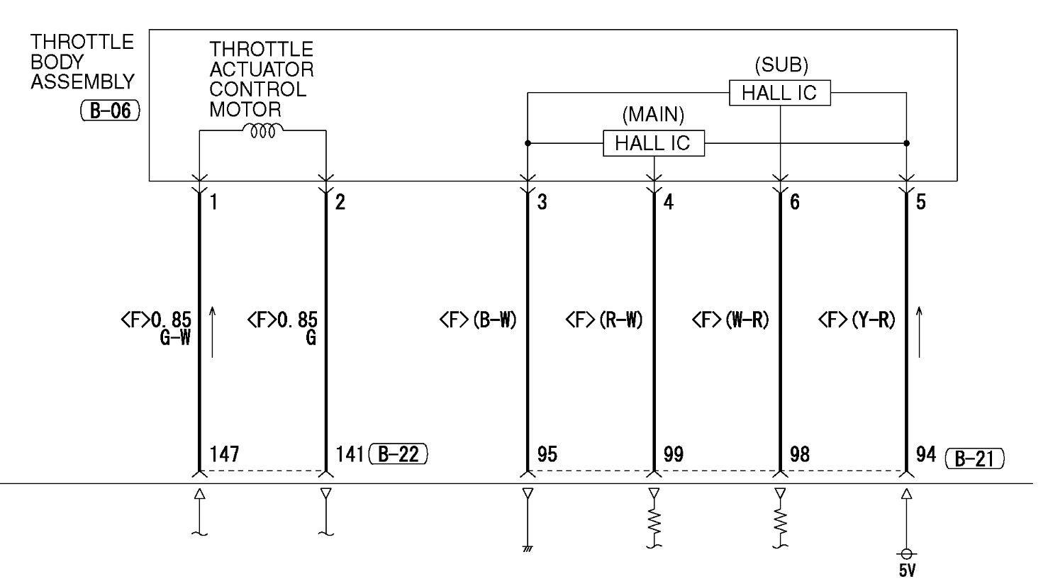

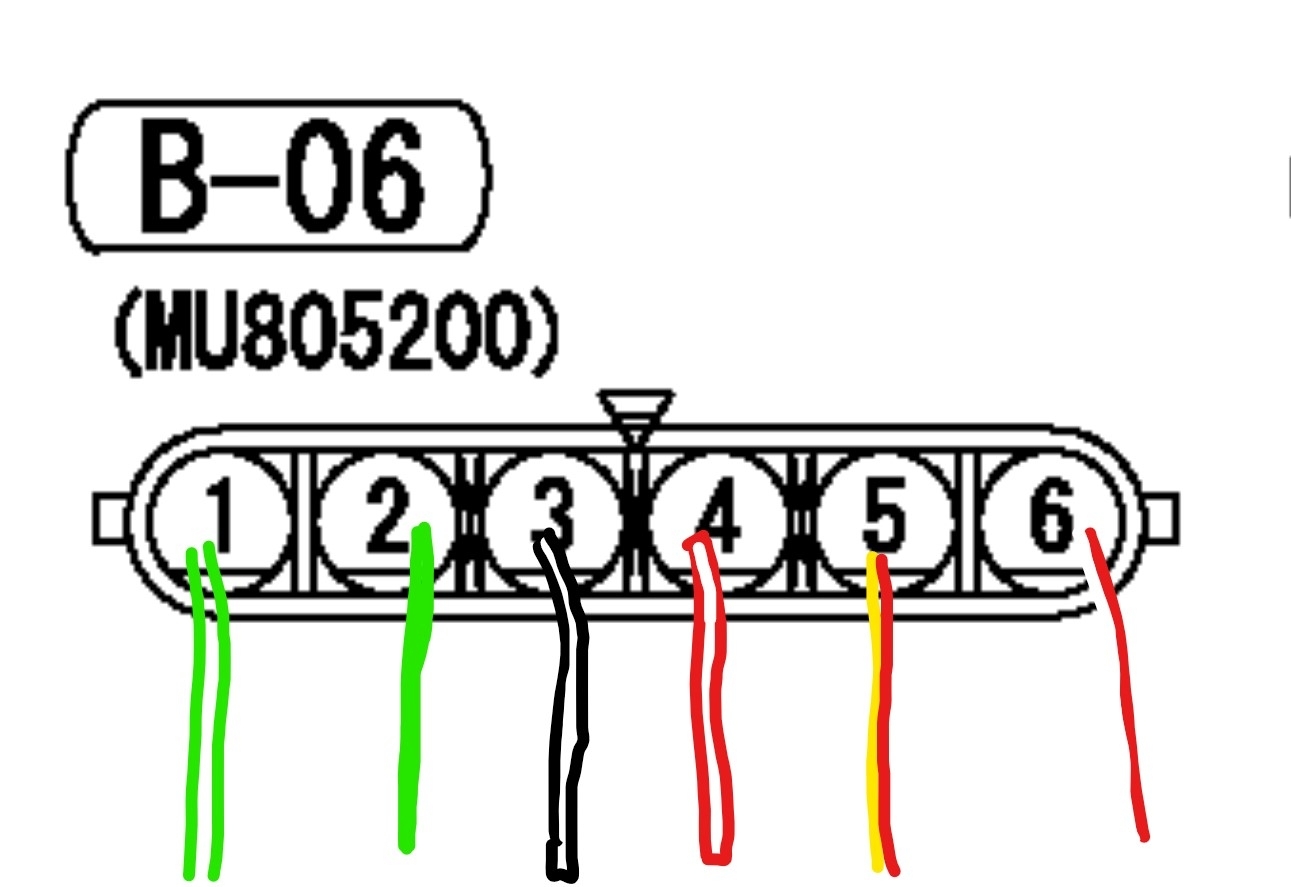

These are the color and OEM wiring diagrams for the throttle body. The connector image shows the colors as well. There is a different diagram for the manual transmission and the V6 version which is different than both. Pin 1 Green with white stripe, Pin 2 Green, Pin 3 Black with white stripe, Pin 4 Red with white stripe Pin 5 Yellow with red stripe, Pin 6 is White with red stripe.
