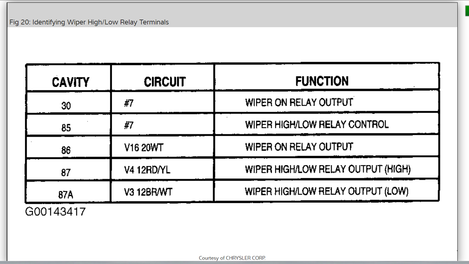

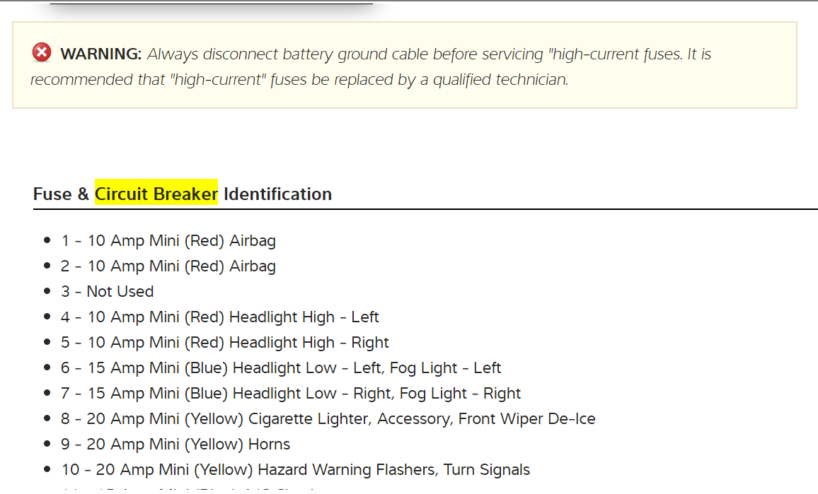

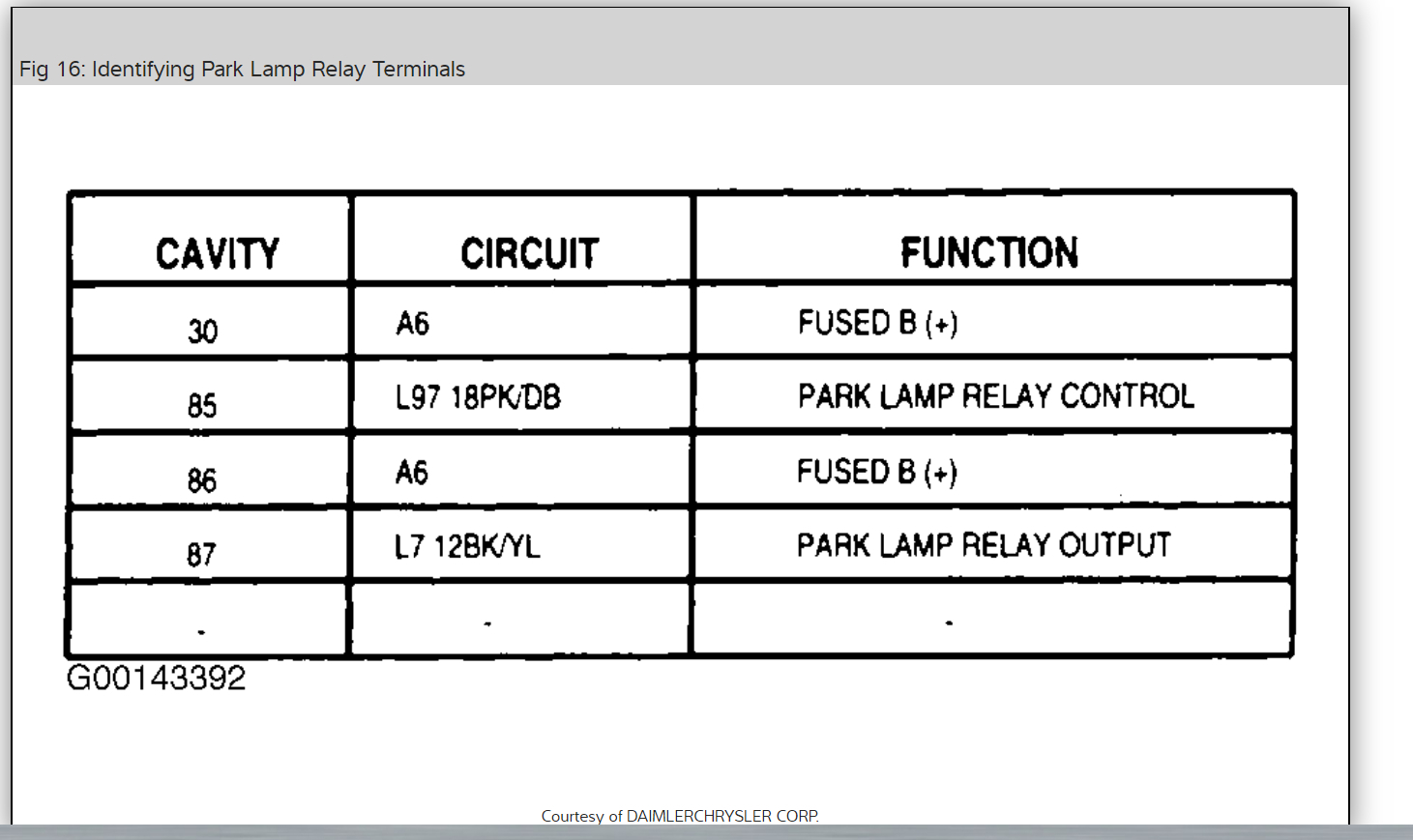

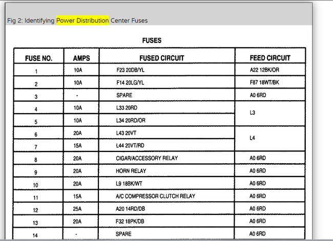

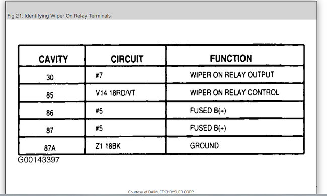

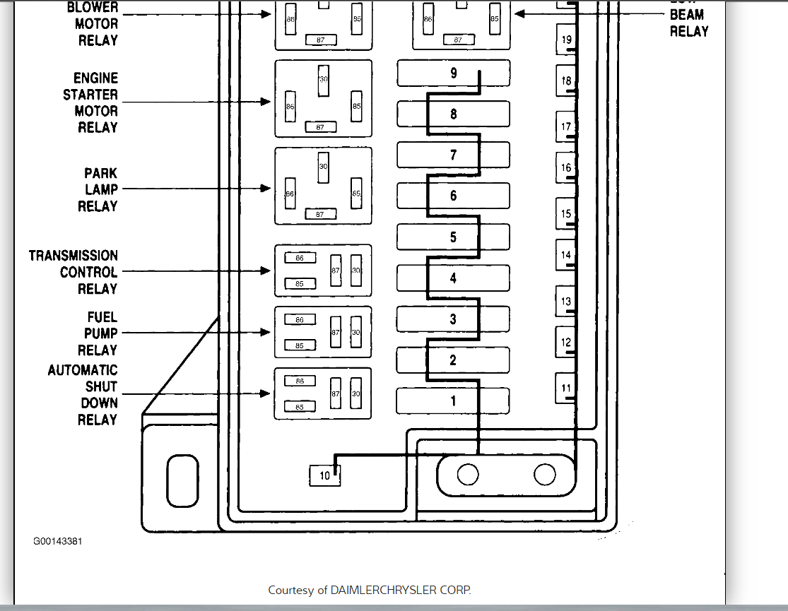

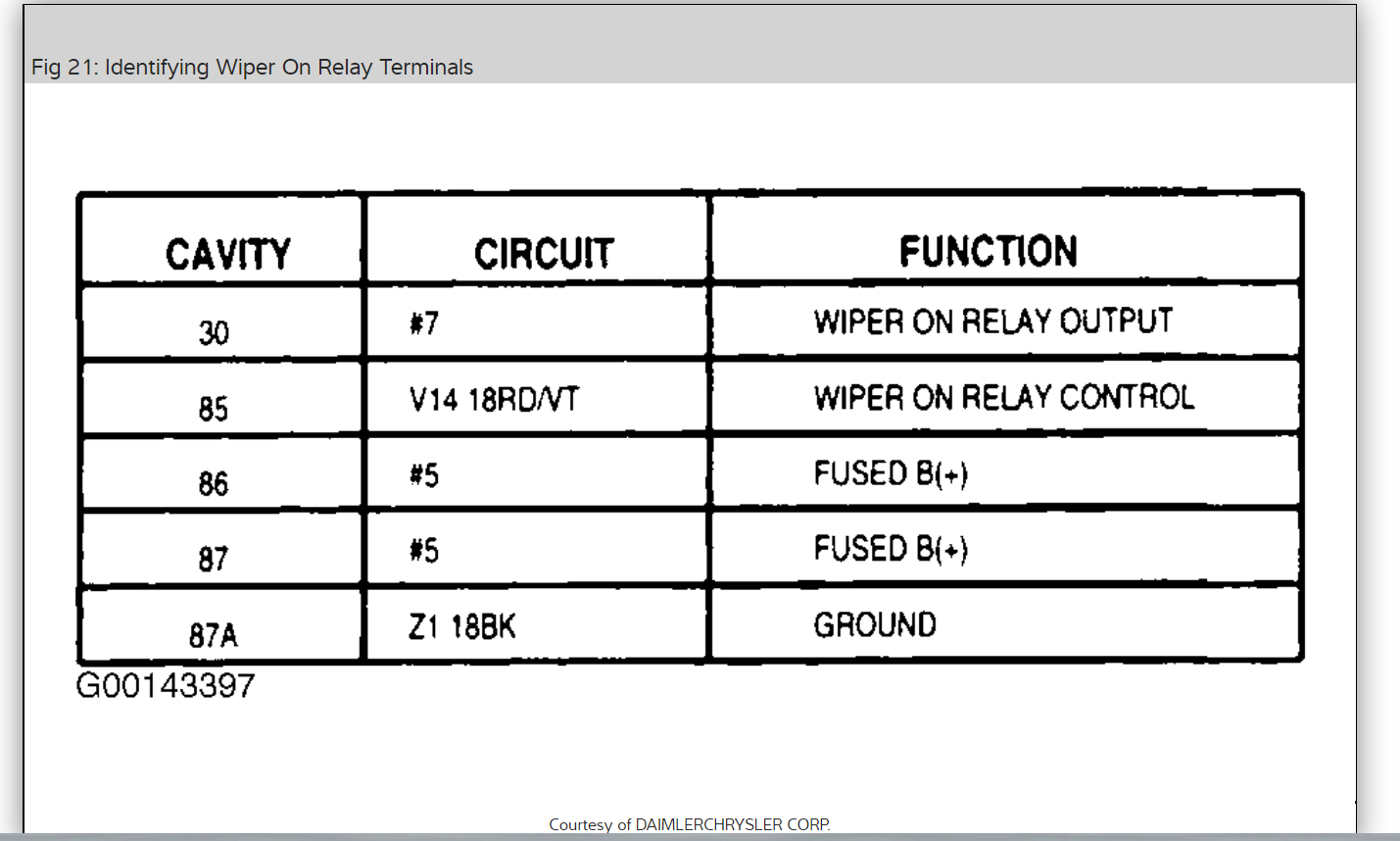

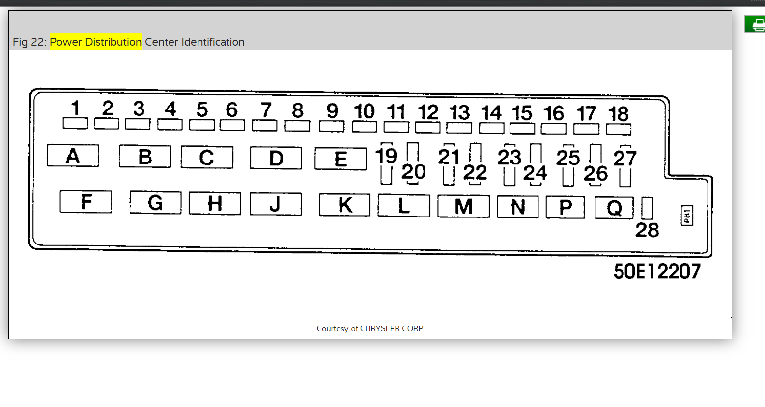

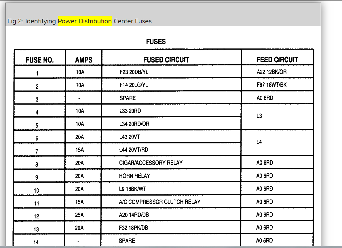

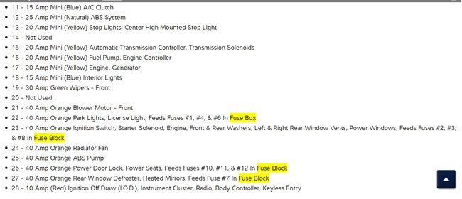

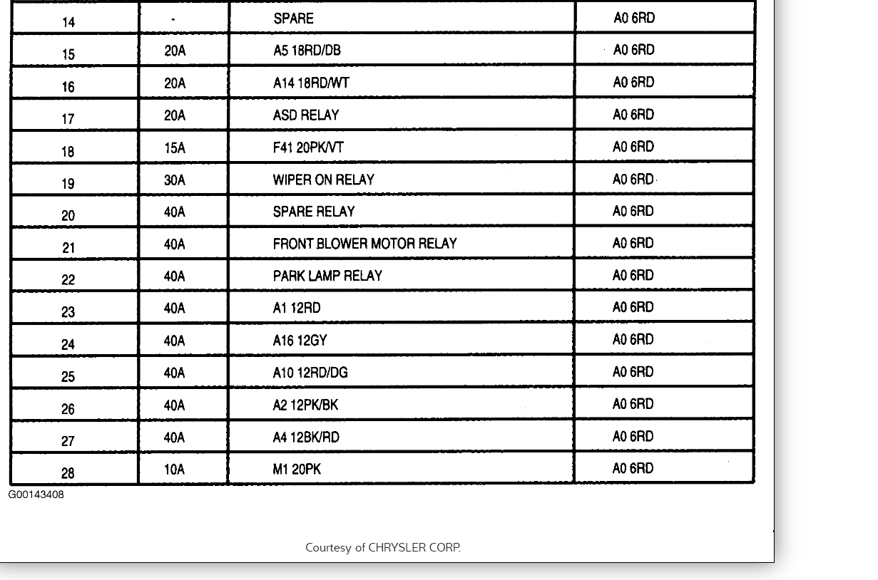

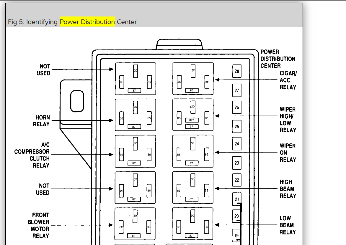

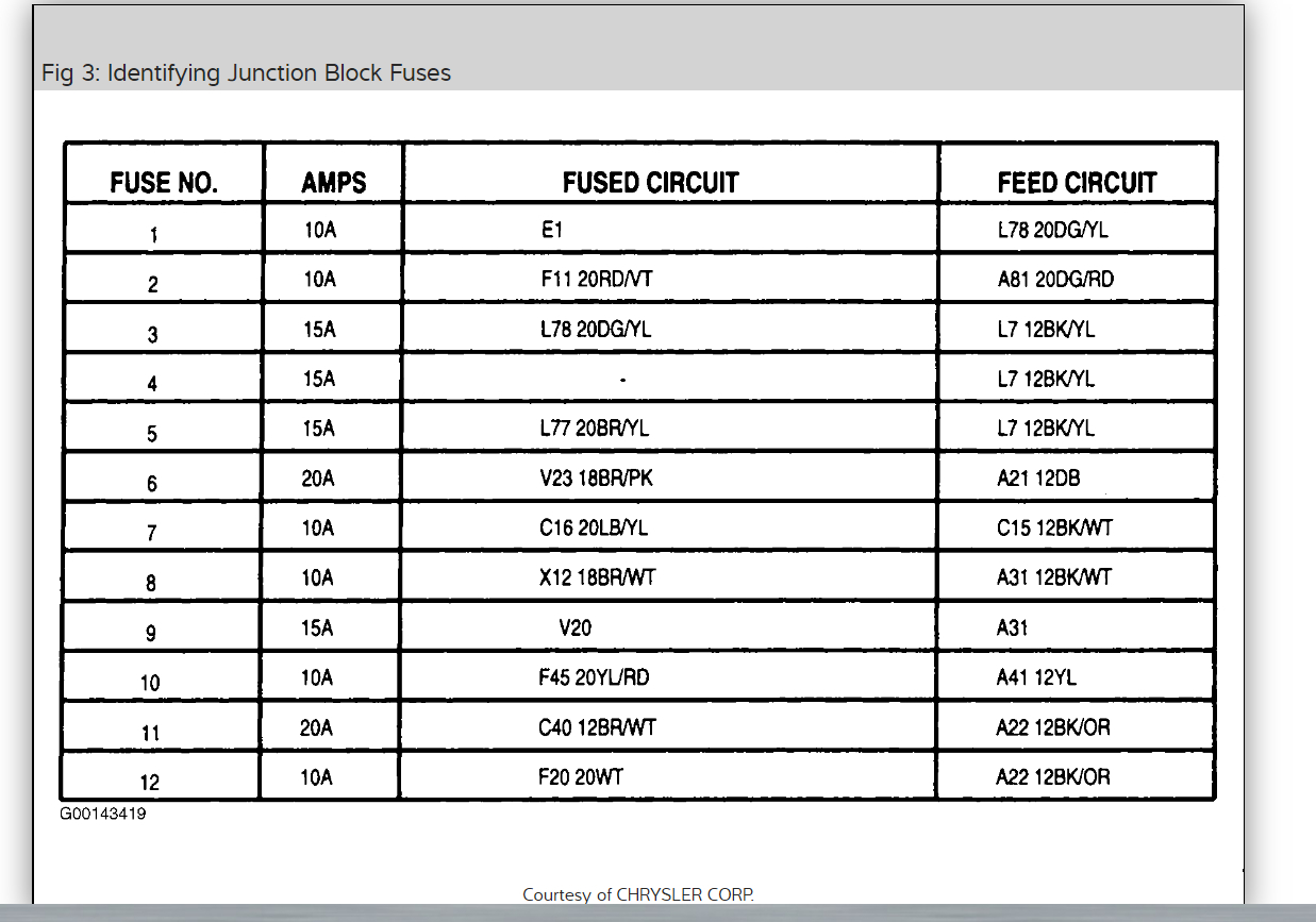

Power door lock triggers every minute or so, even when car is turned off, and drains the battery over time. Suspect bad door lock relay, but do not have a schematic of the junction control box. Need same with notations that identify the use of each of the PTC's, relays and fuses in the box to be able to continue with my DIY troubleshooting.
