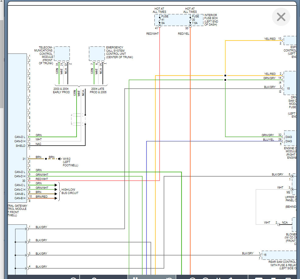

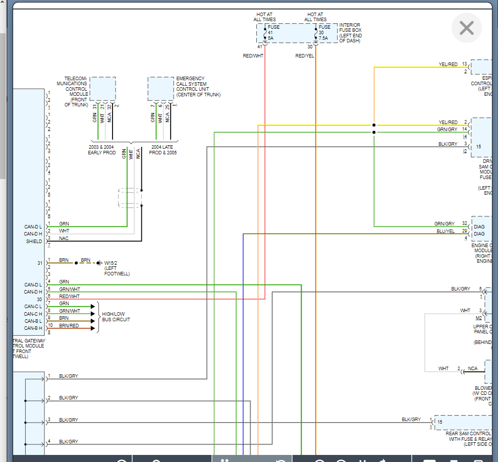

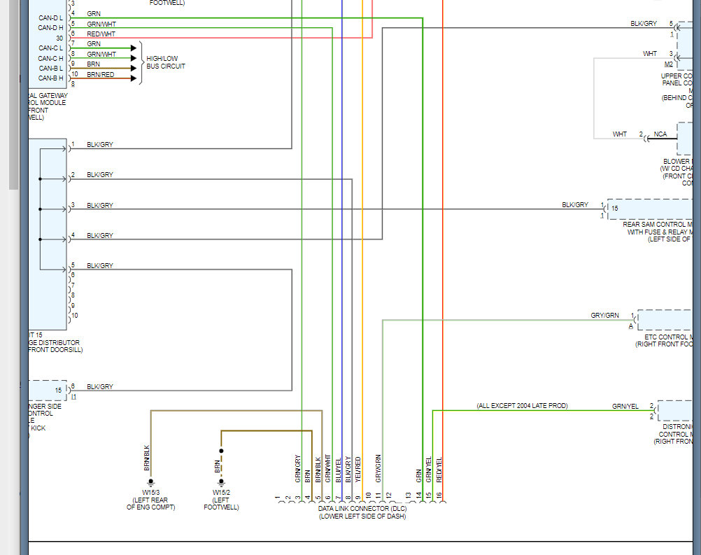

We need to start with checking for power at the DLC and make sure the fuses are okay. I proved the wiring diagram below but here are a couple guides that will help with this in case you need it:
