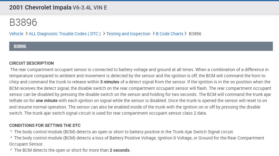

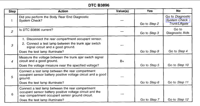

This code is an odd one. I had to read through the description several times simply because I've never seen or dealt with it before. It deals with the rear occupant sensor.

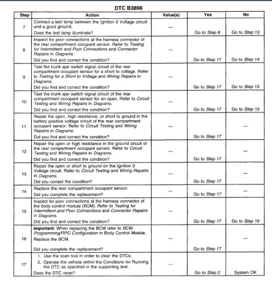

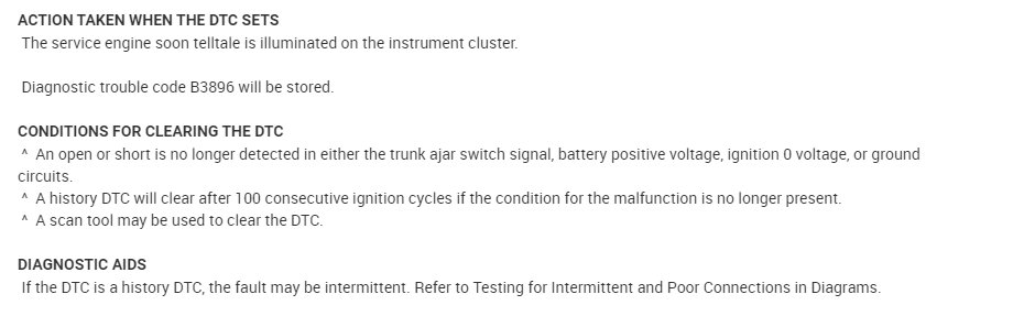

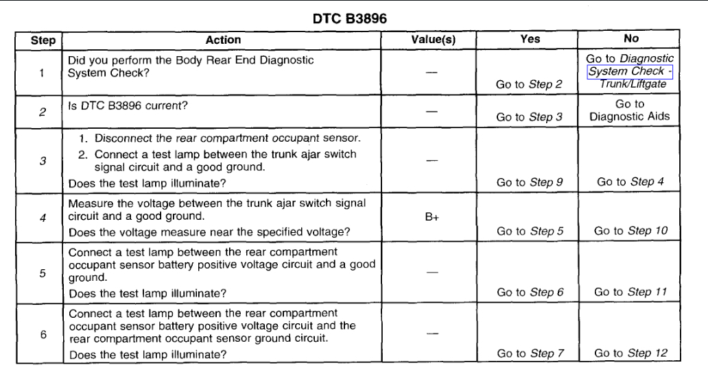

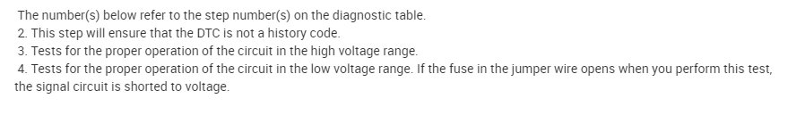

I attached information below specific to the code. It provides a description and the diagnostics related to it. Take a look through it and let me know if you are comfortable performing the tests. We may have to work together on this one. LOL
Take care and let me know what you find.
See pics below.
