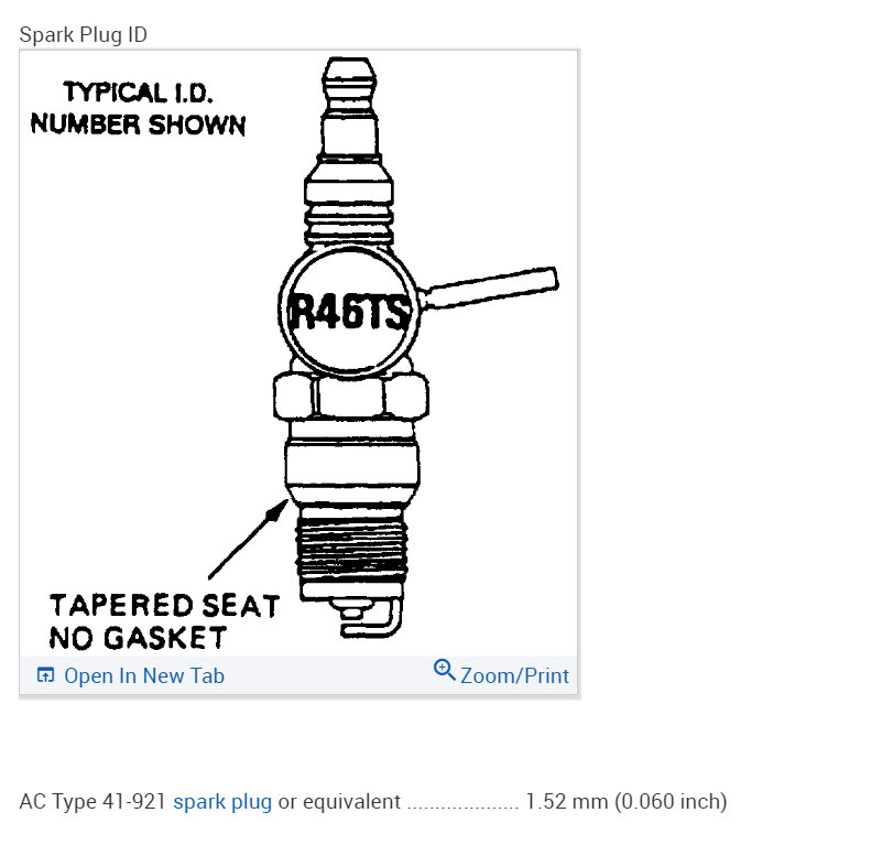

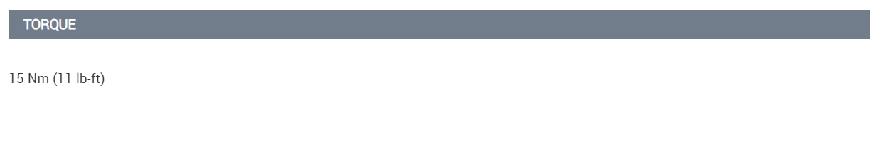

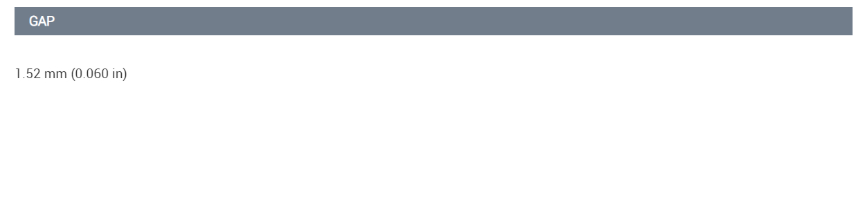

Here's the spark plugs type, gap, and torque spec. These don't have a crush ring, so don't over tighten them or they can break off in the cylinder head.
