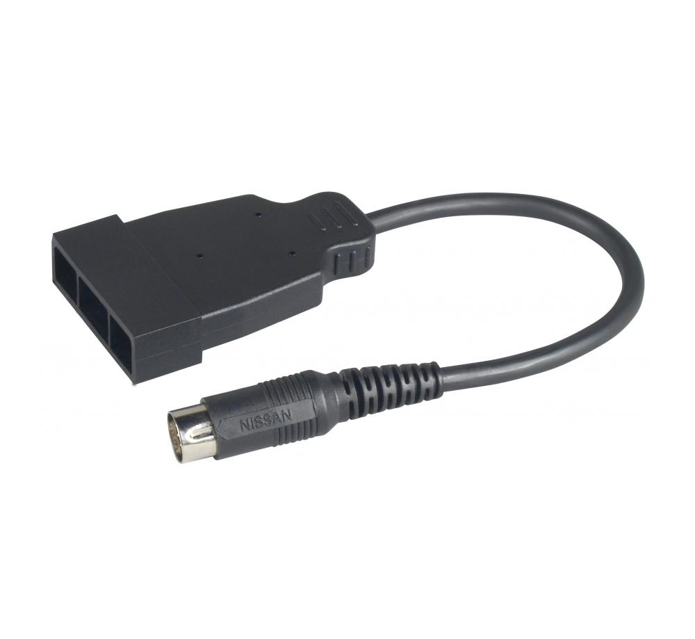

What cables do I need for my Genisys EVO 4,0 scan tool in order to scan this vehicle? The scan tool tells me that I need the proper Nissan cables.

Welcome to 2CarPros. You need the OBD II cable with the correct key or the smart cable. You can also use the OTC 3305-141 cable if you have the correct connector. That cable is used with the adapter. However it should have the common connector. This guide can help as well
Check out the diagrams (Below). Please let us know what happens.
