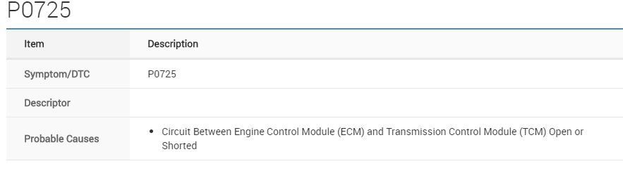

DTC P0725 ENGINE SPEED SIGNAL
Description
The engine speed signal is sent from the ECM to the TCM.
CONSULT-II Reference Value
On Board Diagnosis Logic
- This is not an OBD-II self-diagnostic item.
- Diagnostic trouble code "P0725 ENGINE SPEED SIG" with CONSULT-II is detected when TCM does not receive the engine speed signal (input by CAN communication) from ECM.
Possible Cause
Harness or connectors
(The ECM to the TCM circuit is open or shorted.)
DTC Confirmation Procedure NCS0014R
