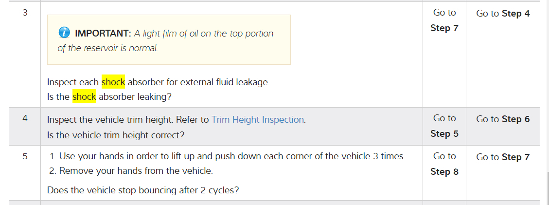

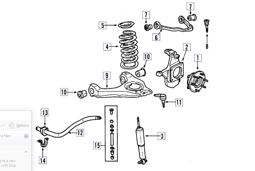

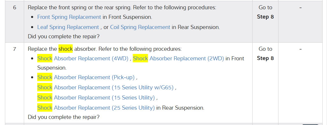

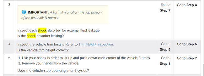

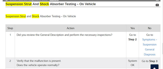

This could be a couple of things. Let's start by looking at the shock for the tire in question. In the diagrams down below I have included the factory guide for inspecting the shocks for your vehicle with them still on the vehicle. Please go through this guide and get back to us with what you are able to find out.
Thanks,
Alex

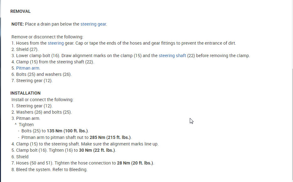

I attached the process below and it says that there was a shield removed so we need to check this as well. Basically I would suggest going back over the repairs and make sure everything is tight but start with trying to isolate it.
