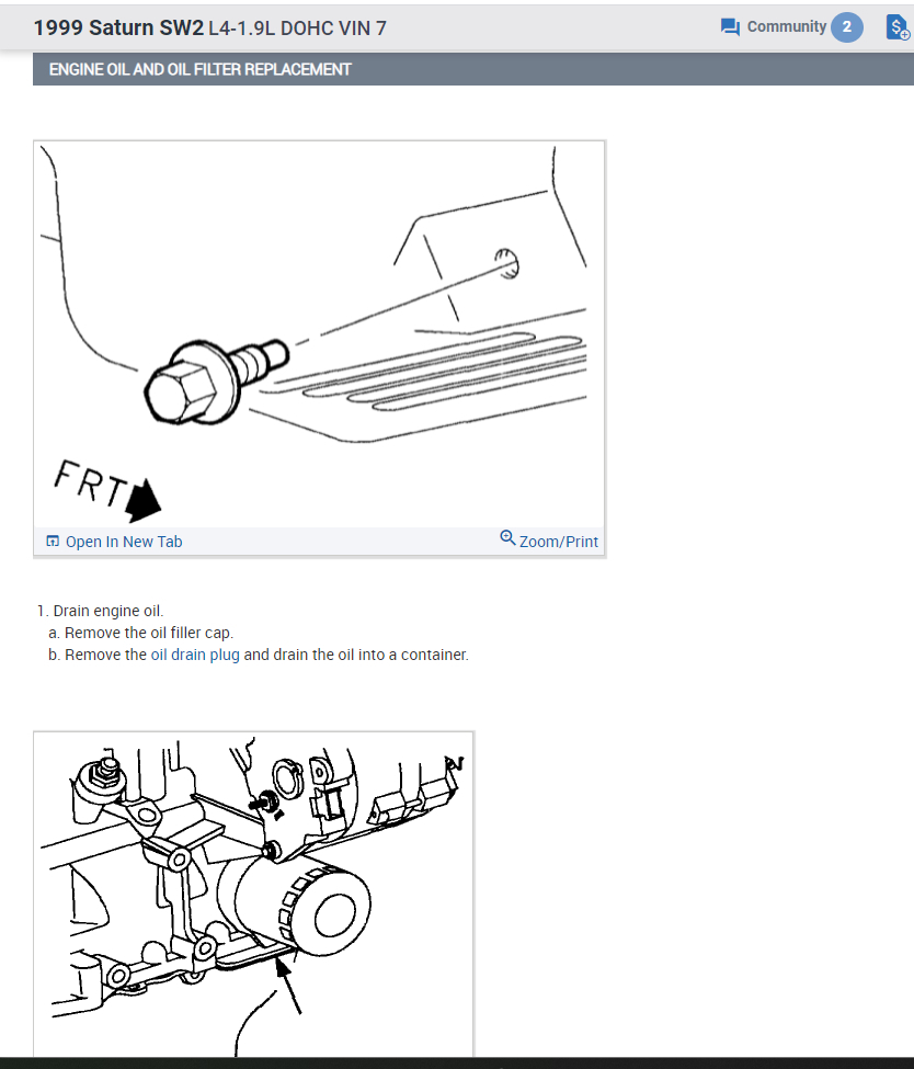

It is past time for my oil change and I had been getting them per my maintance schedule. Now that my Saturn dealer has closed, I'm thinking about doiing it myself. Does my car have a sensor or any other thing that I could be concerned about before I attempt this?
Feb 1, 2010 at 11:59 AM
This is an easy process and is something that most can do themselves. Here is a guide that will walk you through this:
https://www.2carpros.com/articles/how-to-change-engine-oil-and-filter
Here is a video on a similar vehicle as well that will give the detail that you need to complete this:
https://www.youtube.com/watch?v=RX5C-oKG2S8

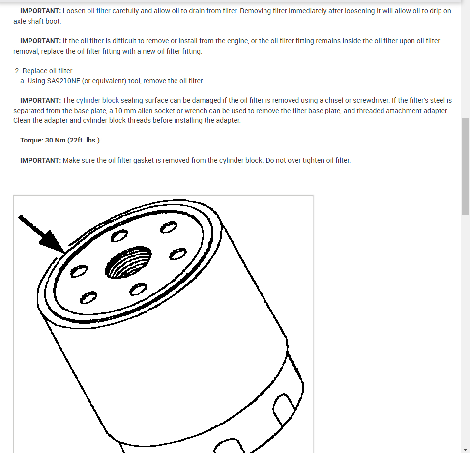

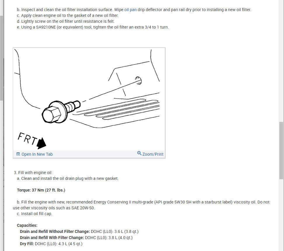

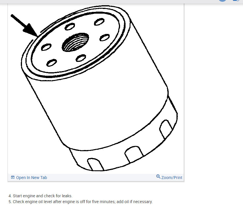

Below is the process from the manual that will give the specifics needed to complete this.
