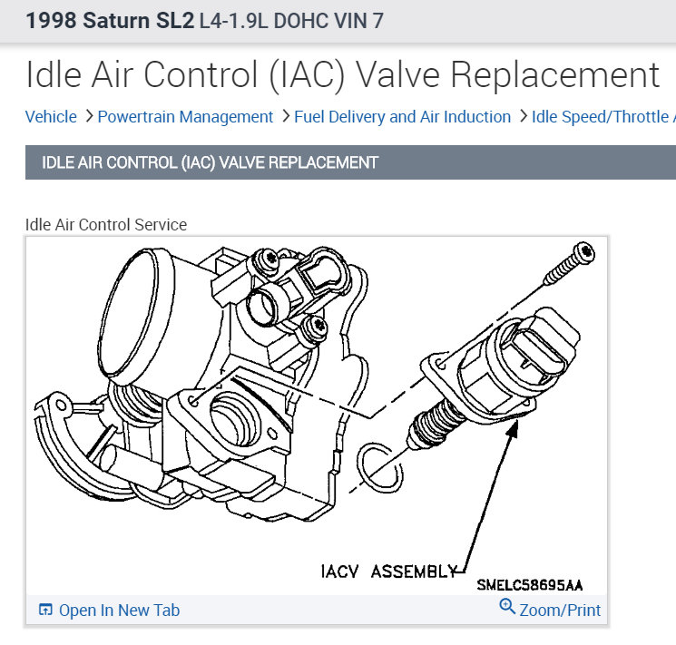

It soin slike they missed the IAC which sounds weak. Here are two guides that can help us fix this problem.
https://www.2carpros.com/articles/engine-idles-too-high
and
https://www.2carpros.com/articles/how-to-replace-an-idle-speed-control-motor-iac
Check out the diagrams (Below). Please run this test and get back to us.

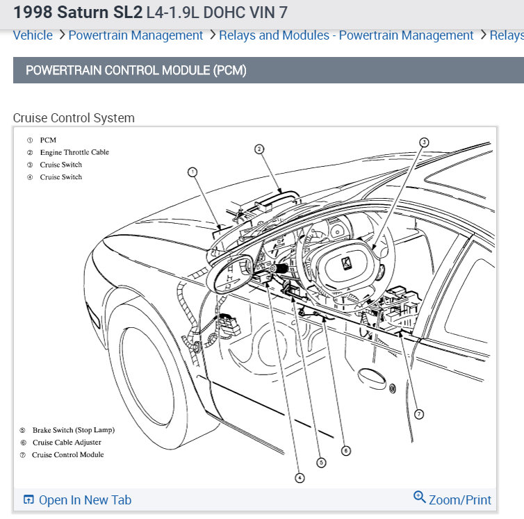

It sounds more like the PCM is not working right I would try a rebuilt or used unit here is the location. Check out the diagrams (Below). Please let us know what you find. We are interested to see what it is.
