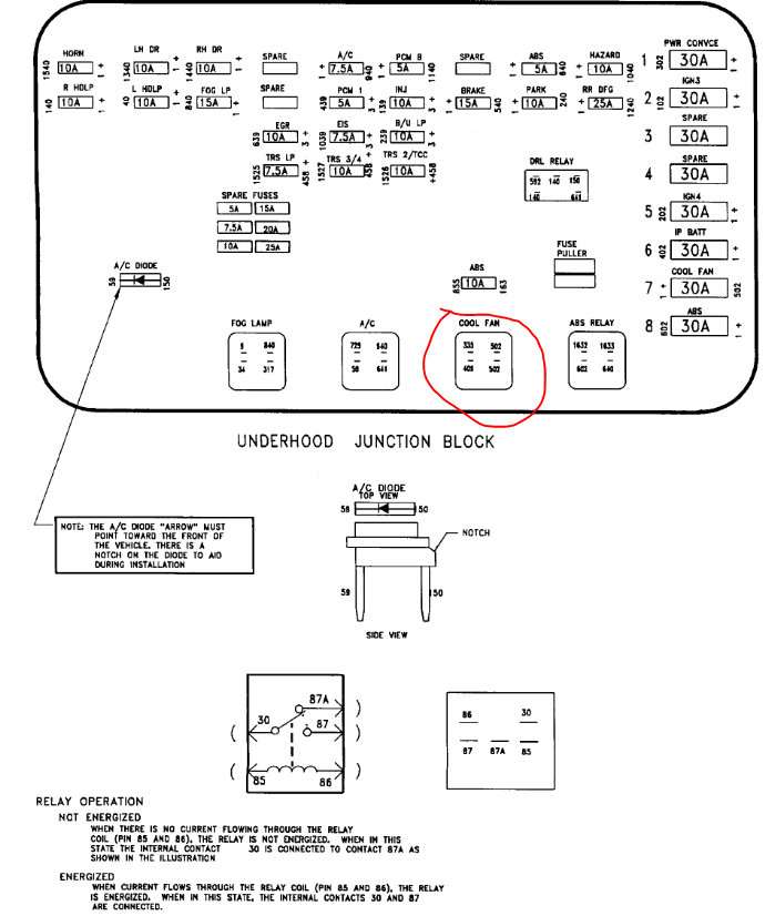

First you want to check the relay. The relay is located under the hood in the battery junction box (see diagram below).
Here is a article on how to test the relay:

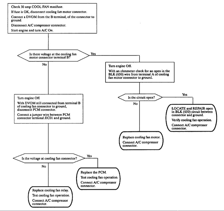

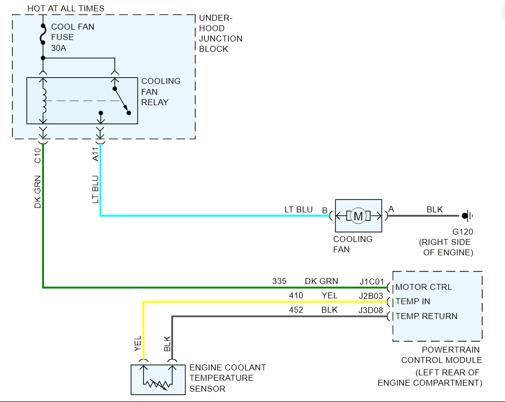

Then you want to check to see if you are getting power to the fan.
I have attached diagnostics as well as wiring diagrams for your reference.
