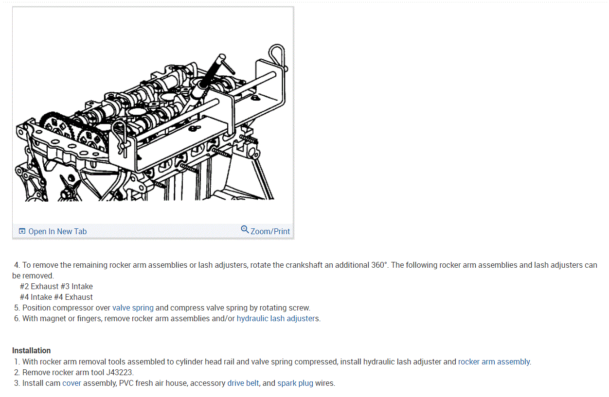

I have the directions but for some reason, no parts and labor. I can tell you it isn't a quick job. I would expect it to take approximately 3-4 hours.

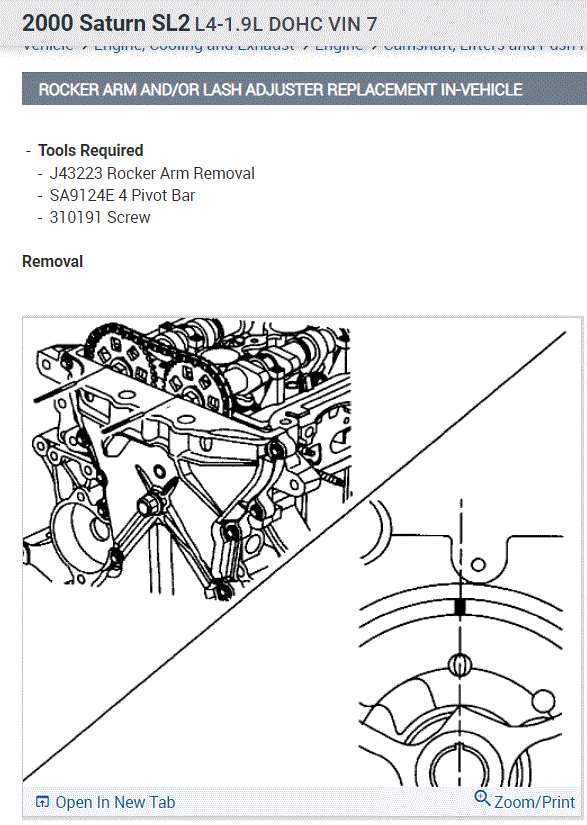

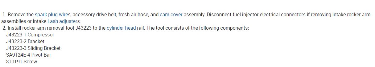

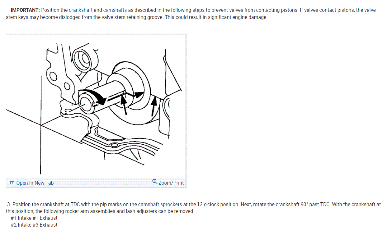

If you look at the attachments below, they are specific to the replacement. I don't know if it is something you are comfortable doing, but I thought I would add them.
I hope this helps. Let me know if you have other questions.
See pcs below.
