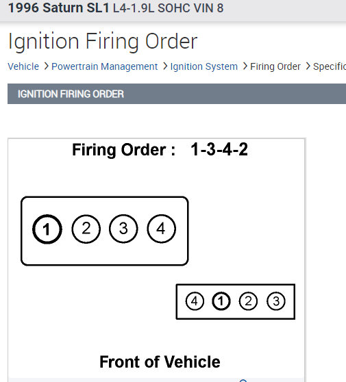

what is the piston order from left to right?
Aug 10, 2010 at 2:43 PM
SQM
  • 6,383 POSTS
The firing order for this vehicle is 1-3-4-2.
I have attached diagram for your reference.
