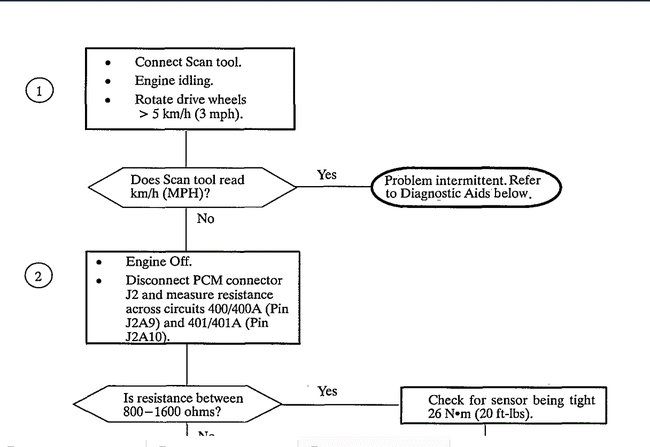

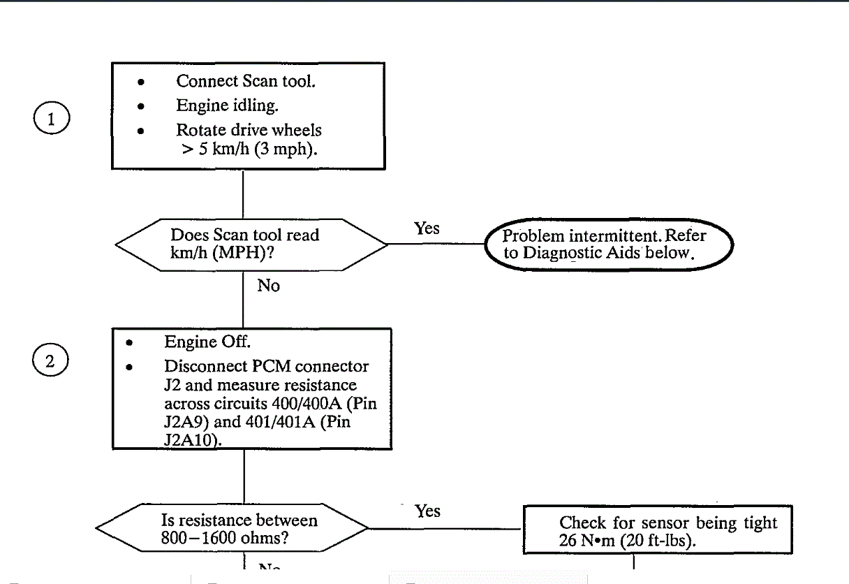

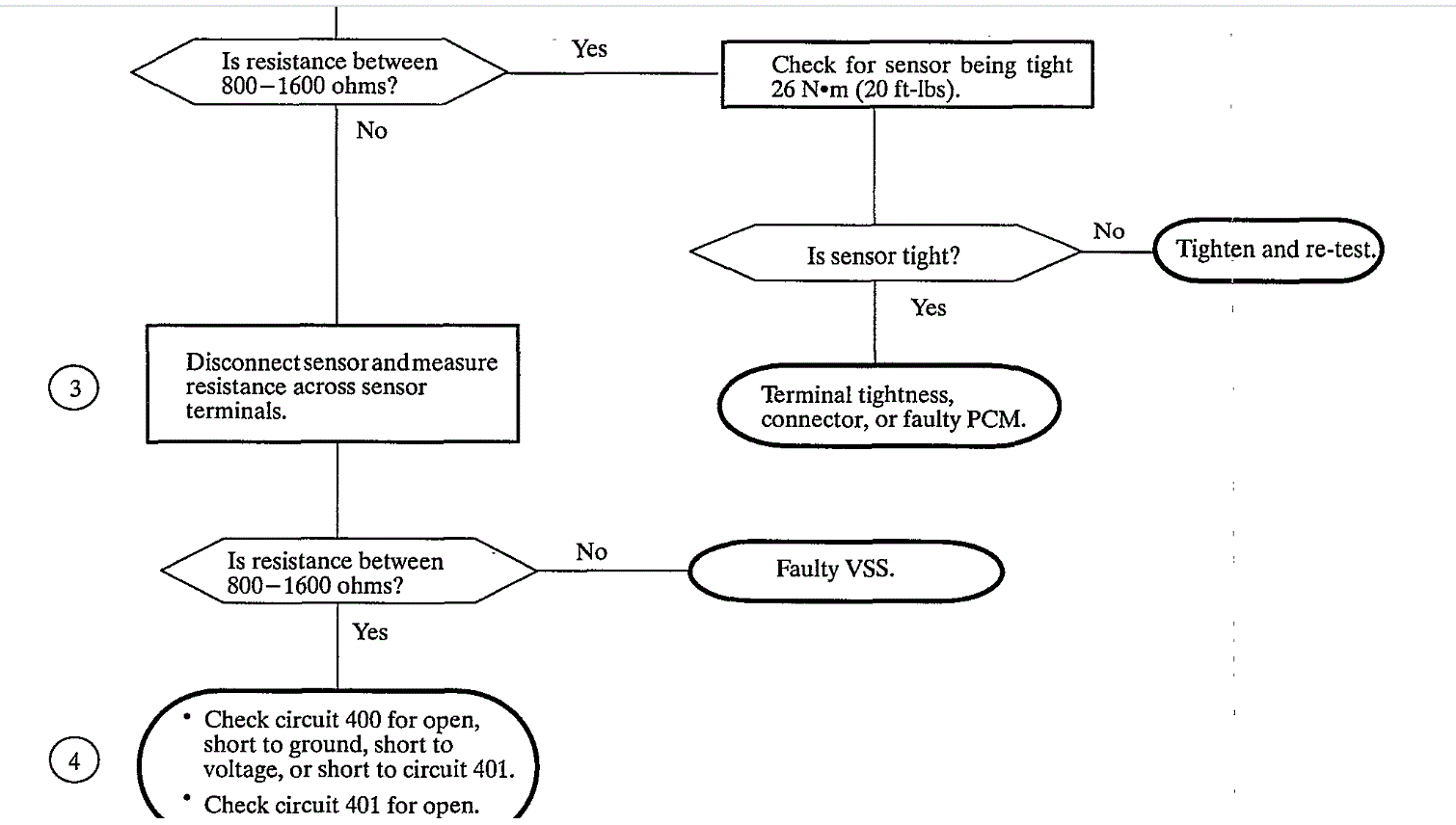

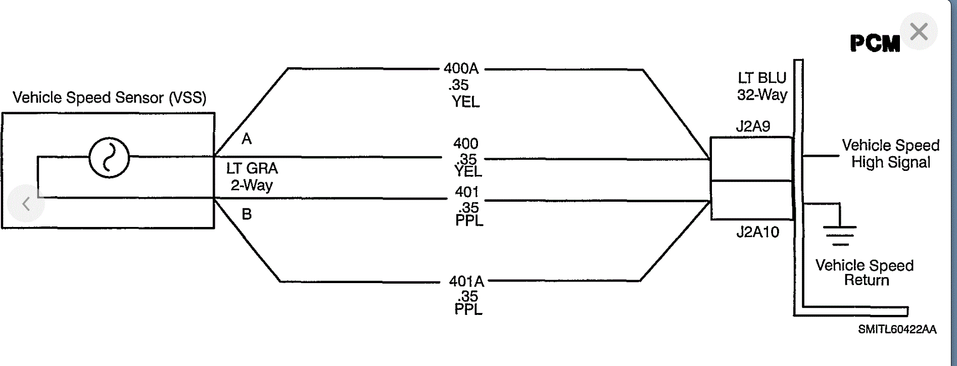

Sounds like a plan. I attached a vss wiring schematic and flow chart. Let me know what you find.
