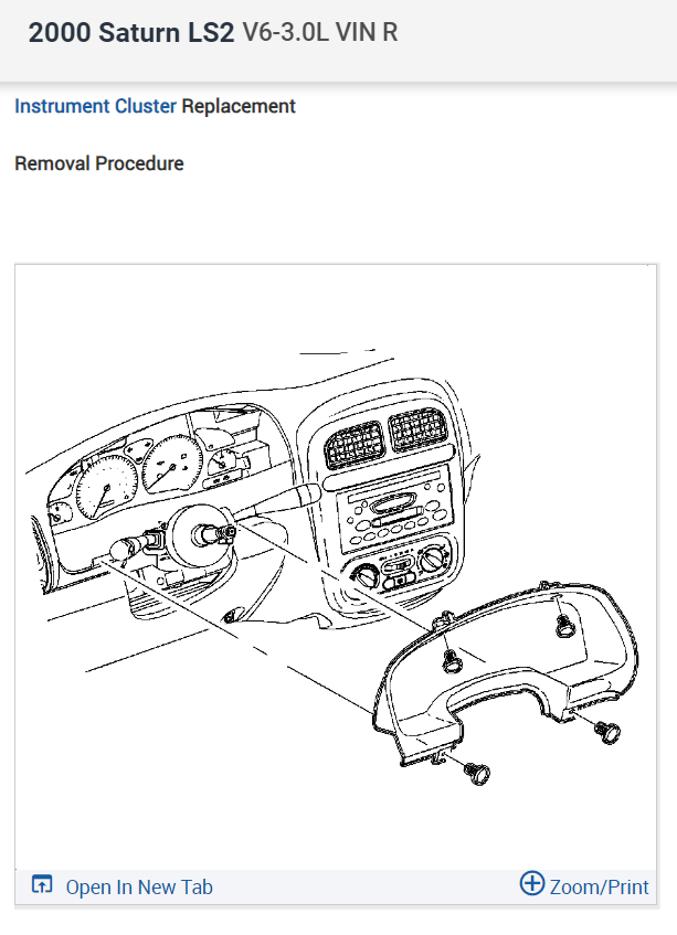

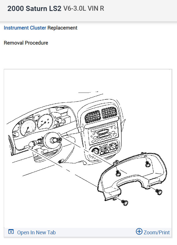

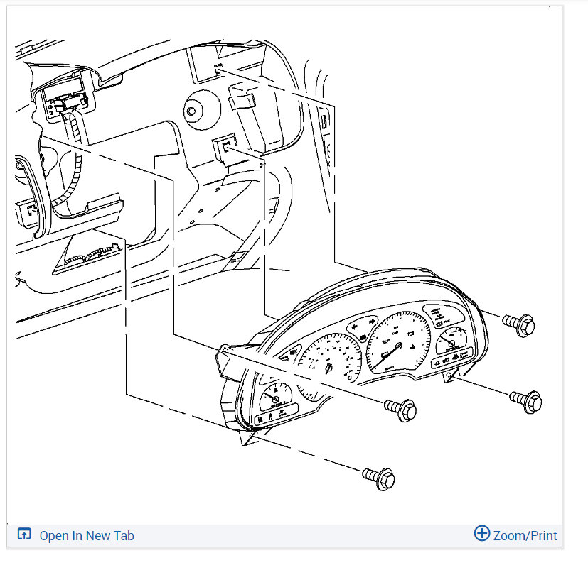

If all the fuses are good it sounds like the instrument cluster itself has gone bad. I would search google or ebay for a rebuilt or used unit and install it. Here is how, check out the images (below). Please let us know what happens.
