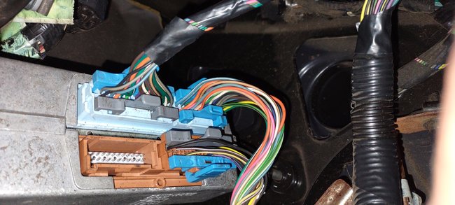

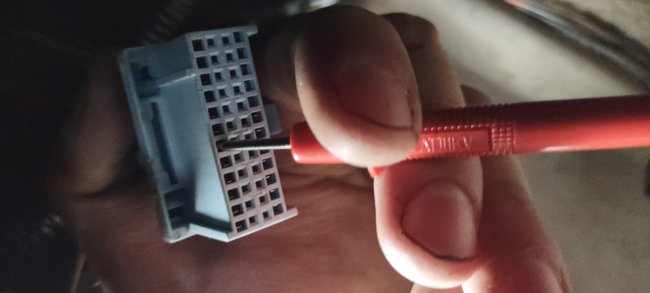

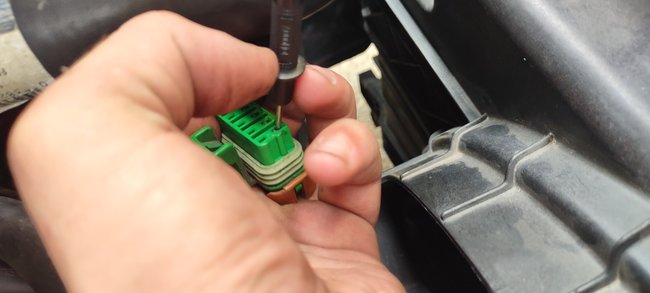

I just had this same issue on my car, check the continuity of the wire going from the b7 socket of the j2 connecter on the PCM to the E socket of the ICM connector. If the wire has continuity, then I believe that leaves only the PCM as the possible faulty part if you've already proven the ICM is good or is brand new and all the other components in the system ie. Crank sensor, ignition coils etc. If I'm wrong here please correct me. (note the j2 connector is the shorter light blue connector with exposed wires and the b7 pin is on the bottom row seventh from the left with the clip at 12 o clock) in my case the PCM is bad.
