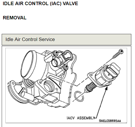

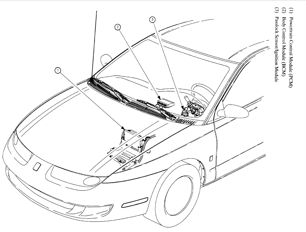

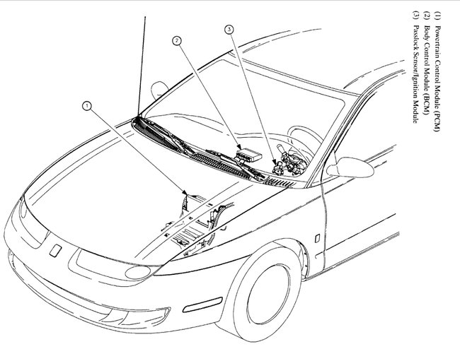

I have a 1997 Saturn SL1 very high idle. It will go by itself over second year idles at about 3,000 rpm's. I am wondering what should I do before going and just buying the air intake valve? Please help.
Jun 9, 2018 at 4:40 AM
CERTIFIED EXPERT
53,854 POSTS
Try the valve first and if that does not fix it I have seen the PCM cause this issue. Here are two guides and diagrams below to help you get the problem fixed.
Here is the locations for your car (below). Please run down these guides and diagrams and report back
