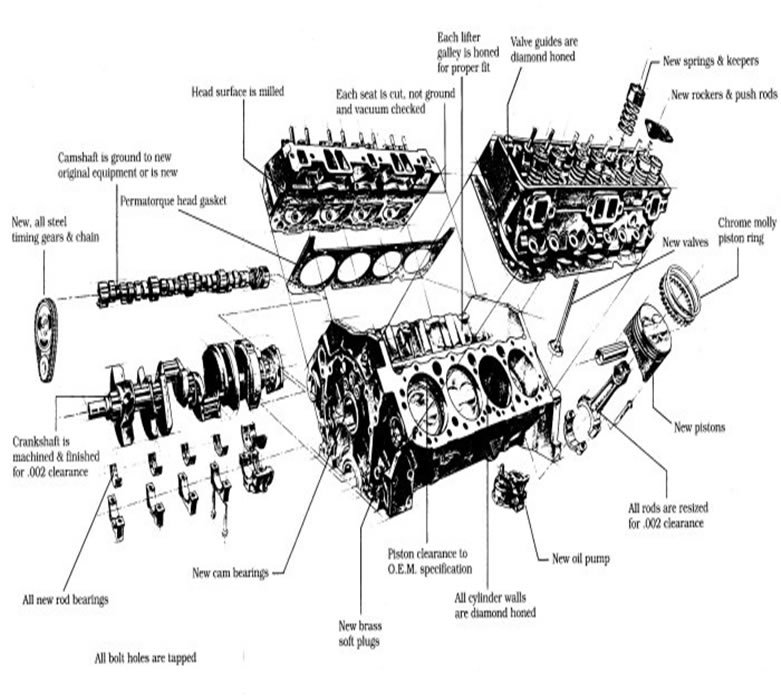

First off, how much experience do you have working on car? I ask because rebuilding the block is quite a job. You will have to pull the engine out, then take everything off the engine, then you will need to remove the Pistons, to replace the Piston Rings, you will need to have the Crank Shaft Jurnels check for size and uniformity and to get the right size Rod Bearings also the Crank Bearings then the Cam Bearings. And all has to be exact or it will be a waste of time.
If you don't have enough experience I would suggest you look into purchasing a reman engine.
Below is an exploded view of an engine Not Your specifically but give you an Idea of what is involved...
