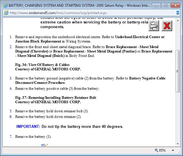

How do you remove the battery from the car? Do I have to remove the stabalizer bar?

You have to remove the bar and the fuse box. Reinstalling the fuse box was a chore.

Here you go.
Image (Click to enlarge)
