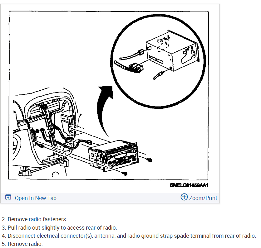

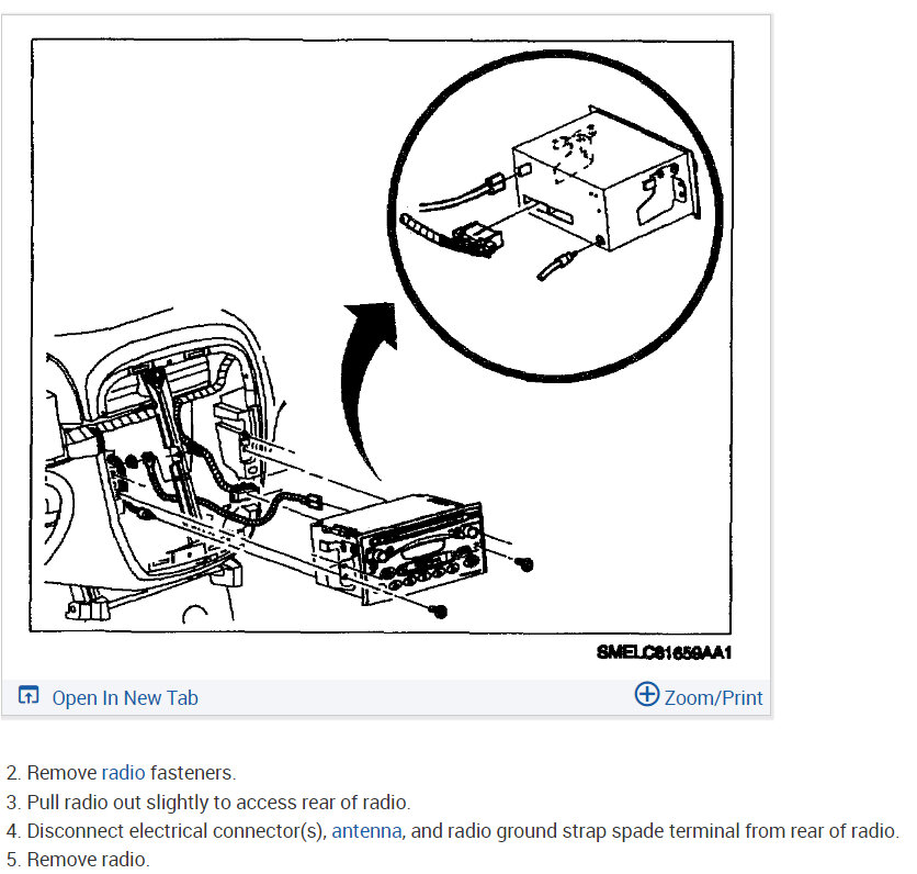

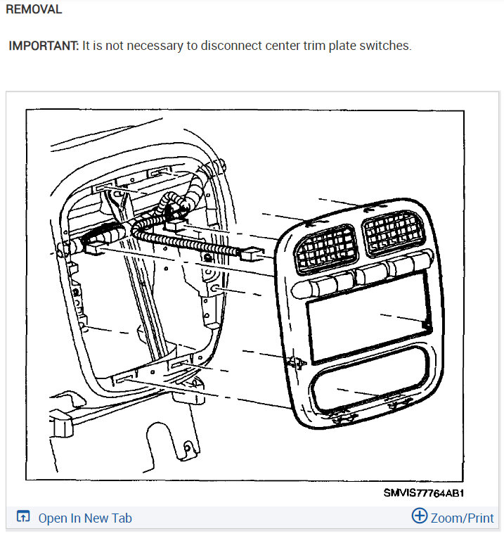

If the fuse is good the radio head unit has gone bad here is how to change it out. Check out the images (below). Let us know if you need anything else.
