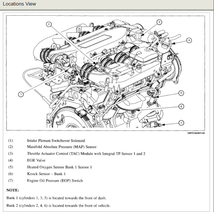

When changing an oxygen sensor, which is bank 1 and which is bank 2
Sep 5, 2009 at 4:16 PM
BLUELIGHTNIN6
  • 16,542 POSTS

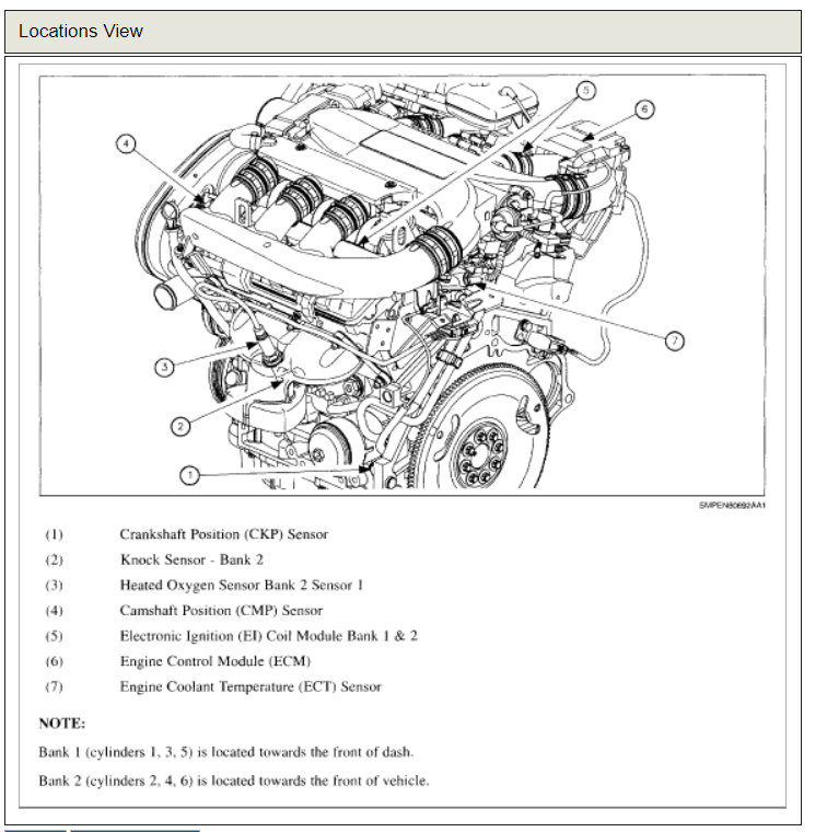

Here is a guide to show you what you are in for when doing the job. A v6 engine on a l300 faces the passenger side of the car or the right front tire . the driver side of the engine faces the rear of the engine or the left front tire
https://www.2carpros.com/articles/how-to-replace-an-oxygen-sensor
Here are the sensor locations
