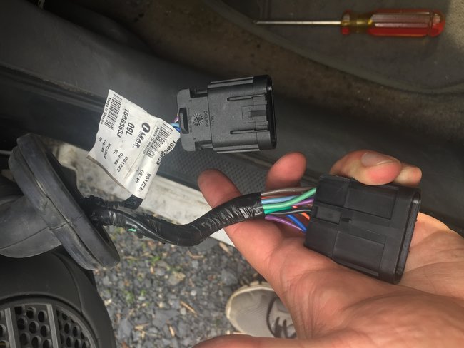

If u can open and close the door and make the windows work and not work from ur drivers switch I would suspect the wires in ur drivers side wire boot the goes from ur drivers door to the body of the car I have seen them
break inside the wires insulation on the LS model saturns from opening and closing the drivers door over time.grab that boot and wiggle the wires around and see if u can get that switch to work and not work by doing that.let me know what u find.

well i wigled the boot around for a few minutes with no luck. also slamming my car door doesnt seem to work anymore either. i was reading on another site of someone cutting open the boot so they can see the wires, but then they had to do something to the boot to make it have a water tight seal again, should i be thinking about doing that?

I would check all the wires in the door moving them around while holding one of the buttons to watch for the window starting to work.u might have to cut open the boot but let's not do that yet check the other wires in the door and we will talk about checking open the boot.let me know what u find?

KEVIN J. FURST
I have the same issue. The windows work after moving wires around or when door is partially open. I have been looking for the replacement wires for a few months now with no luck. Any suggestions?
