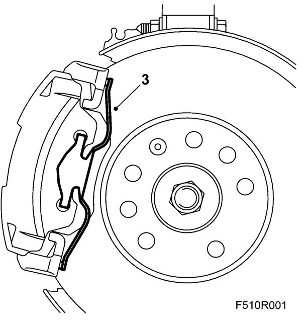

3. Remove the retaining spring from the brake caliper.
pic 2

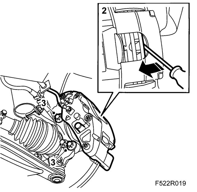

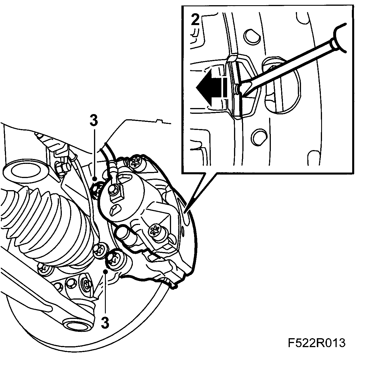

4. Press in the piston by prising with a screwdriver against the brake pad.

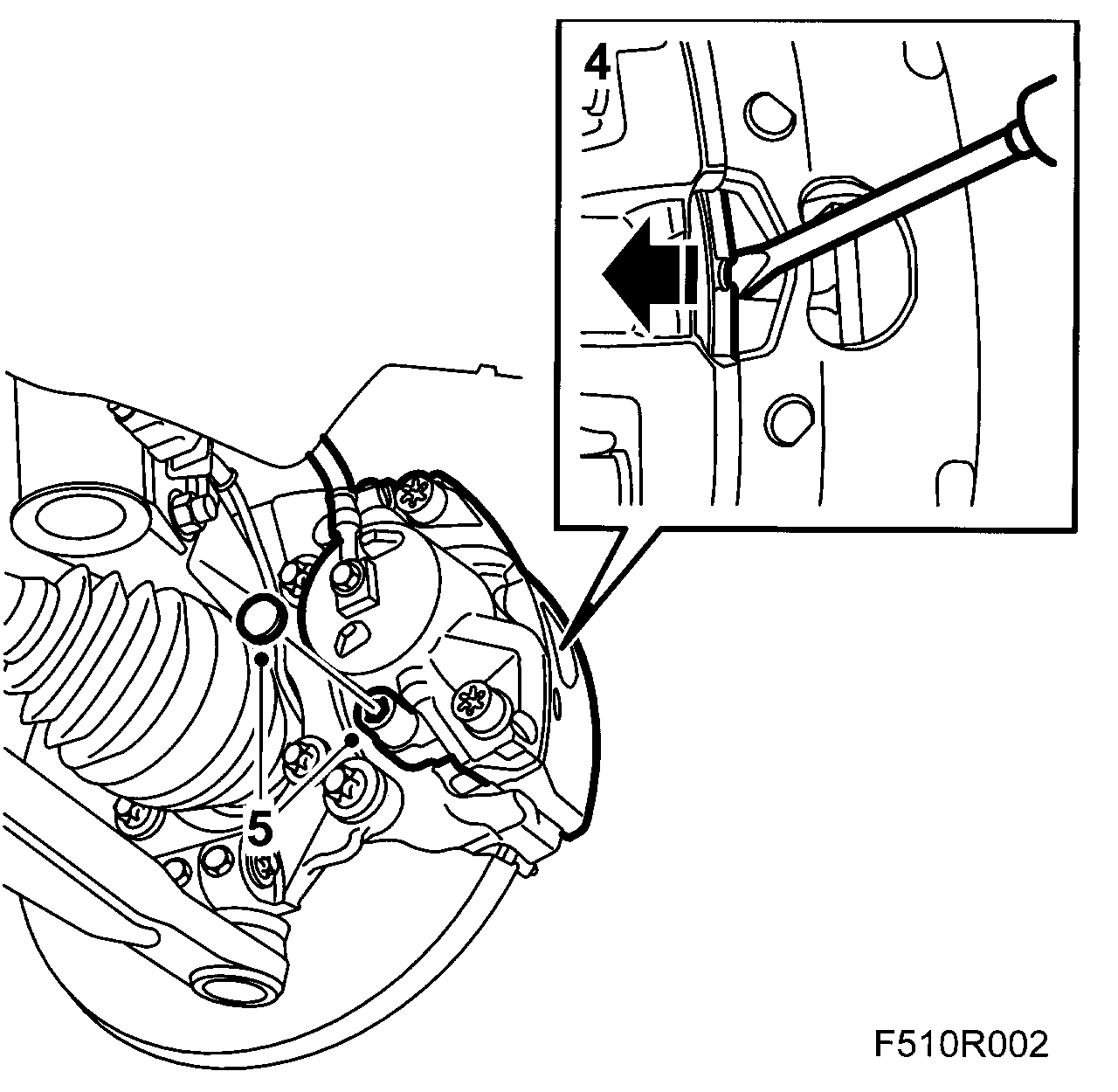

5. Remove the protective covers and guide pins.
Lift off the hydraulic body.

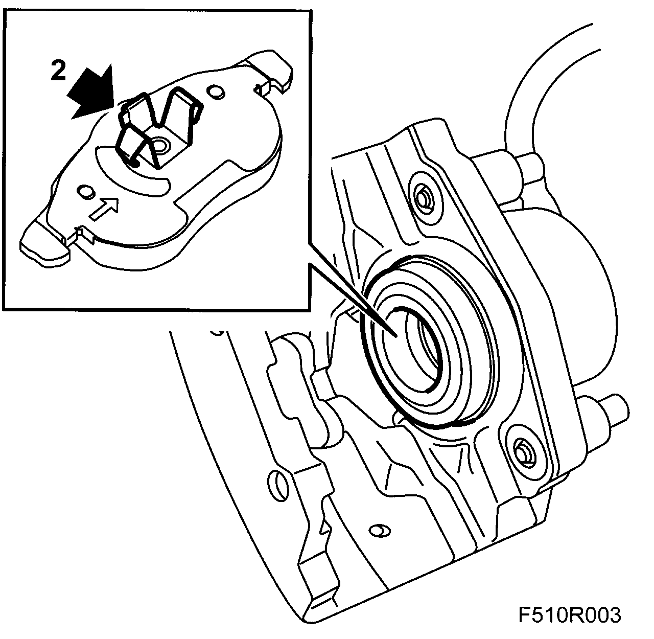

Note: The inner brake pad must be fitted so that the arrow points in the direction of rotation of the brake disc for forward travel.

3. Place the hydraulic body into the carrier.
Fit the guide pins.
Tightening torque 28 Nm (21 ft. lbs.)

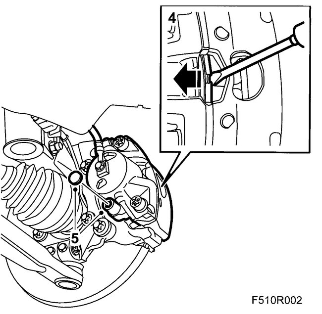

4. Fit the protective covers.
pic 5

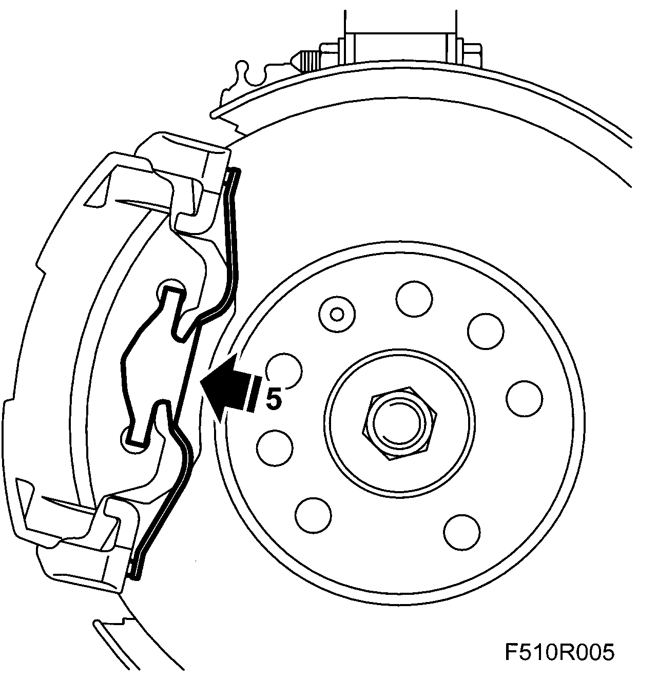

5. Fit the retaining spring to the brake caliper. Lay the outer contact surfaces against the bracket and push the centre of the clip.

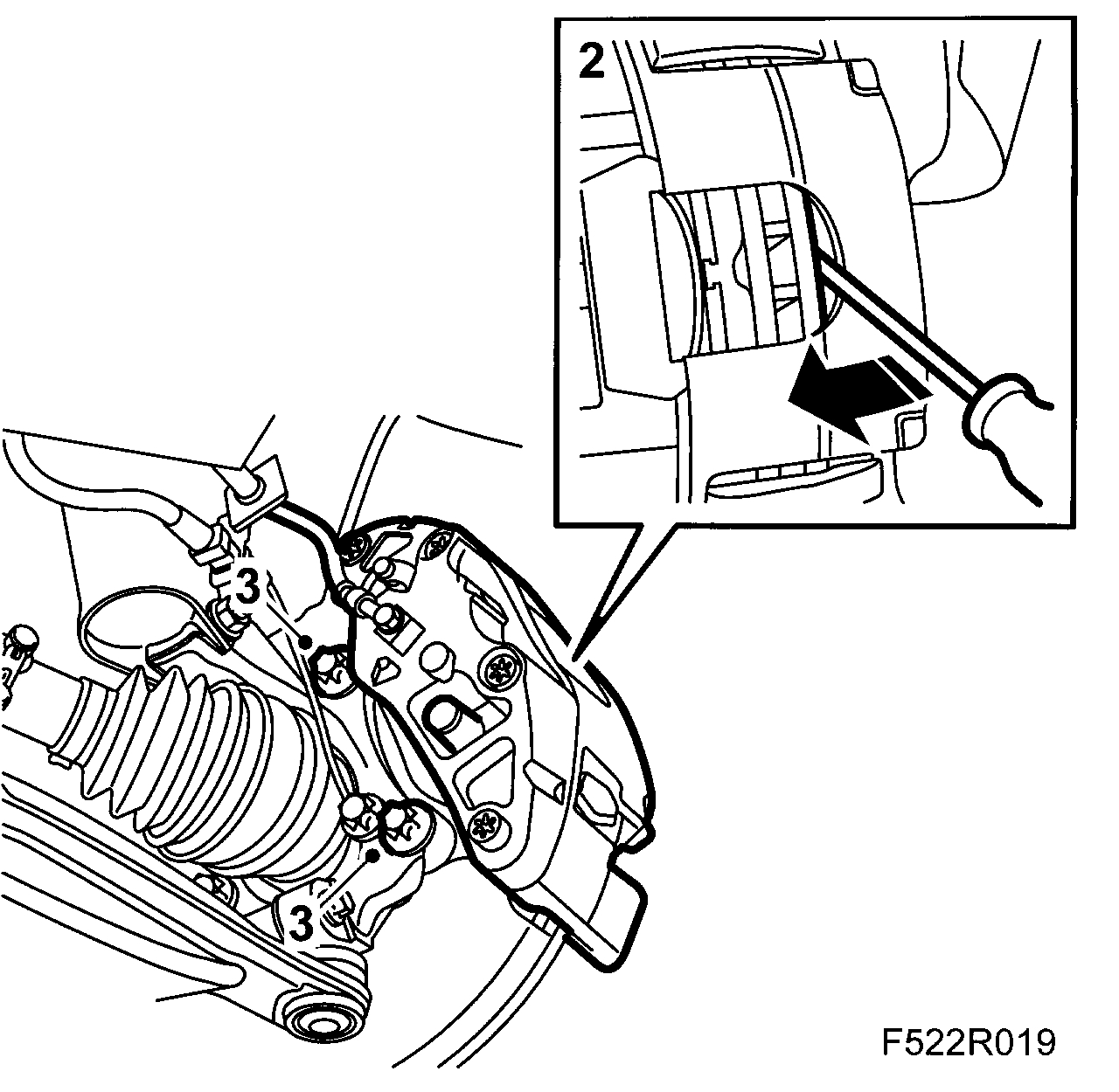

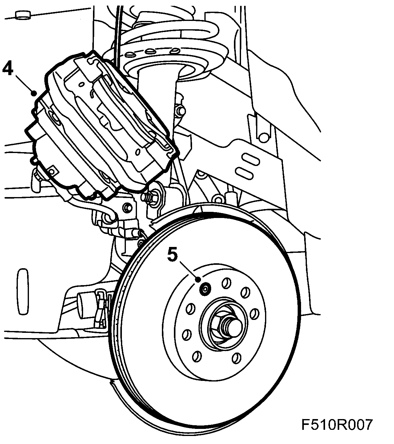

2. Press in the piston.
pic 6
- Level 1 and 2: Press in the brake pad by prising with a screwdriver.
pic 7
- Level 3: Prise between the brake disc and the brake caliper using a screwdriver.

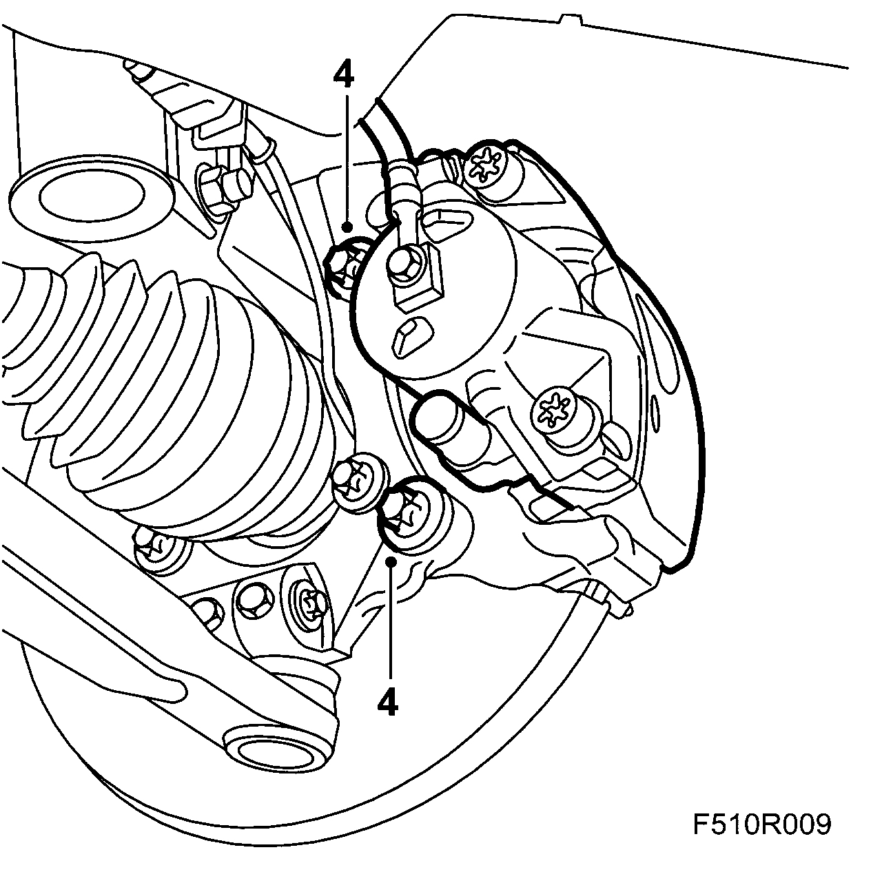

3. Remove the two brake caliper retaining bolts.
Note: Make sure the cable to the wheel sensor is not damaged.
pic 8
4. Suspend the brake caliper from the spring strut.

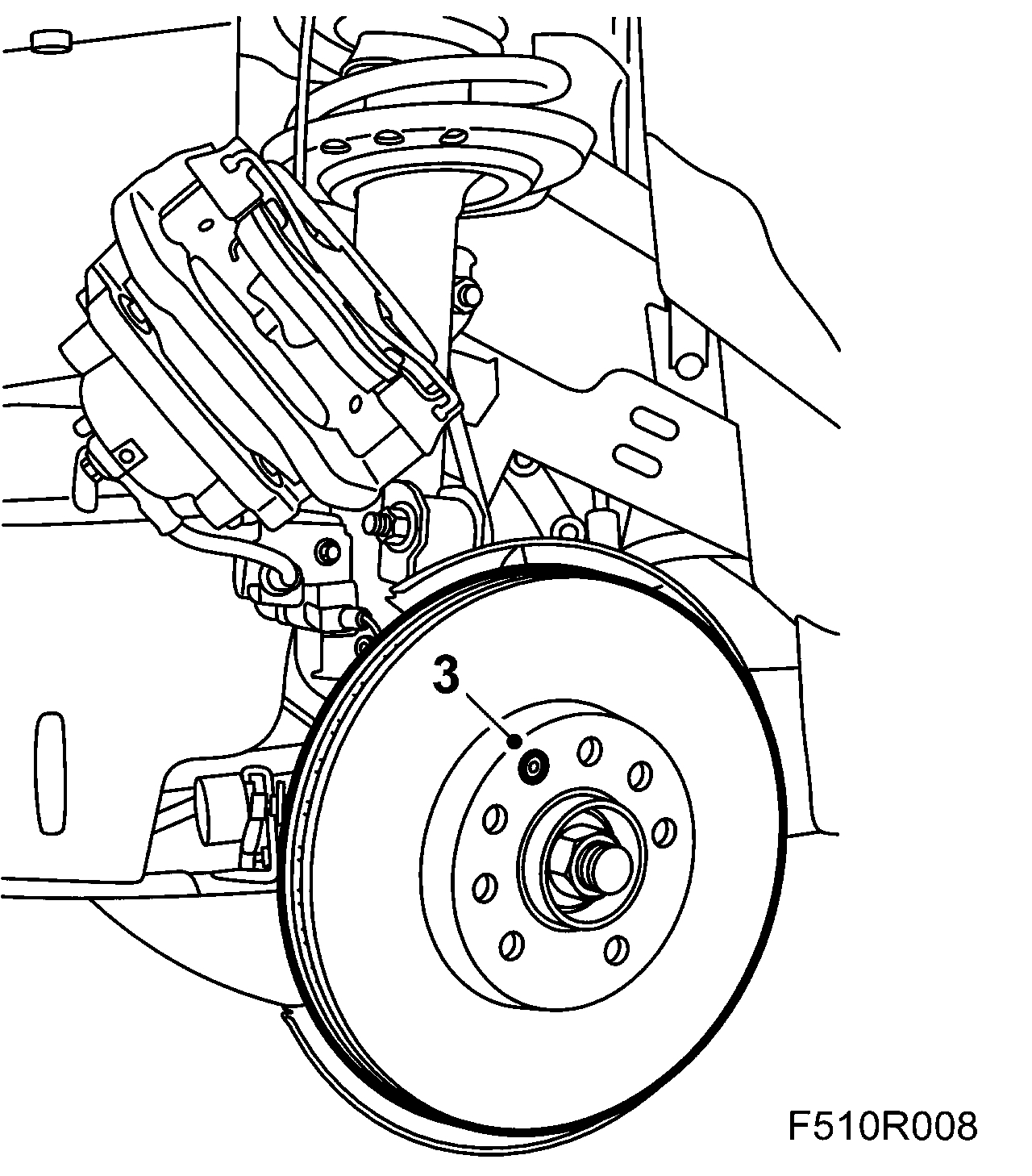

5. Remove the brake disc locking screw.
6. Lift off the brake disc.

3. Place the brake disc on the hub and screw in the brake disc locking screw.

4. Fit the brake caliper. Secure the bolts with 74 96 268 Thread locking adhesive.
Tightening torque: 210 Nm +30° (155 ft. lbs. +30°)
