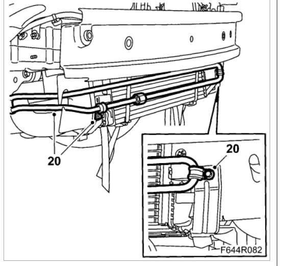

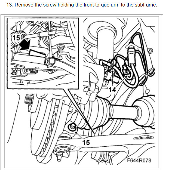

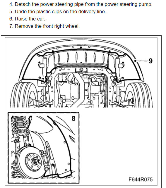

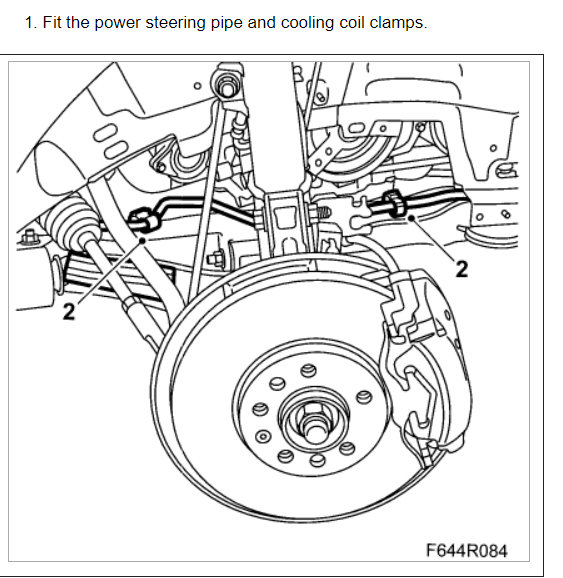

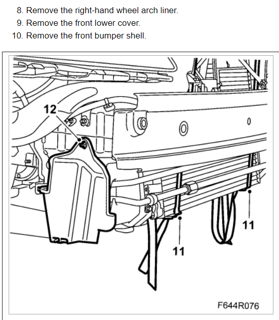

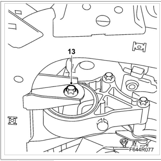

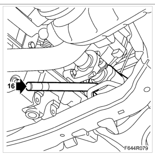

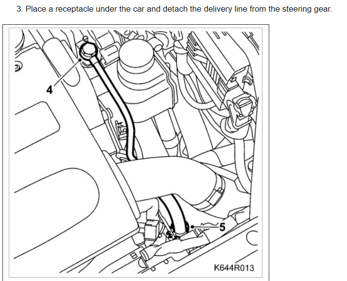

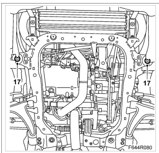

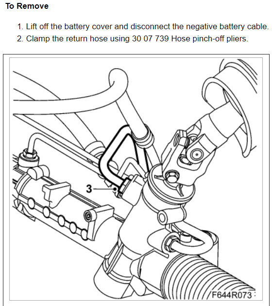

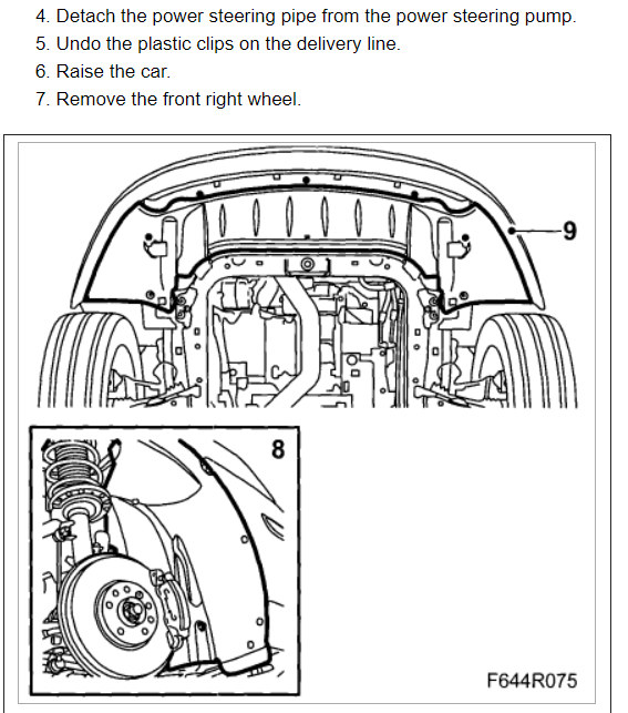

If you move the steering wheel without the engine running it will cause the fluid to come out of the cap BTW. I would check out the high side hose as well. Here is a video to help you see how to check the hose out.
https://youtu.be/BGBUv5r9fk0
Here is how it will be on your car (below)
Please let us know what you find.
