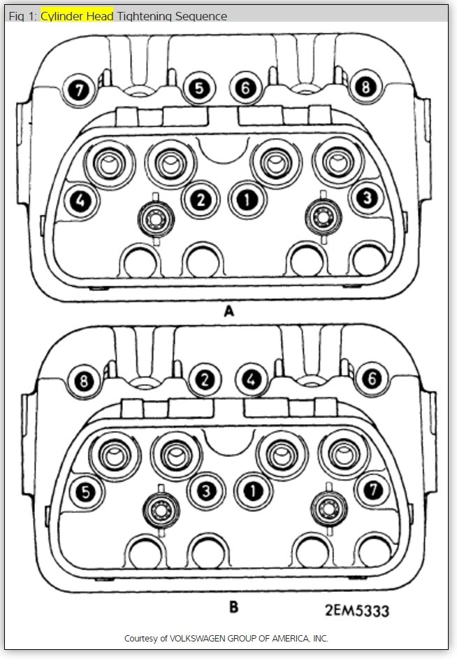

It sounds like the cylinder heads need to be tighten down. This is a common problem, remove the valve covers so you can get to all of the bolts
Here is a diagram for you tighten to 30 pounds
Let me know what you find out
Best, Ken Lavacot
