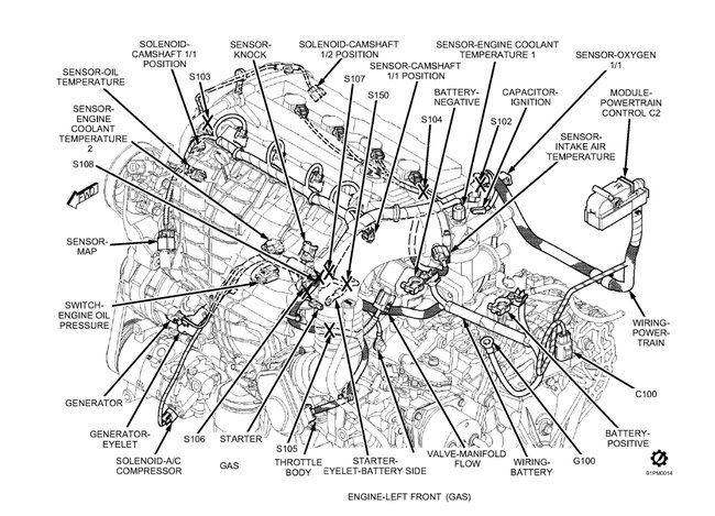

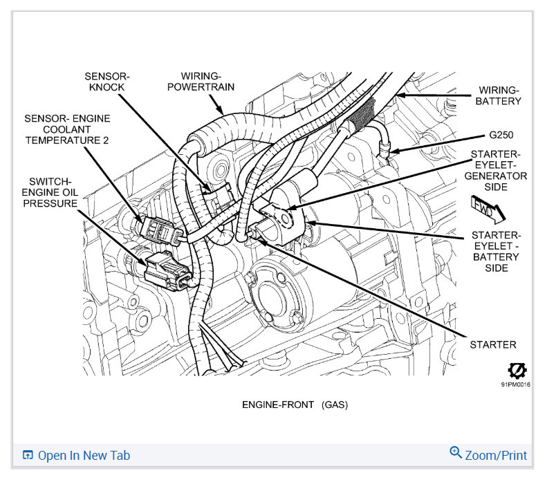

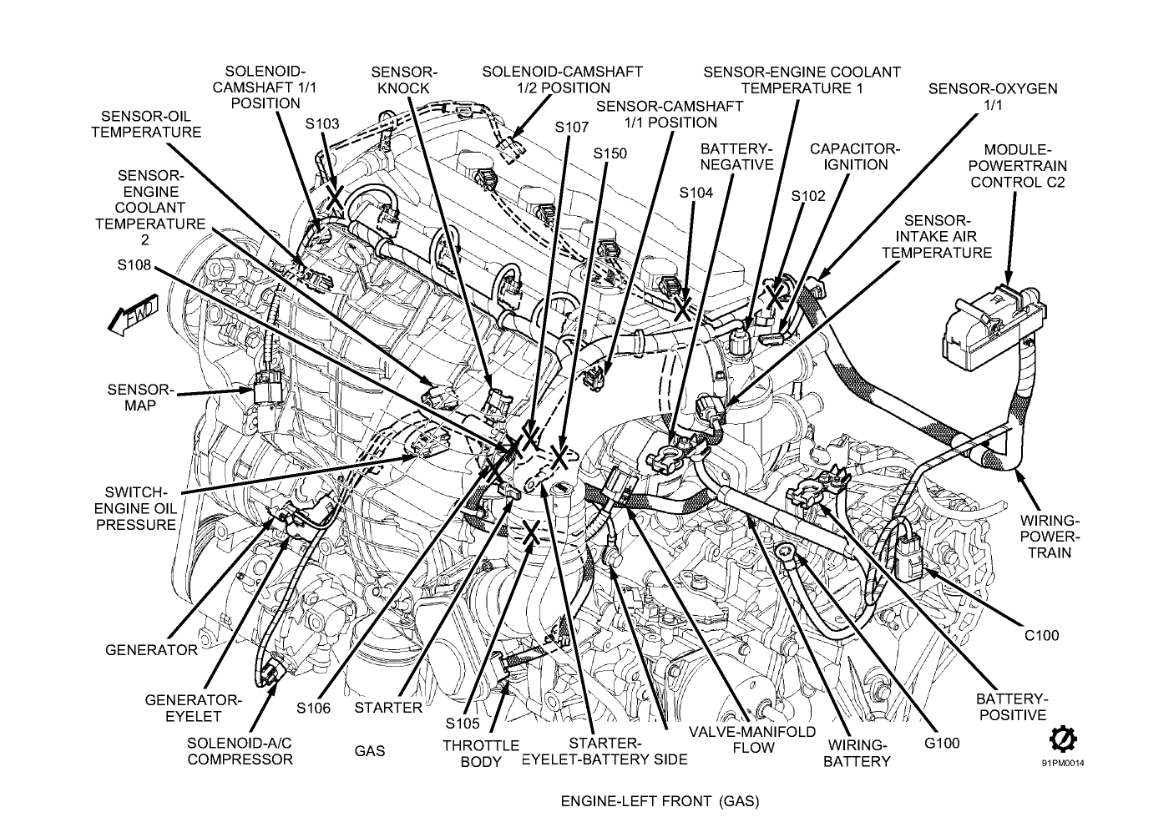

I have seen the engine coolant temperature reading be off when hot causing this issue. here is the location so you can check it out. There are 2 sensors.
Also this guide can help:
https://www.2carpros.com/articles/engine-vibration-at-idle
Can you please shoot a quick video with your phone so we can see what's going on? that would be great. You can upload it here with your response. Check out the diagrams (below). Please let us know what you find. We are interested to see what it is.

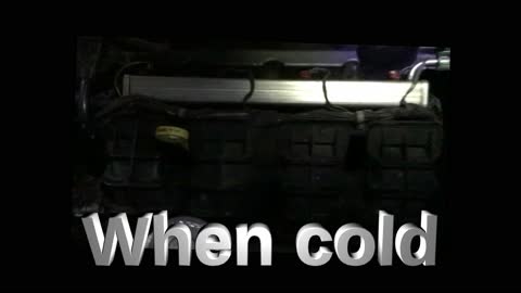

Here is a video when the car is cold and hot also the readings of the car in part of the video of me saying this is what happens when i turn the wheel or do the windows and sit what i mean by sit is it will out of the blue run really rough for a second like wanting to stall and then go back to running a little rough i changed only one coolant sensor so far and nothing i'm hoping the readings in the video will tell you something about whats going on the sound in the back ground is a fan in my underground parking lot it don't blow any smoke at all from the tail pipe i picked apart the inside looking t all the wires and all look good i really cant find the problem i'm lost.
