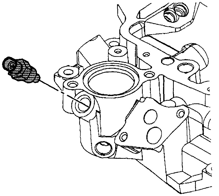

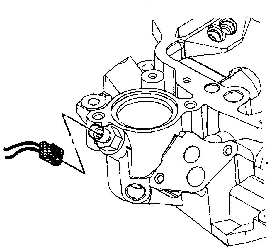

Here are the directions for replacing the sensor if you find it's bad. The two attached pictures correlate with the directions.
_________________________________________________
ENGINE COOLANT TEMPERATURE (ECT) SENSOR
Engine Coolant Temperature (ECT) Sensor Electrical Connector
pic 1
pic 2
CAUTION: Use care when handling the coolant sensor. Damage to the coolant sensor will affect the operation of the fuel control system.
REMOVAL PROCEDURE
1. Relieve the coolant pressure.
2. Disconnect the negative battery cable.
3. Drain the cooling system below the level of the sensor.
4. Disconnect the electrical connector releasing locking tab.
5. Remove the coolant sensor from engine.
INSTALLATION PROCEDURE
1. Coat the threads (only) with sealer P/N 9985253 or equivalent.
Tighten
^ Tighten the sensor to 13 N.m (10 lb. ft.).
2. Install the coolant sensor in the engine.
3. Connect the electrical connector.
4. Refill the cooling system.
5. Connect the negative battery cable.

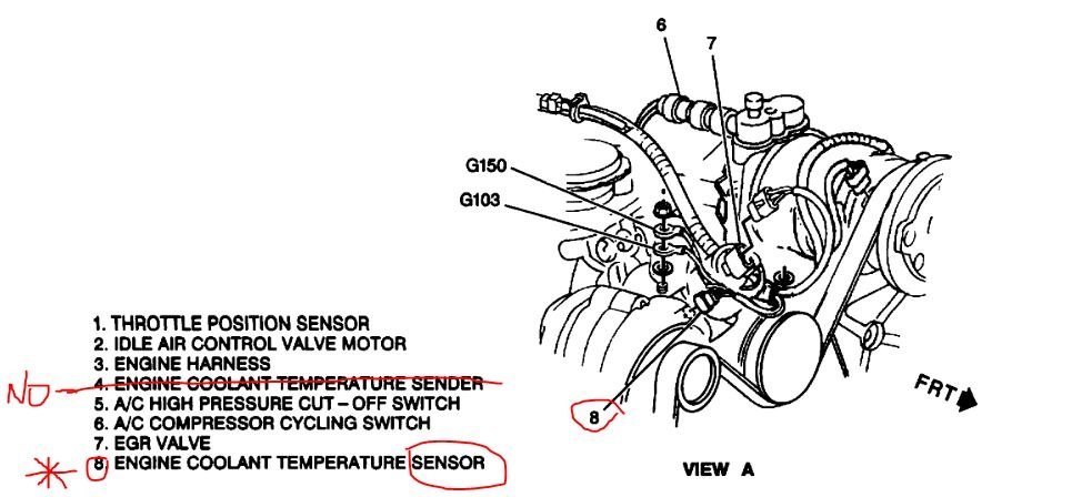

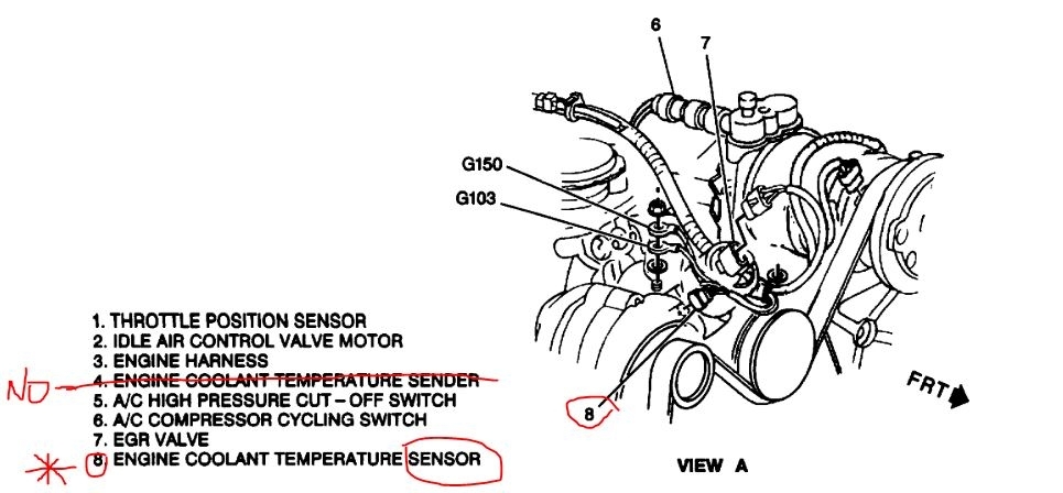

If you look at pic 3, I circled the sensor and location. Don't get this confused with the sender.
Let me know if any of this helps or if you have other questions. Honestly, my gut is telling me to check the sensor first, but that's your call.
