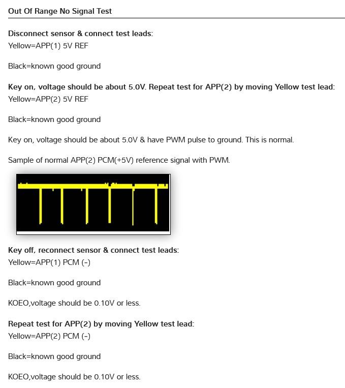

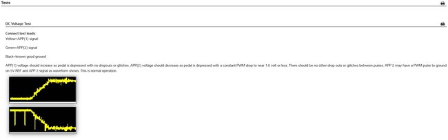

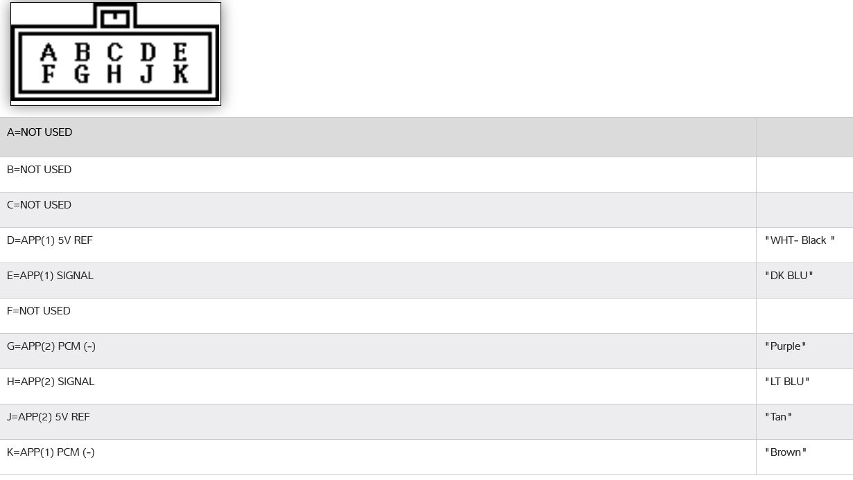

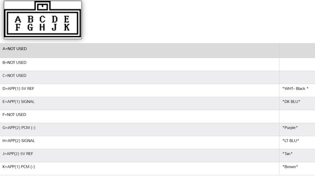

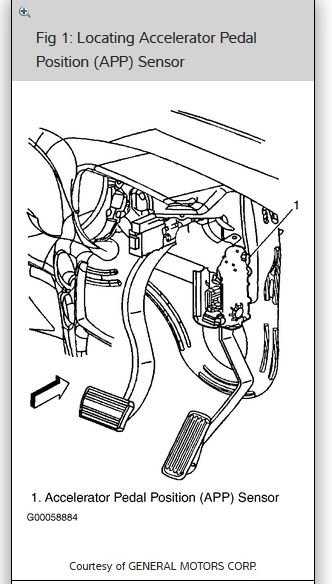

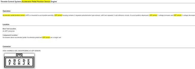

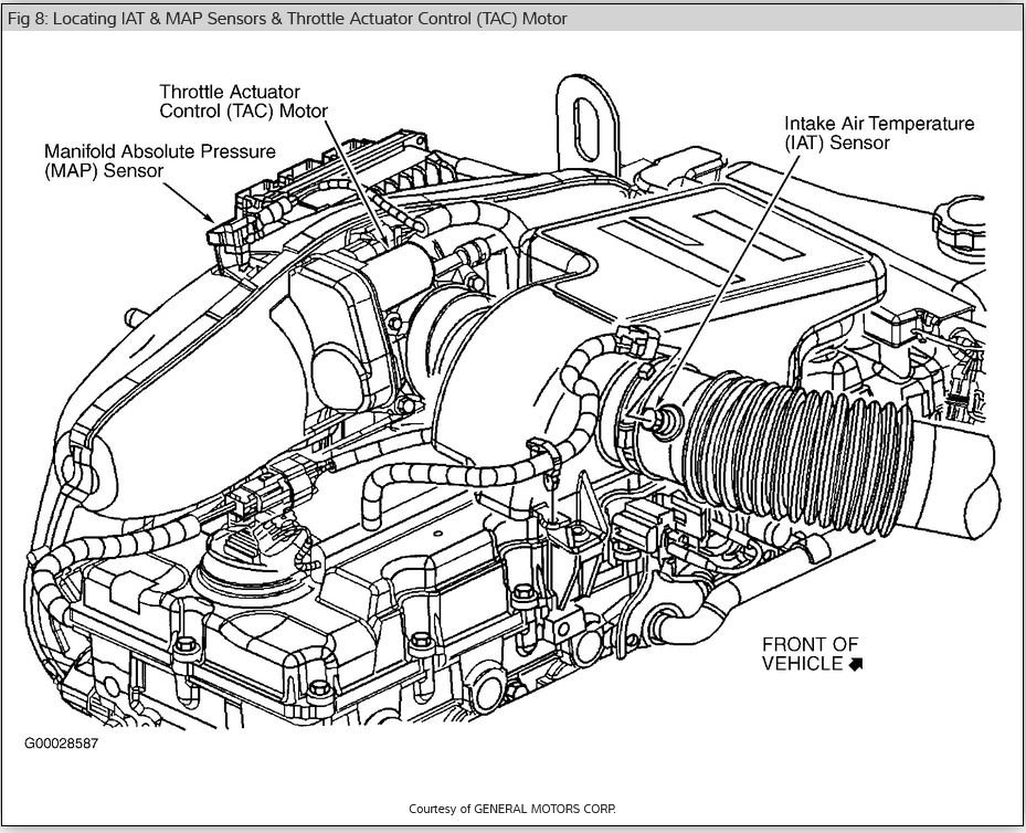

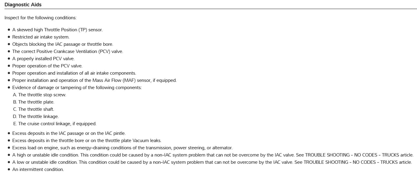

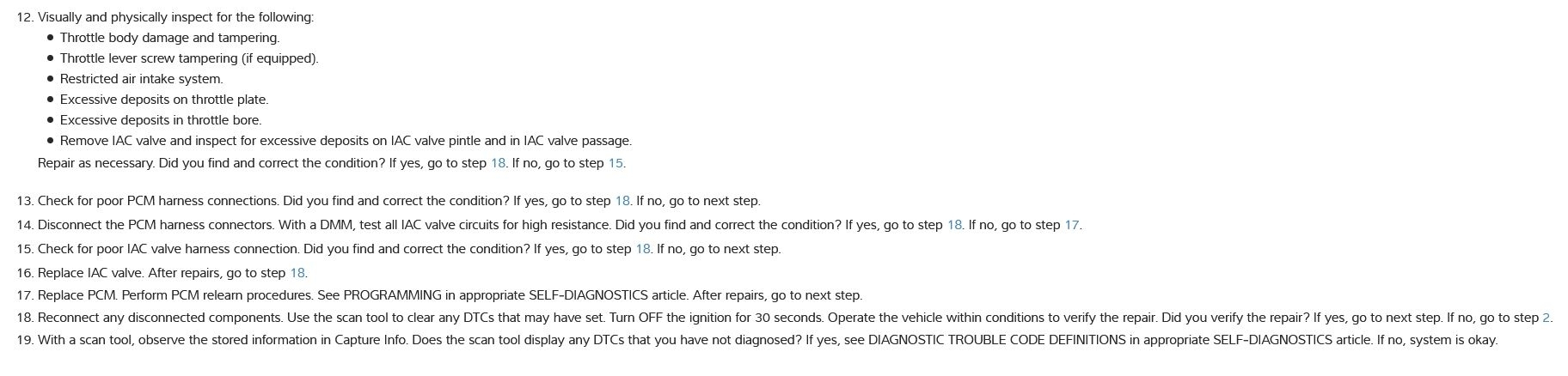

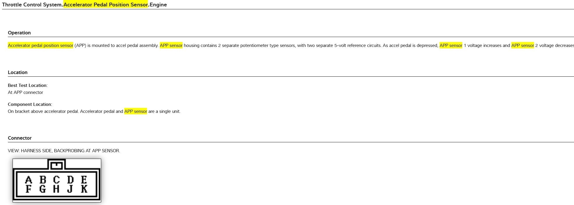

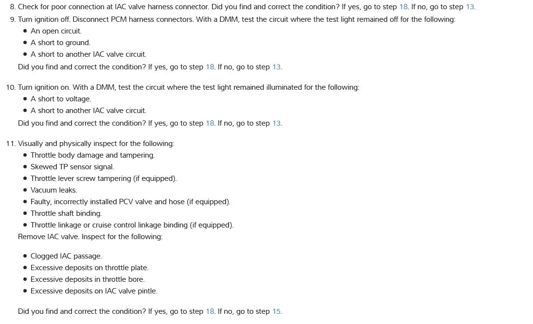

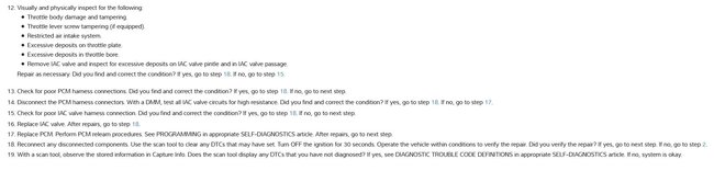

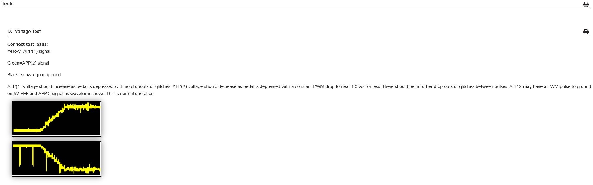

P1515 causes:
Bad connection at the Throttle Actuator Control (TAC) module
Bad TAC module
Bad Throttle Pedal Position (TPP) or Throttle Position (TPS) sensors
Binding or bent throttle plate-failed throttle body
You will find the test procedures and locations below.
There is no test listed for the TPS so if all checks well with the others just replace the TPS.
