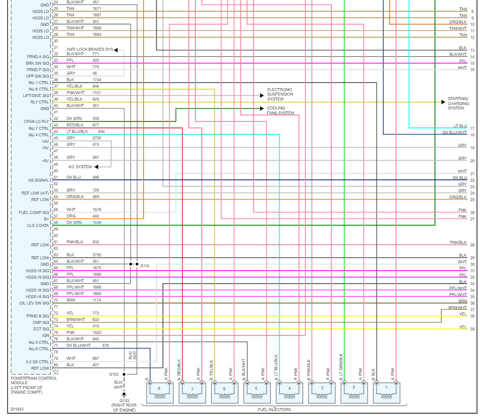

When i first crank it up after sitting overnight it runs good and when it warms up it will not crank back up. i have texted the fuel pressure and it never drops below 55 PSI even when it shuts off and shows no check engine. When it first started it showed a code p0336. I have replaced crank shaft position sensor and the pigtail to it, and it still does the same thing.
Jul 3, 2023 at 8:13 PM

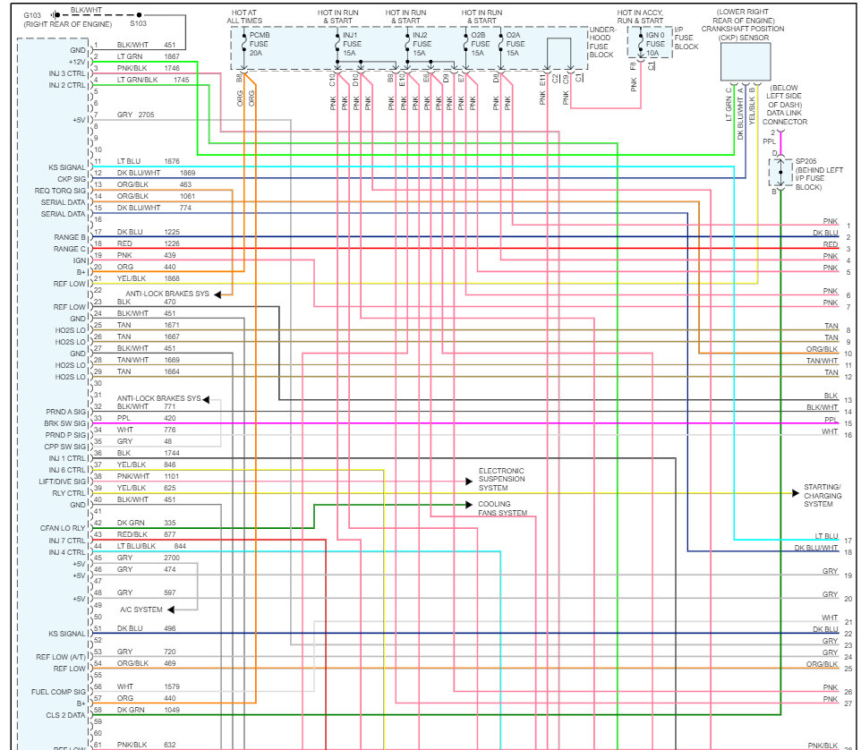

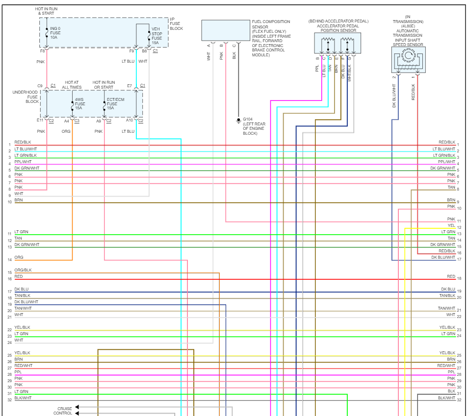

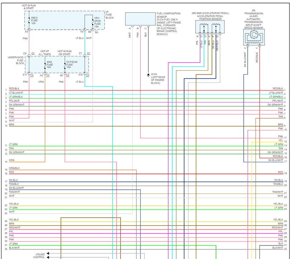

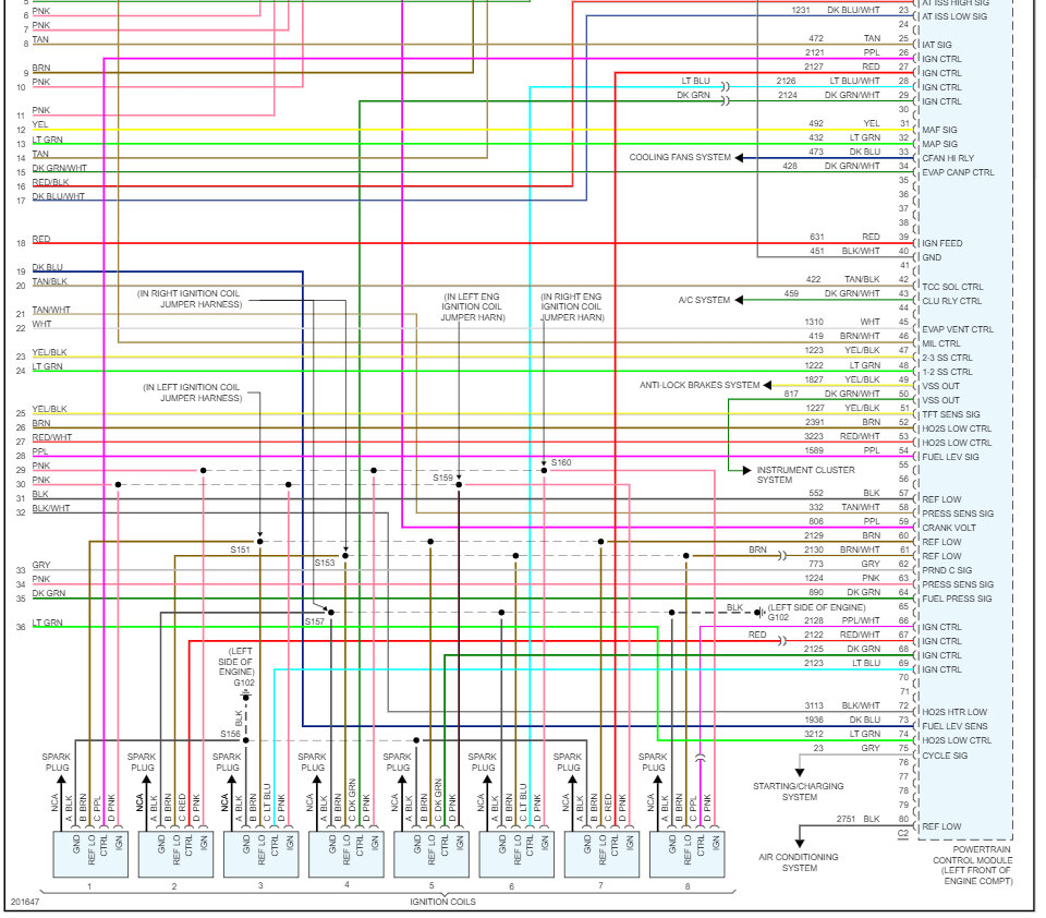

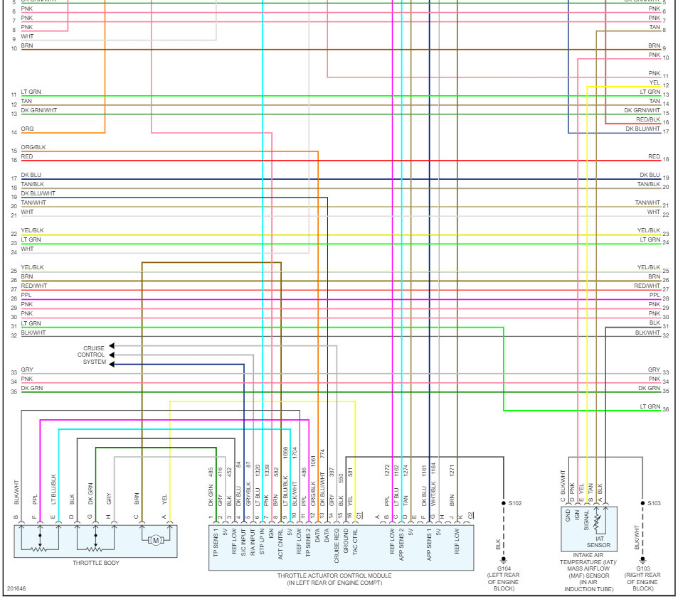

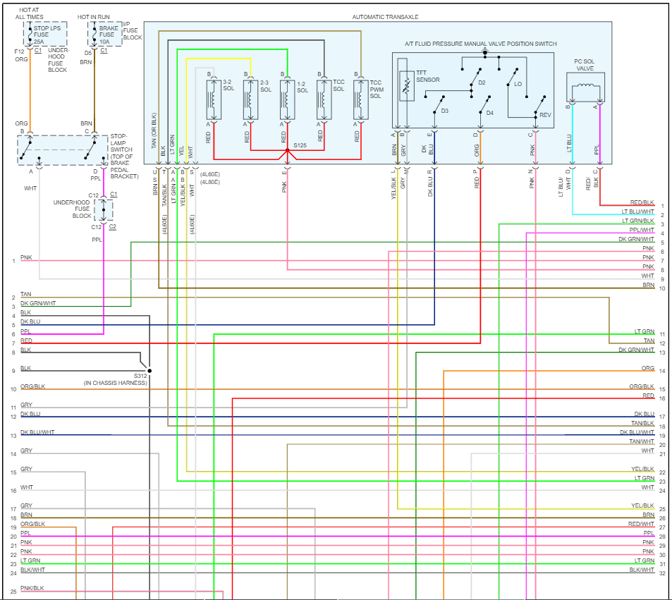

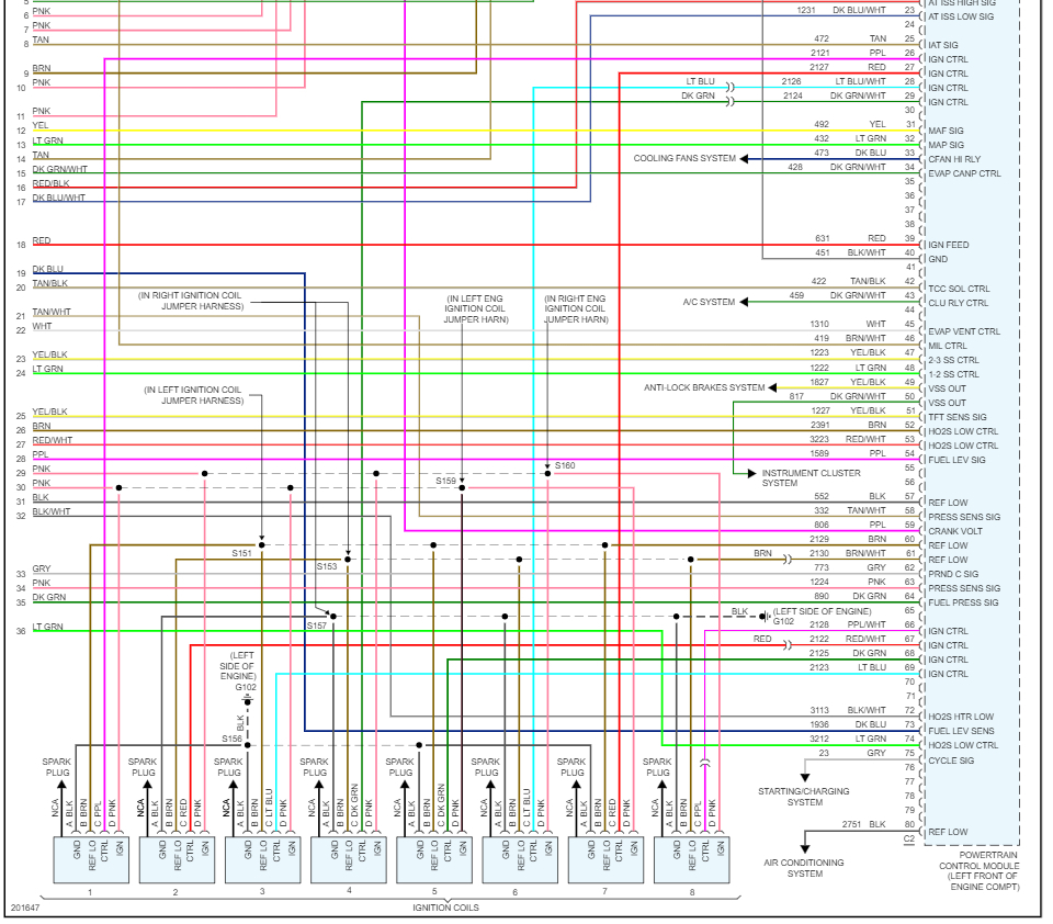

Error code P0336 in automotive diagnostics refers to a problem with the crankshaft position sensor circuit range/performance so there is an issue in the circuit to the PCM or the PCM is bad.

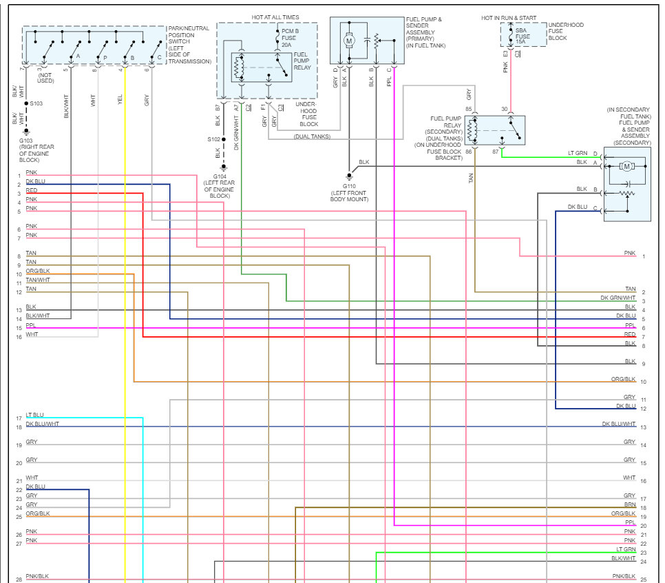

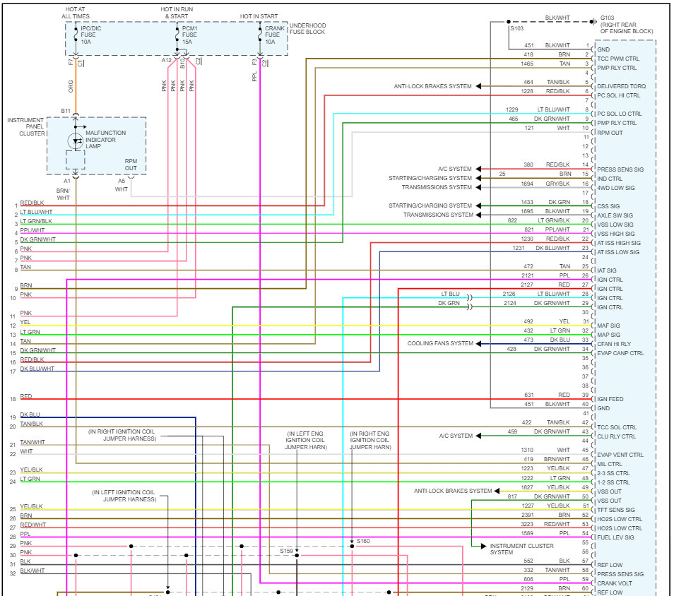

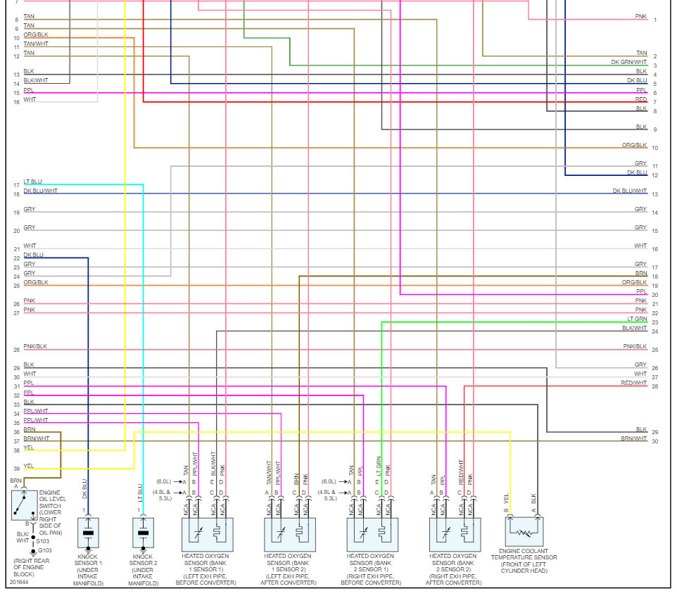

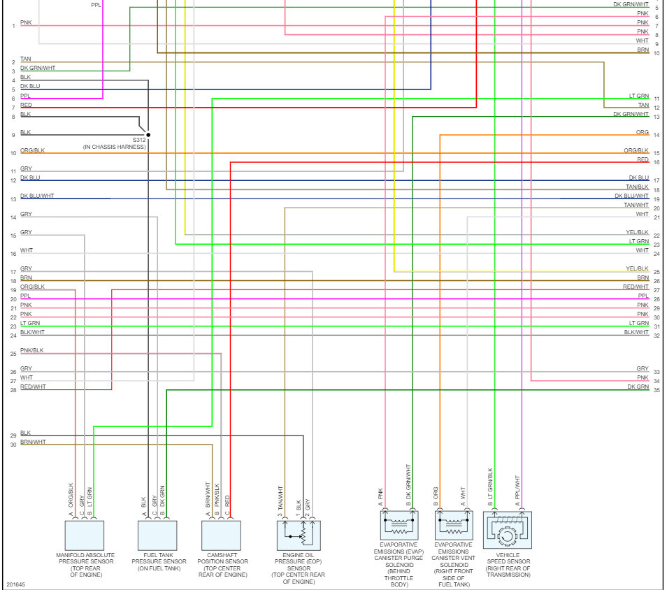

here is a guide to help and the PCM wiring diagrams so you can see which wires to test and how the system works:

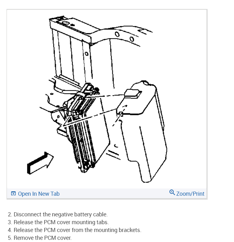

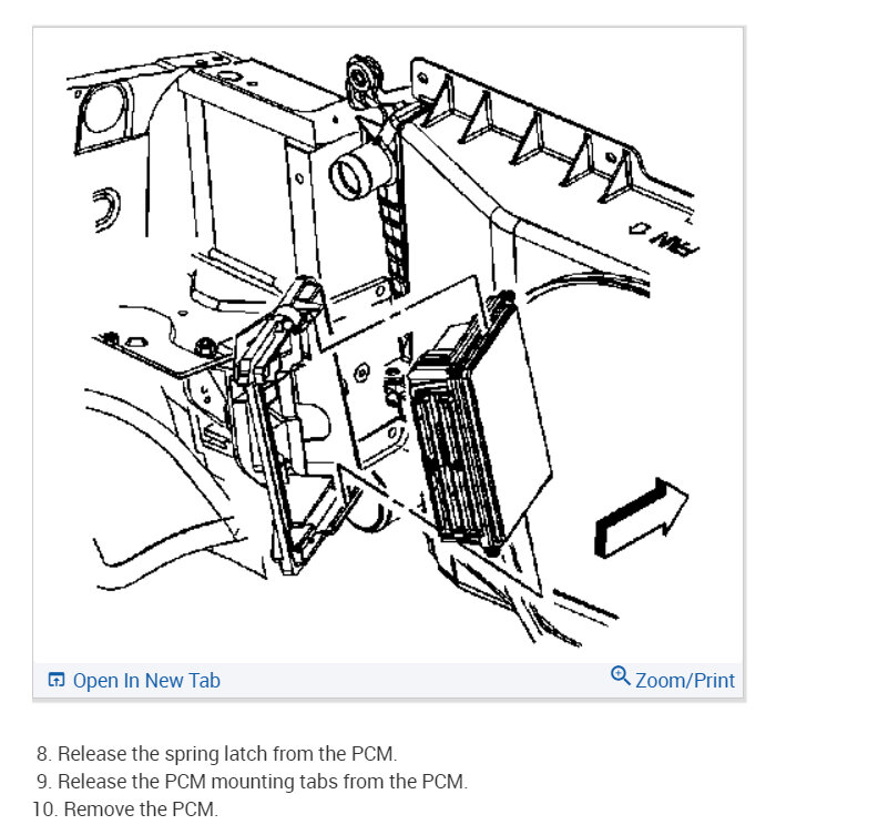

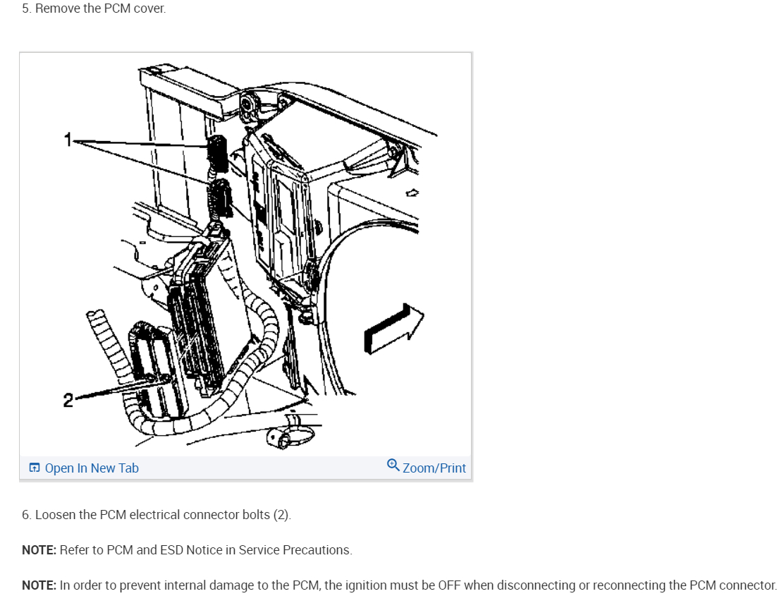

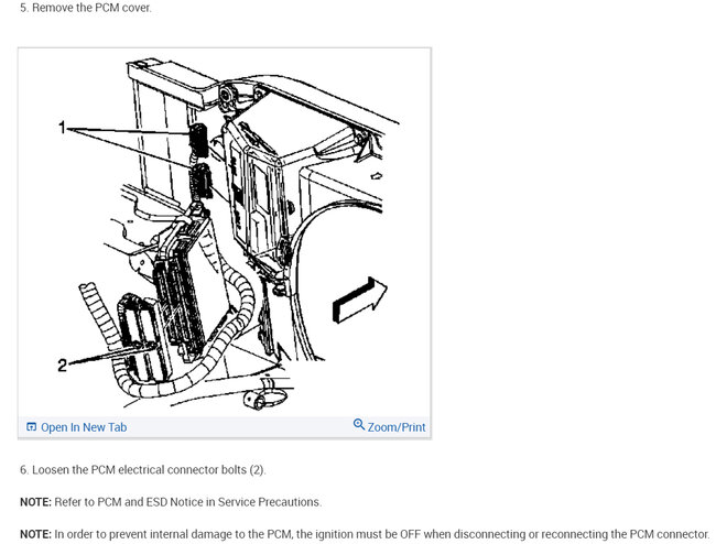

Here is how to change out the PCM as well, you can get a preprogrammed unit by searching Google or Ebay. Check out the images (below). Please let us know what happens.
Jul 4, 2023 at 12:32 PM
