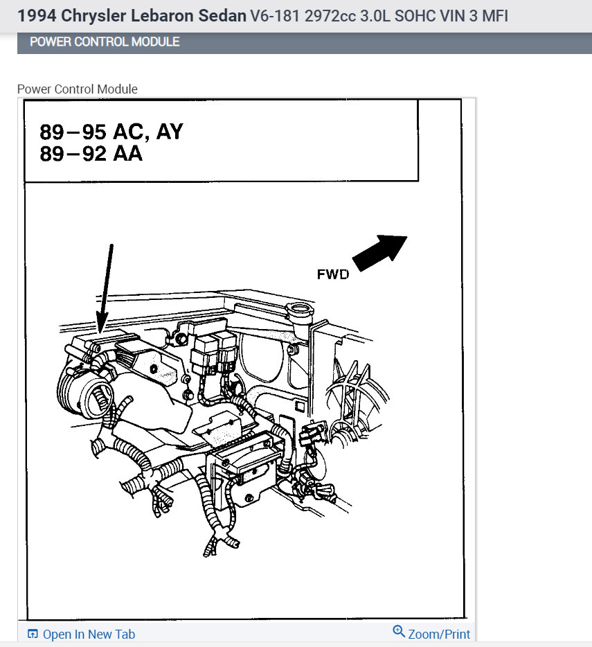

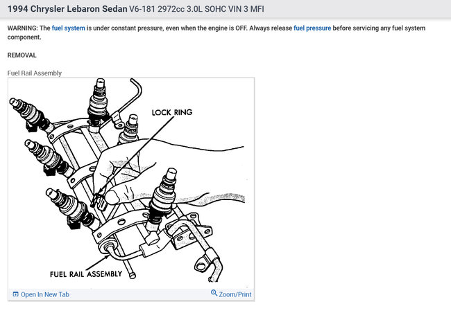

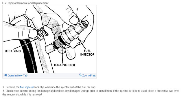

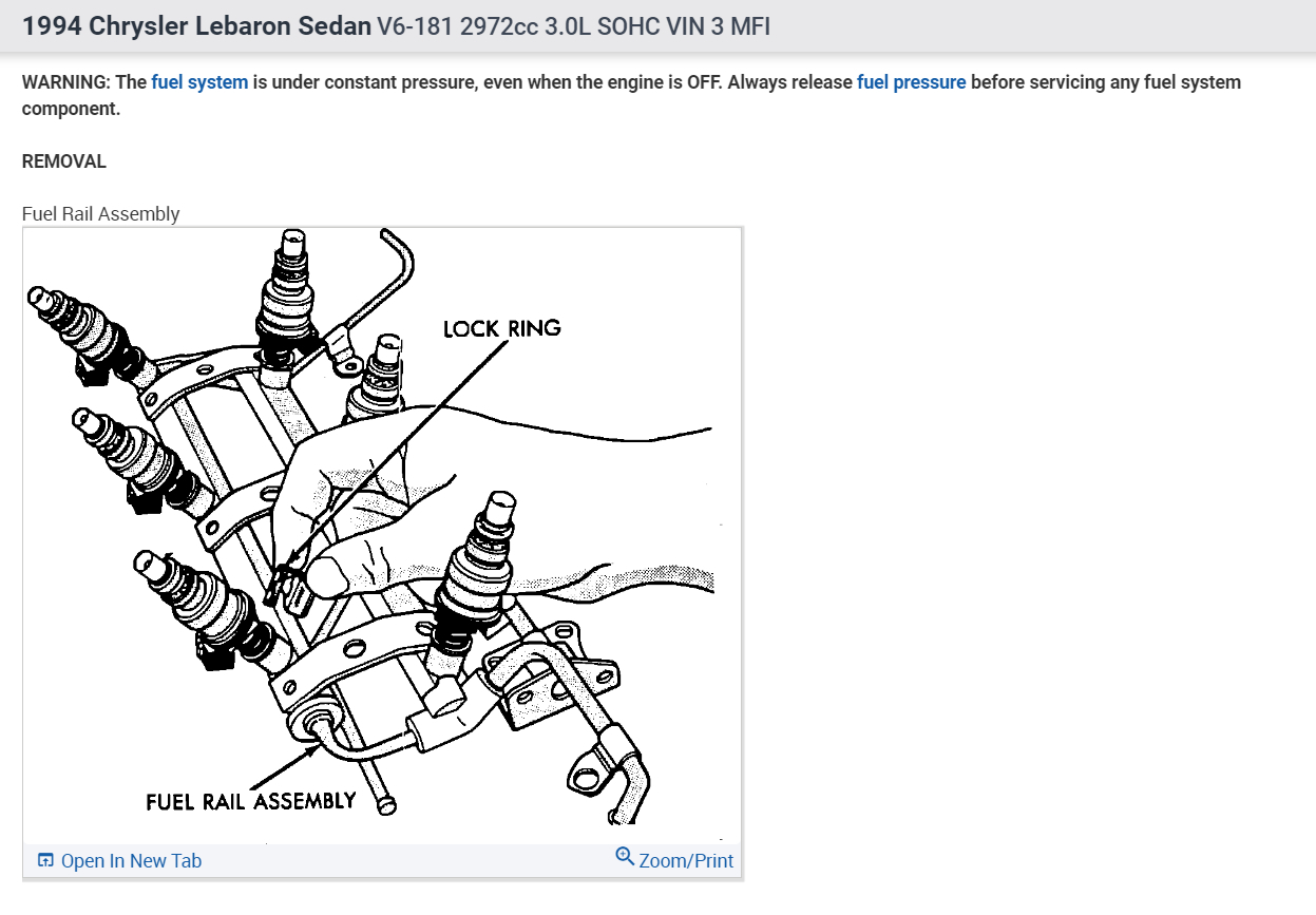

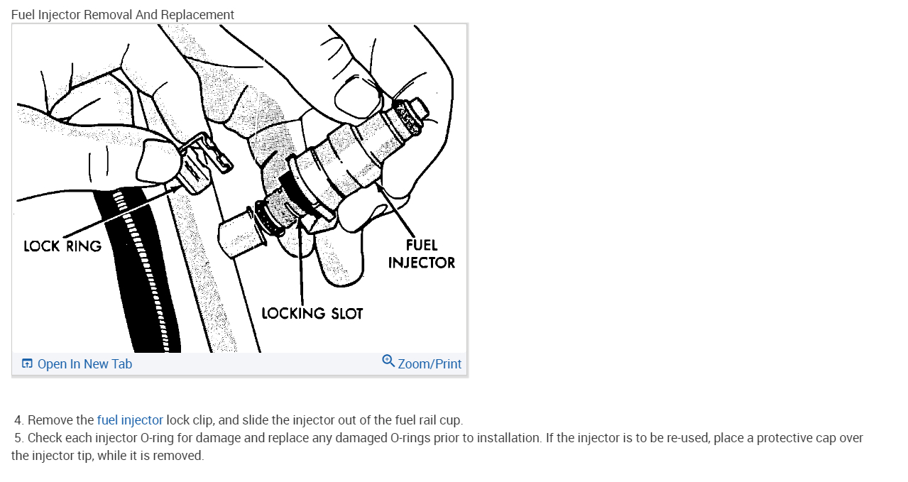

I have seen both the MAP sensor and the engine control unit cause this problem. It can also be a sticking fuel injector, I would start by removing all spark plugs and see if one looks different than the rest, if so, this will be the cylinder that is having a problem. If they look the same, I would replace the MAP sensor which is the engine controller. Check out the diagrams (below). Please let us know what happens.
