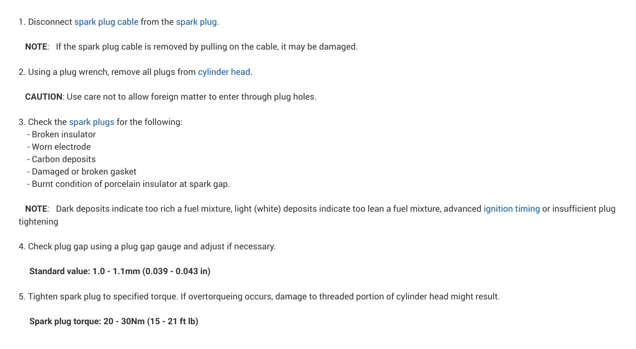

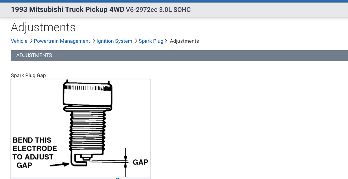

This could be a multitude of problems, so we are going to have to do a process of elimination here. So lets start with your vehicle's spark plugs. Can you please replace the spark plugs for us and get back to us with how everything turns out. In the diagrams down below I have included the instructions including the gap and torque specs in the diagrams down below for you. Happy Holidays.
