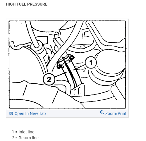

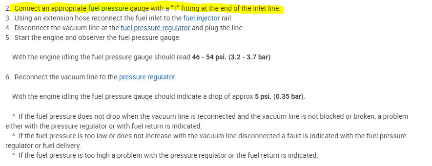

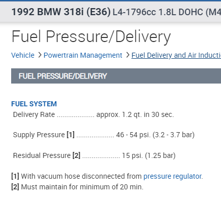

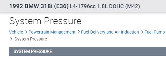

If you look below, I attached the manufacturer's fuel pressure specifications.

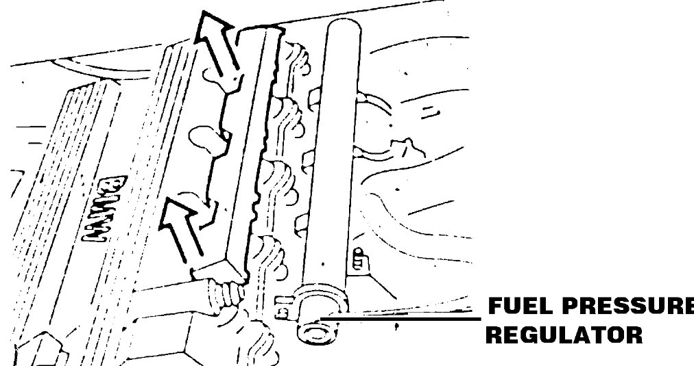

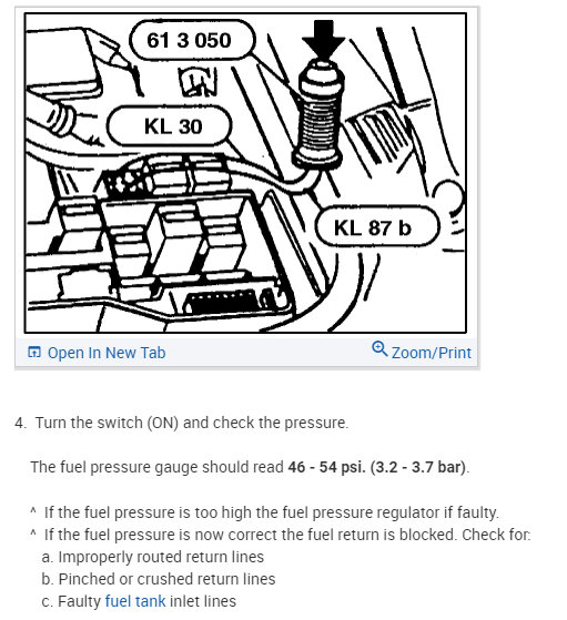

Also, pic 2 below shows the location of the fuel pressure regulator. There will be a vacuum hose attached to it. Inspect the vacuum hose and make sure it is in good condition, not leaking, and is attached at both ends.
Let me know what you find.
See pics below.

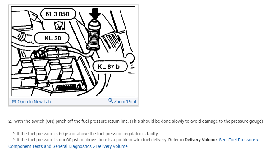

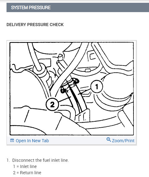

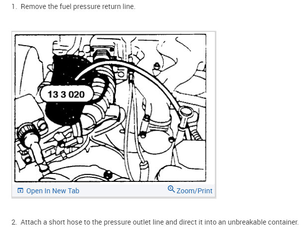

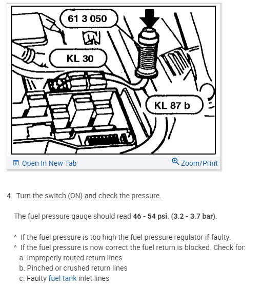

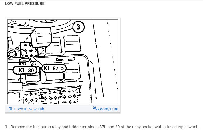

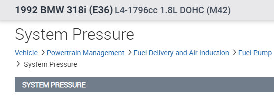

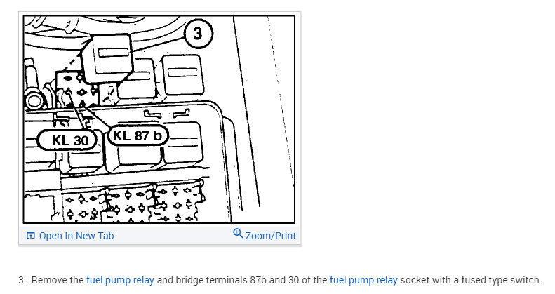

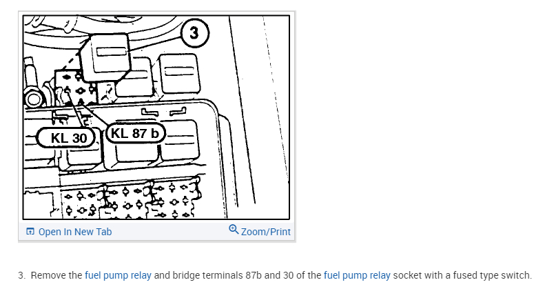

If you look below, I attached the directions for testing fuel pressure specific to this vehicle. Take a look through them and let me know if you have questions.
Because of the model year, there isn't a Schrader valve to connect to. Instead, you will place a T connector in the supply hose and the gauge will connect to that.
See pics below.
