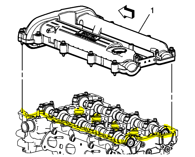

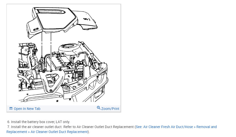

If you look at pic 1, it shows the top of the cylinder head with the valve cover removed. I highlighted where the gasket goes. Note that it goes around 4 circles. That is where the spark plugs go down into the head. That needs to be sealed or oil gets into the spark plug tube.

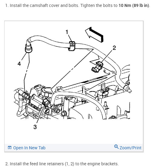

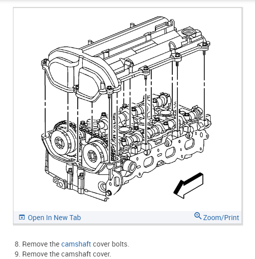

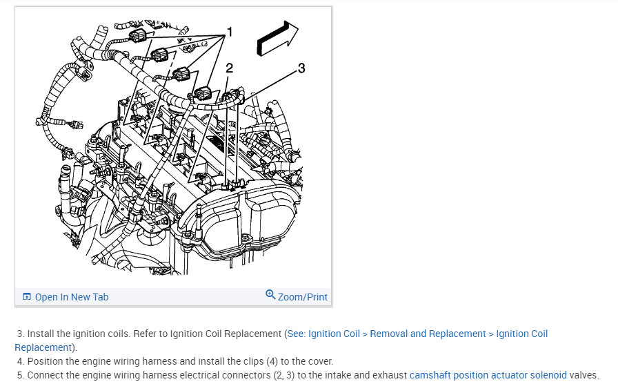

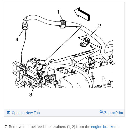

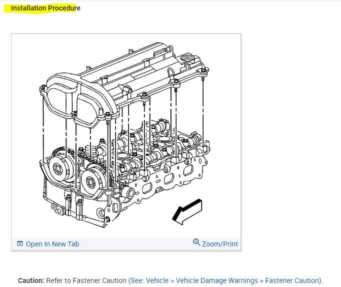

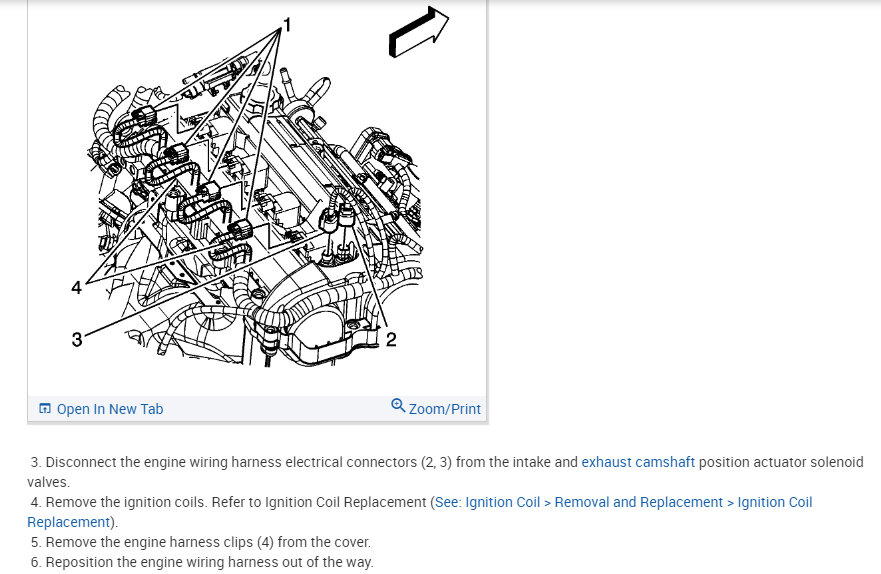

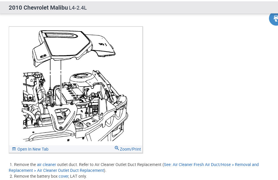

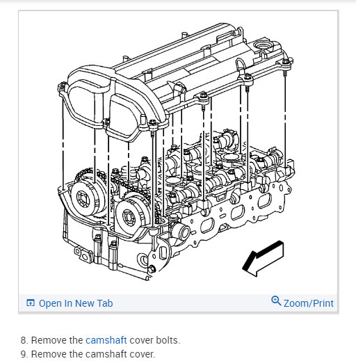

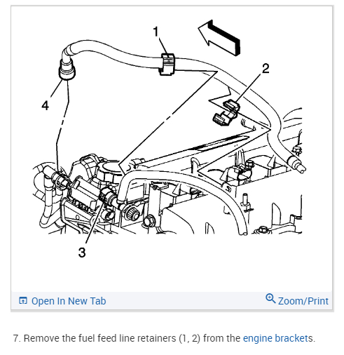

Starting with pic 2, I included the directions for removing and reinstalling the valve cover.

See pics below.
