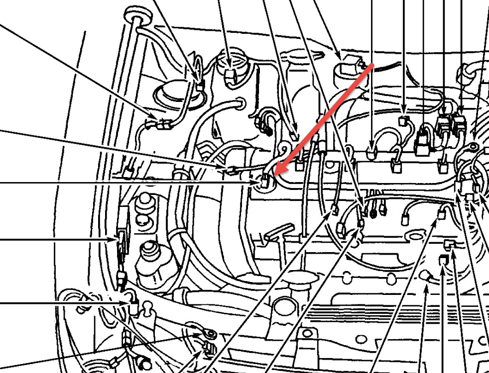

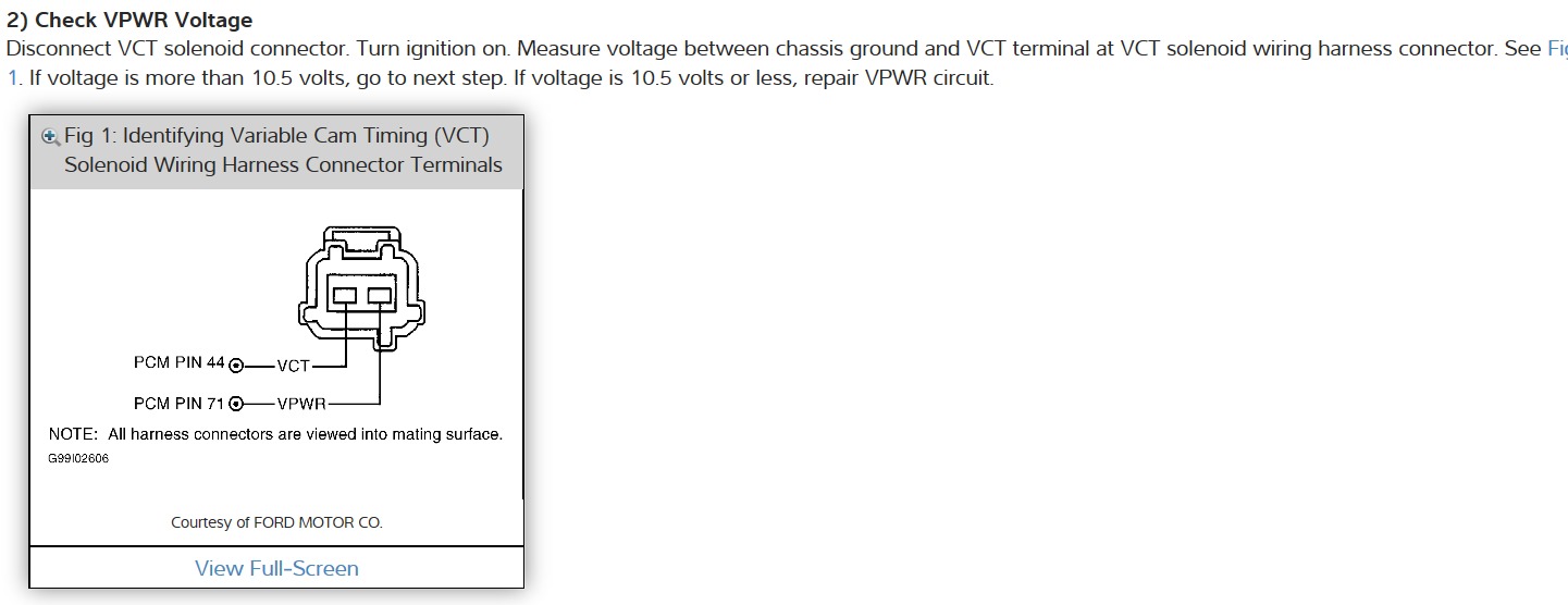

the code you have is for a variable cam timing solenoid it is either the solenoid is bad, an open or short in wiring or a bad pcm. see pics for one test and location. if test fails then have a pro look at it.

Voltages: VCT on connector to ground: 0.42V
VPWR to ground: 12.01V
Battery-across terminals: 12.08V
You say take it to a pro. It appears the problem is either wiring or ECM. Is this correct? I can handle wiring and/or changing out ECM.

it may be a connection not necessarily the wiring and if you put a ecm in a pro will have to install the security or you will have problems with it running.they are all vin specific
